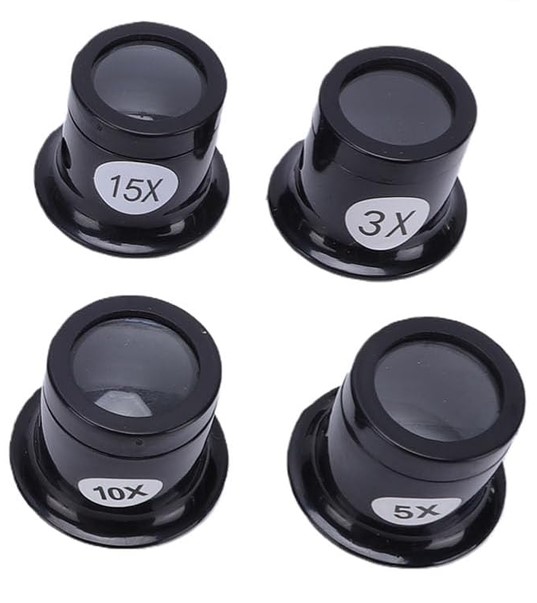

I use these cheap dollar store eye loops...
This is a Amazon set for $8, the ones I bought year ago were $1 each.
I have them all over the house in 4X magnification, in the garage for inspecting jets/spark plugs, and in every bathroom for removing splinters etc.
