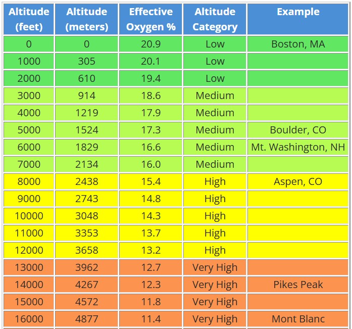

The higher or hotter the environment the "thinner" the air becomes - Factory jetting is a compromise for a specific market (North America, South Africa, Asia Pacific etc) so smaller than stock jets may be required at that altitude ?

EDIT: looks like the altitude effect would be negligent - have you replaced/rebuilt the choke plungers ?
