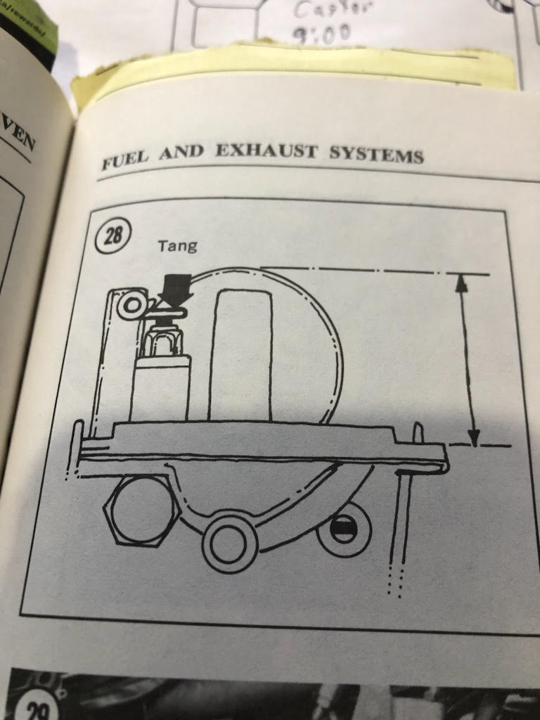

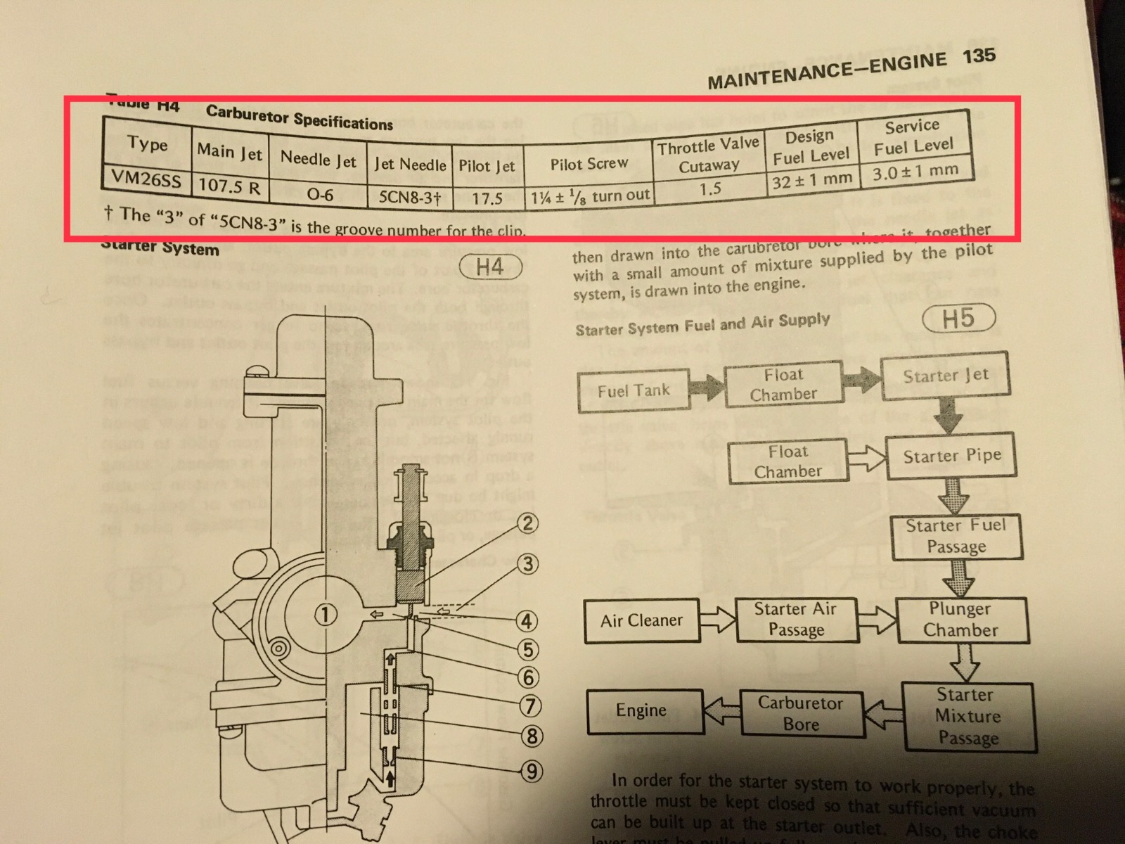

His correctors will correct a lean bog caused by pods. Pods make the low end lean because of the extra air they allow in. Sometimes people increase the pilot jet to try and compensate. Could also though be a rich bogg. What jets sizes are in the carbs. If factory carbs they will be 26mm with fuel pilot screws on the bottom between the carb and engine. Pilot settings are whatever makes the engine idle best. Could also be float levels too high or too low. Here is the factory spec for your carbs

I know the main jet is a 110 now , cause I wrote it down! But didn't on the pilot jet.
When I reassembled the carb I set the pilot jet at 1 1/4 turn out.

Looking at the Clymer Manual. To measure the float height, invert the carb and measure from the carb casing to the top of the float. Correct!?

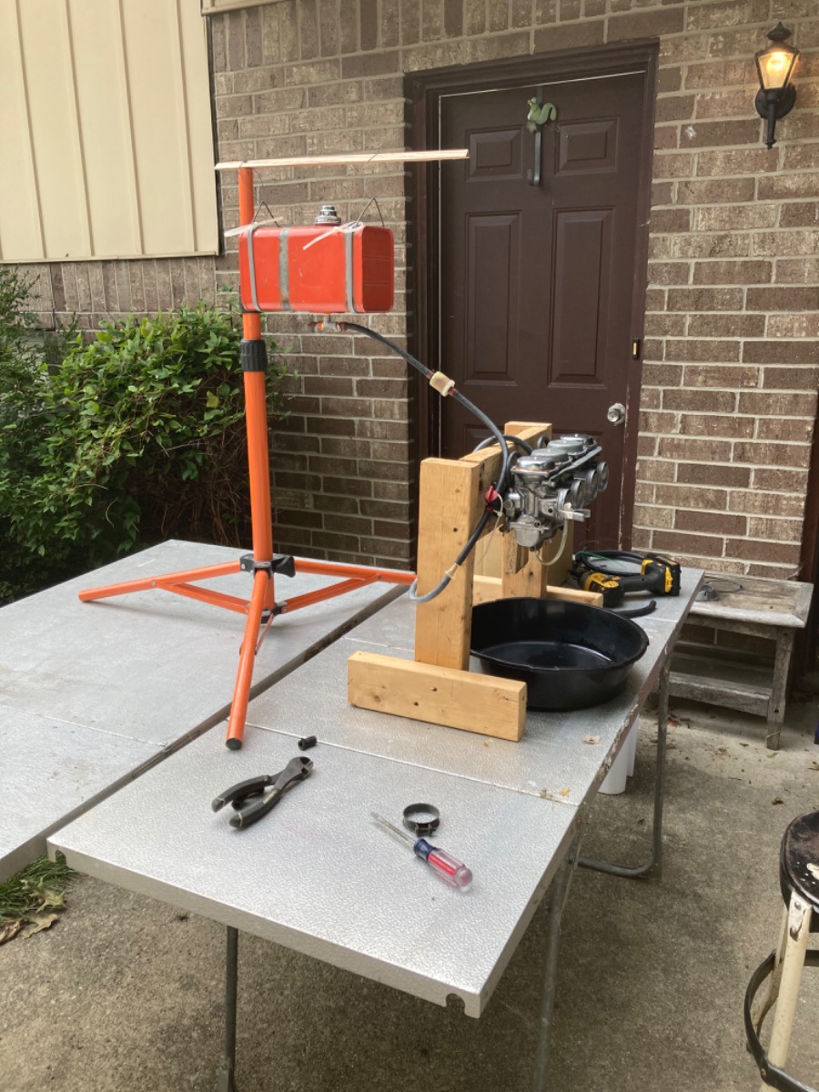

First take that Clymer and use it under the side stand to stand the bike more upright. Then follow this method to set floats. I built a stand and use an old lawnmower tank. It takes time and patience but it’s easy.

I know the main jet is a 110. Pilot jet I don't know. I'll have to check.

LOL I'm guessing you don't have any good to say about the Clymer manual!?
Thanks for the service manual write up.
Is that from a Kawasaki service manual? Is that available, here on the forum? I had a quick look before replying to your post, but....
That's a nice set up for working on carbs. I can't tell in the pic, what you're using for a float level gauge. If it's on there!

The clear tube is in place on number one carb. These carbs have a drain nipple that is controlled by a screw. You put a section of aquarium pump line on the nipple and open the screw. This fills the tube and you can see float levels. See screen shot of float level tool. They’re available but pricy. I’d try the Nessism trick. He say cut the hose to like like a pencil and you can thread it into the threaded drain screw hole.

Mikaw - I'm almost ready to bench sync and set float levels and I've been planning how to make a fixture. What I've pictured in my head (an ability useful as a draftsman especially before CAD when we did it by hand on a large drafting board) is similar but I like yours better. Do you have holes for the carb throats to set the sync from the cylinder head side ?
Thanks for the ideas.
