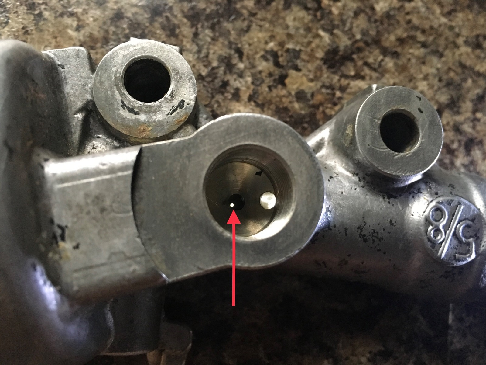

07 Nov 2023 20:37Back pressure? Do you have a solid hard peddle? If not it’s more likely a bleed/balance return port that is blocked. It a very,very,very tiny hole dead center under the large side bolt. Aslo need the holes in the end of the piston clear.
Pretty sure the tiny hole in the MC was open. I sprayed some brake cleaner through it to be sure.
But 2 of 3 holes in the piston were plugged. That's one thing I never checked while cleaning!
Thanks

Hey! glad I looked at this post!
Thanks Matt Mikaw! I am in middle of the master cyl. rebuild. 1st time for the 77-80 style rear! I never knew about that tiny hole. I just looked at mine! Fresh glass beaded, washed in hot soapy water! Getting ready for the CERAKOTE! And mine was plugged!!! Well I'll be! This old guy is always learning!
Great tip!
Thanks!
