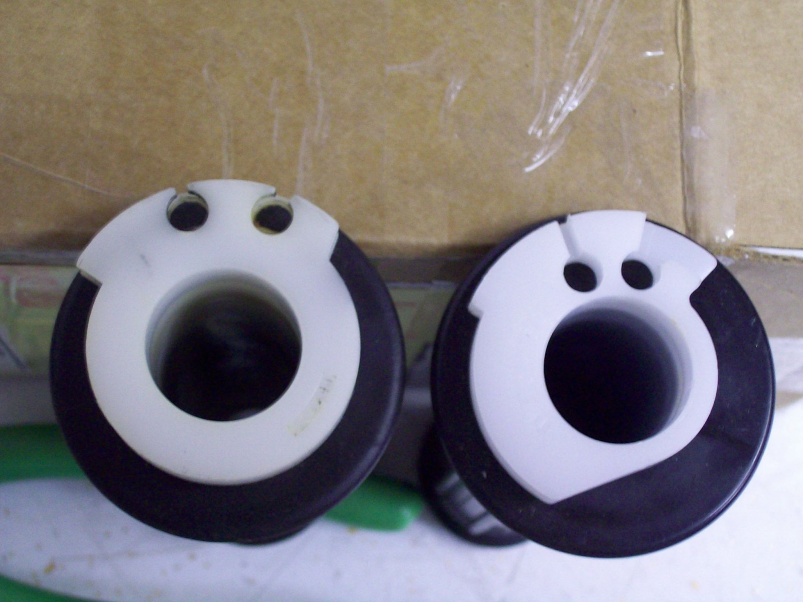

What throttle tube did you get with the Yoshimura throttle???
Mine came with the one on the left.
Nada...did not come with throttle.   However, I did find this slick throttle tube from motoworks that uses bearings and does not ride on the bar at all and comes with all different size cable cams.
The search goes on...I did find some OEM throttle cables for my 81 GPZ550, thats about to be assemble after far too long.   Still looking for OEM speedo, and clutch for that.
Plenty of Z900, Z1000 cables from japan.  I might try those if the Z1R are un-attaineum.

The S1 came with the bath tub design cylinder head. It was the first Kz that used the bath tub cylinder head. Kawasaki then used the design head on the '83/'84 ZX1100's (GPz1100).
577nitro
Is this the one you're talking about?
www.motosport.com/works-connection-elite-throttle-tube
That looks like a perfect candidate for my Mrs' bike.

I received a 12-1019 and 12-1018 (the 78-80 Z1R OEM cables) as well as a German Made 12-1019 exact copy.   I installed them on my Yoshi throttle holder, lubed them the best I could and what a difference.  Night and day, and I shit you not.   At least a 30% reduction in force required.  So much smoother, I was able to back down the spring tension on the carbs because it no longer needed to fight that friction.  The German made one was on par with the OEM.  And it was  bitch to find the OEM's.   I need to adapt the Works Connection throttle tube to fit the ISD of the bars, so I'm guessing it will even get better when that is done.
I'll give a ride report on this setup when I get a chance.   I'm still working the fly-by wire as well.

Hey slayer, did you get the throttle setup to work? If so what throttle tube and cables did you go with? Im trying to get my setup on my kz1000r with KEIHIN CR's

Hey Dr.Gamma, I noticed this thread as Im trying to set up my 83kz1000r with Keihin 33mm and need to get the throttle setup. I just bought the YOSH push pull throttle on EBAY. Now I need to figure cables. I see your recommendation getting the throttle cables. What about the throttle tube? Where do I get that from?
Thanks for any help

Try using a 1978~1979 GS1000 inner sleeve part number 57110-34601. I used that one on my Yosh throttle. If you can find one the RG500 inner sleeve works too and it is quicker than the Gs1000 one!!!
