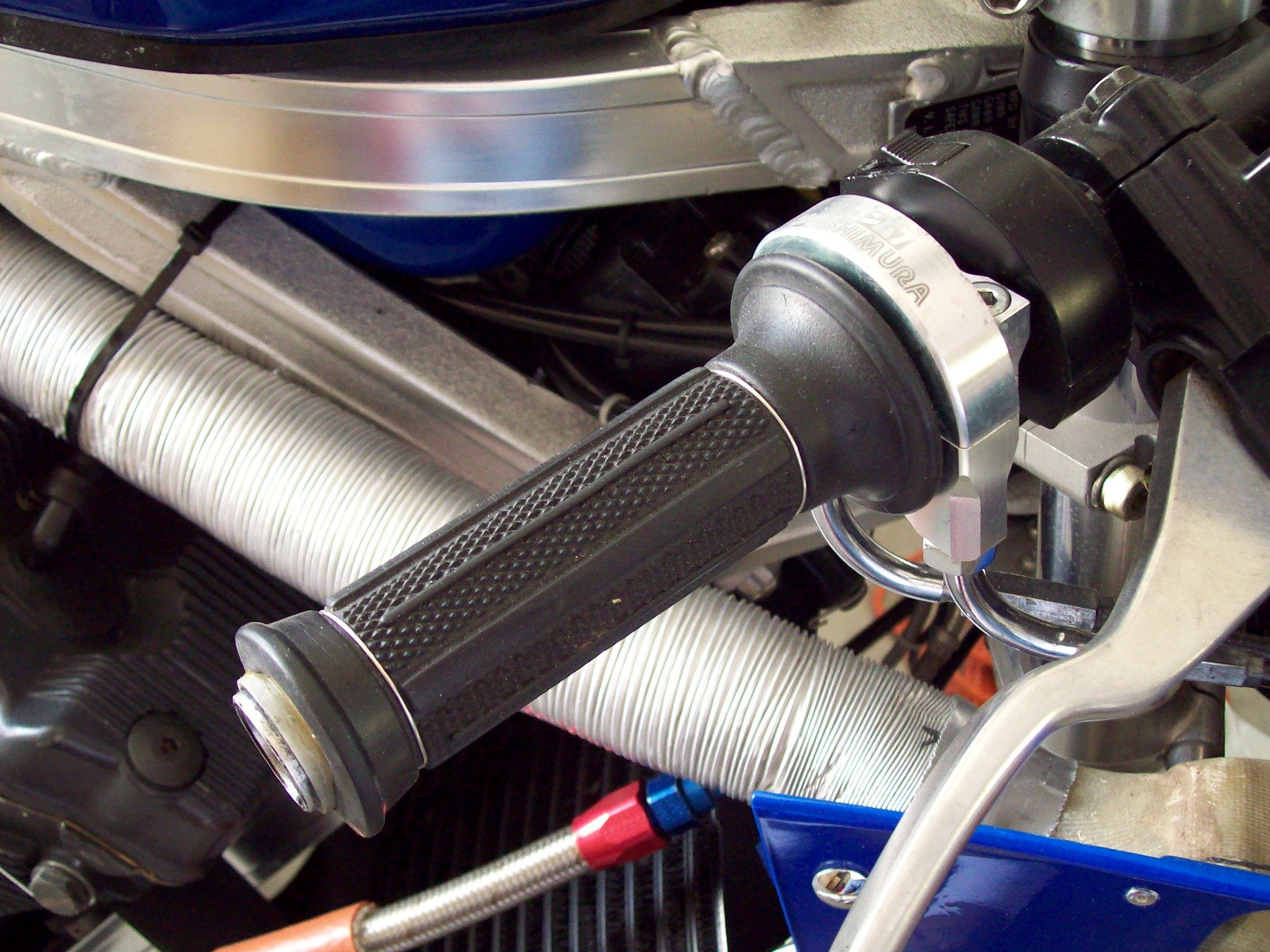

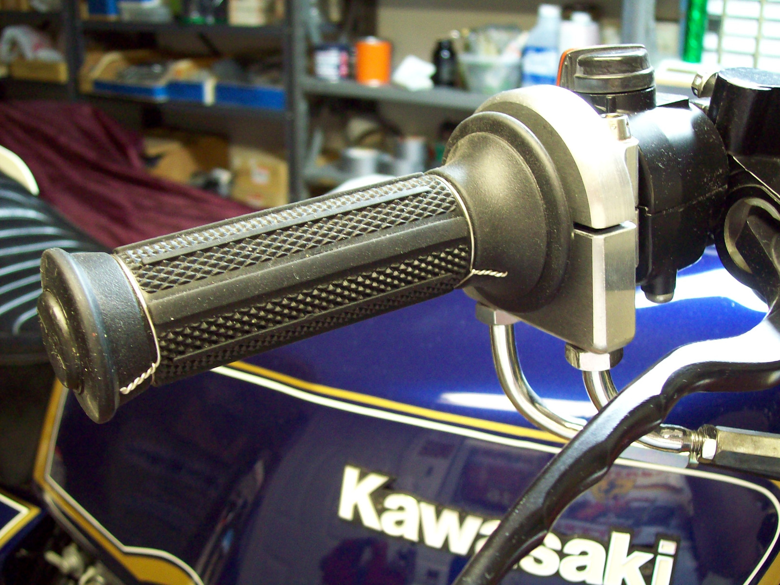

I have a set of Mikuni RS36's on my early model GSXR750 and a set of Keihin CR33's on my Kz1000 Superbike. I just went out to the garage and checked to see if there was any difference in the amount of effort it took to open both sets of carbs. I have the very same type of 1/8~1/4 turn throttles on both bikes. There is very very little difference between the two!!!
The RS36's take a tad more effort to open them. I am talking a very minute difference between the two. I never had to deal with any type of discomfort on long rides on the GSXR750 with that throttle. I use O.E.M. Kawasaki cables on both bikes. The GSXR750 uses Kz1000D1 (Z1r) cables 54012-1018 and 54012-1019. The Kz1000 uses Kz1000S1 cables 54012-1030 and 54012-1031. I must have tried 5 or 6 different length cables till I found the perfect length!!!
The GSXR750 uses the billet throttle from Yoshimura they offered for that bike many moons ago. I had a Motion Pro throttle on the Kz1000 at first. WHAT A PIECE OF JUNK!!!!! I even reworked the Motion Pro body to except O.E.M. type thread in cables. The Motion Pro throttle was like opening a bear trap. I scrapped it after I found an early billet prototype Yoshimura throttle. Both Yoshimura throttles use the very same throttle sleeves. As soon as I installed the Yoshimura throttle on the Kz1000 it was as easy to open as the GSXR was!!!!
My suggestion is if you are using a Motion Pro throttle and their cables I would scrap them. Find yourself a high quality 1/8~1/4 throttle and a pair of correct length cables. I have seen copies of the billet Yoshimura throttles for sale in a few places. When I say correct length cables what I mean as you move the handlebars from lock to lock they do not get get tight in one spot or put a sharp bend into the cables. The Motion Pro cables are no where near the quality of the O.E.M. brand cables. I don't want to tell you what I paid for a NLA O.E.M. Kawasaki Z1r closing cable and clutch cable!!!!
The GSXR750 with the Yoshimura throttle and Z1r cables.
The Kz1000 with the Yoshimura throttle and Kz1000S1 cables.
