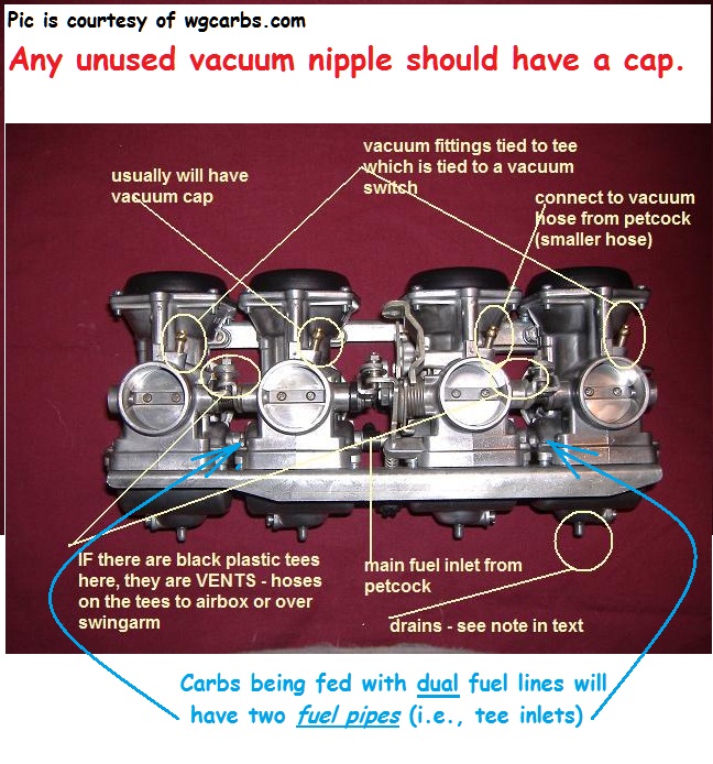

One more thing mate - just checked out that WSM you DLd ? with LTD H4 supplement .
Remember you saying yours was a US model ?
The pics in it are crap but there are 3 combinations to try -
The US model is setup with vacumn hoses on 1, 2 and 4 with a cap on 3
The non US model has them with vacumn hose on 2 and caps on 1 , 3 and 4
whereas mine has vacumn lines on all 4
Give em all a go - you will just need a plastic T join no matter which way you try
Bloody hope this fixes your bike - has to be something that simple now.

For some Keihin CV34 vent info:
Click here > www.wgcarbs.com/index.php/using-joomla/e...gories/91-cv-connect
If the carbs at hand are the Keihin CV34 design without vent nipples, the float bowls may vent through big holes on the edge of the venturi.
Would assure the vent holes are clear and not obstructed by anything such as sloppy pod fitment.
Some Kehin CV34 carb designs reportedly vent the float bowls through the overflow circuit, so would check the brass overflow tube going straight down to the bottom of the float bowl to assure it isn't obstructed, and that the overflow circuit is clear, and that the hoses connected to the overflow nipples are clear and unkinked, and exit to open air.
In any event, the objective is to assure that the float bowls are venting as they are supposed to, regardless of the particular venting system designed into the carb(s).
When the float bowls aren't venting as required, normal fuel flow into the float bowls is restricted, whereby fuel level in the float bowls becomes too low, which is like "running out of gas."

SKK sorry mate bit of brain fade there last post - you will of course only need a T join for my setup with 4 hoses - it was late here and by the time i thought of that was trying to get to sleep. You have given those carbs a good clean out with carb cleaner and compressor with all parts out havnt you (and blown through overflows/vents with all parts removed)?Make sure if you have to again keep those Diaphragms over the other side of room when using carb cleaner .
Bit of a problem when we have different names for parts Patton - got ya now - Vents = Overflows here - Sorry for the mixup
Your carbs have only 1 main fuel line in centre from tank SKK ?

Awesome guys thanks, lots to go on and fiddle about with there now
Weirdly the bike is beginning to perform a bit better since I've been riding it to work this week and thrashing the nuts off it down a couple of nice straight roads on the way. I can't figure out why that is but I'm not complaining! Its still ropey in the top end but I actually managed to get a ton out of it this morning (at least I think it was as stupid US speedo only goes to 80mph...why?!) I can't seem to redline it but the revs were getting up to around 9-10 so a bit of improvement, guess it could be to do with the new manifold rubbers settling in or something getting blasted out maybe?
I'll give the carbs a synching & mess about with the vacuum hoses n hopefully that will get her running that little bit better.
Have noticed the valve ticking noise is quite annoying, any ideas why its doing that or how I managed to do that? I took 3 of the valves out as I was going to replace them but put them back the way they where as bike shop guy said the clearance was ok, then the cams back on etc. It sounds like a loose valve, its like a tapping/clacking sound? Do i need to worry about it?
ZR it is just one fuel line in the center going in to the carbs yeah.
