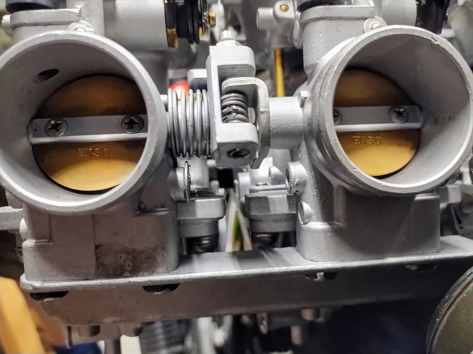

Can you post a photo showing the throttle butterfly position at idle?
When you twist the throttle to full and let go, do the butterflies snap shut with a thud?

Ness
I'm not sure how I can take a photo of the butterflies with everything installed. I can tell you that when I let go of the throttle it does thud shut.
Watching the shafts and the linkage for syncing when I twist the throttle that shafts turn approximately 90 degrees and then snap back.
