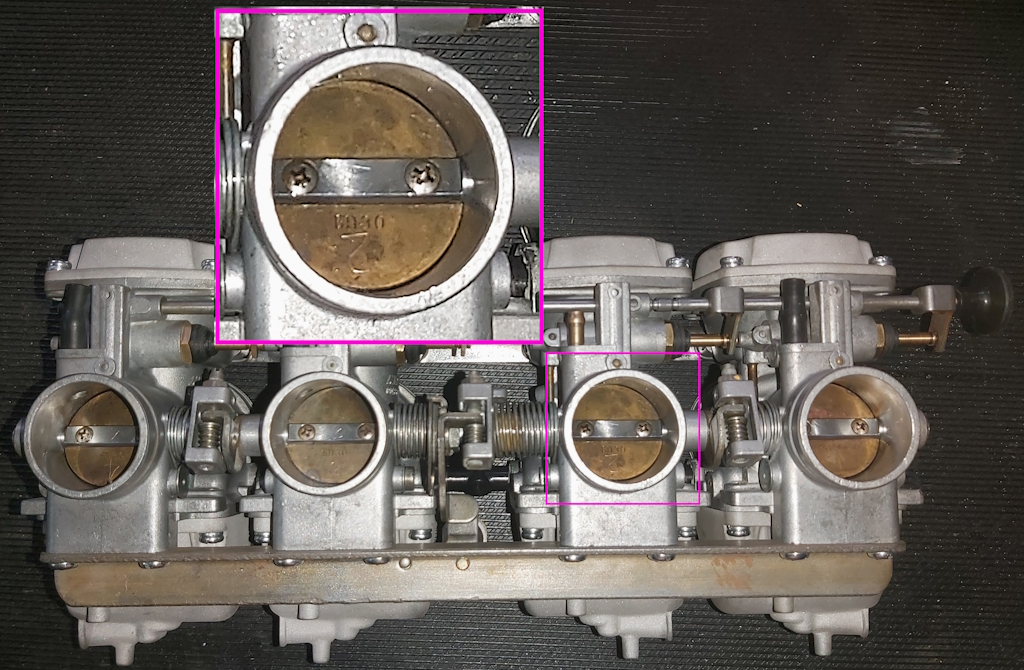

For a motor to "Rev" it needs "air" so either the throttle flaps aren't closing fully or it has an air leak (unlikely given you have replaced boots, vac caps etc)

That one photo looks like you "might" of bead blasted them as an assembly im i correct? That grit, if so, can get wedged in places you might not think! Also check those two phillips headed screws per butterflies. If You or someone else loosened them then butterfly might of gotten cocked in venturi and not fully closing. 6K might sound high but those butterflies don't have to be that open to achieve that rpm level. Also double check choke plunger seating position if applicable.

25 Aug 2026 07:02
Tex
Idle adjustment screw is backed out, It is screwed in just enough to stay in place.
All
Thanks for responses
I guess I will take the rack off AGAIN. Gonna double check the butterflies,
That seems at this point to be the only thing left.
I rebuilt these about 15 years and never had any problems. Guess I got lucky!!!
All

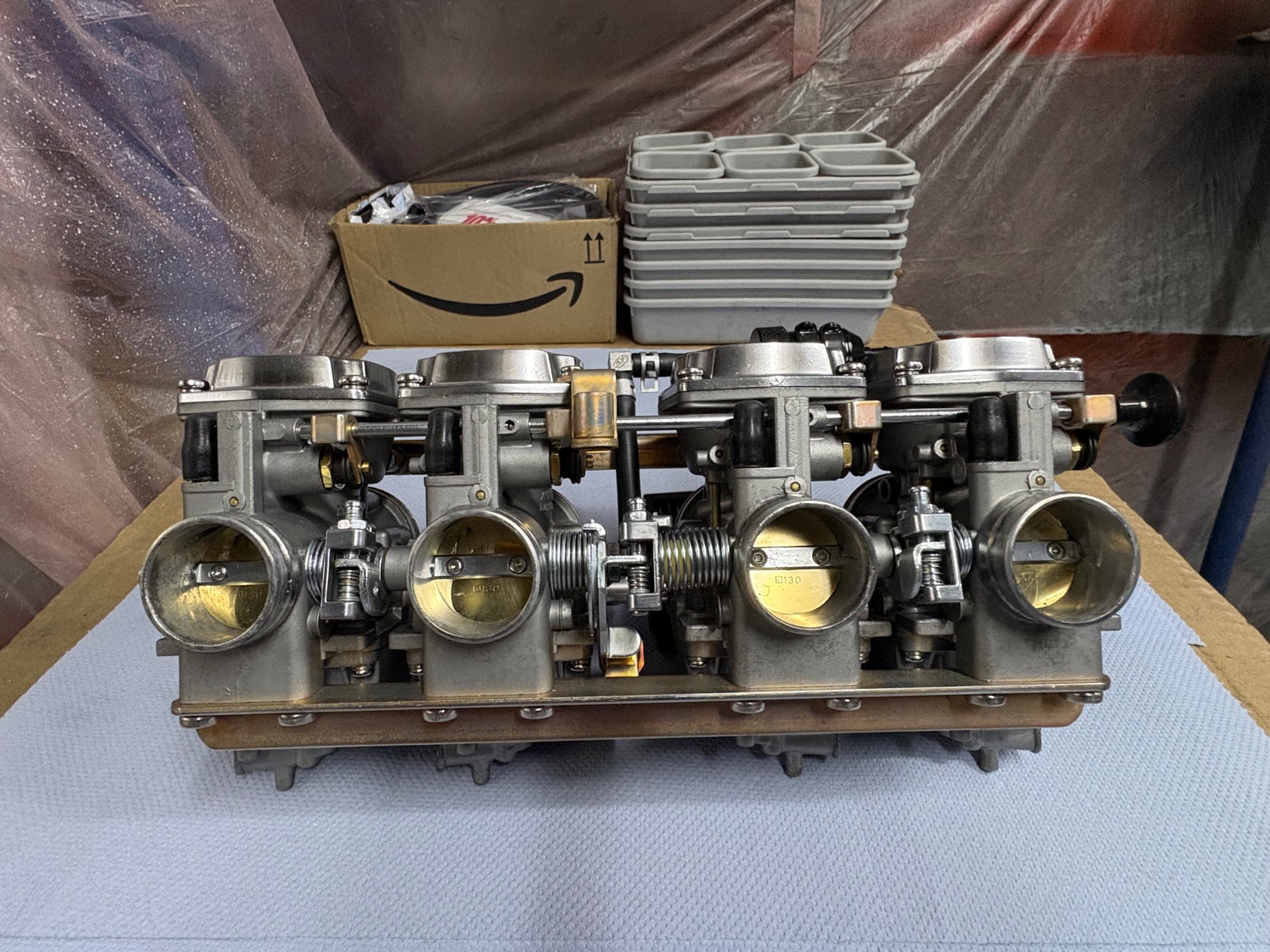

Comparing what mine looked like after a full re-build... to me, it "seems" that the butterflys on your carbs are not closing fully.
