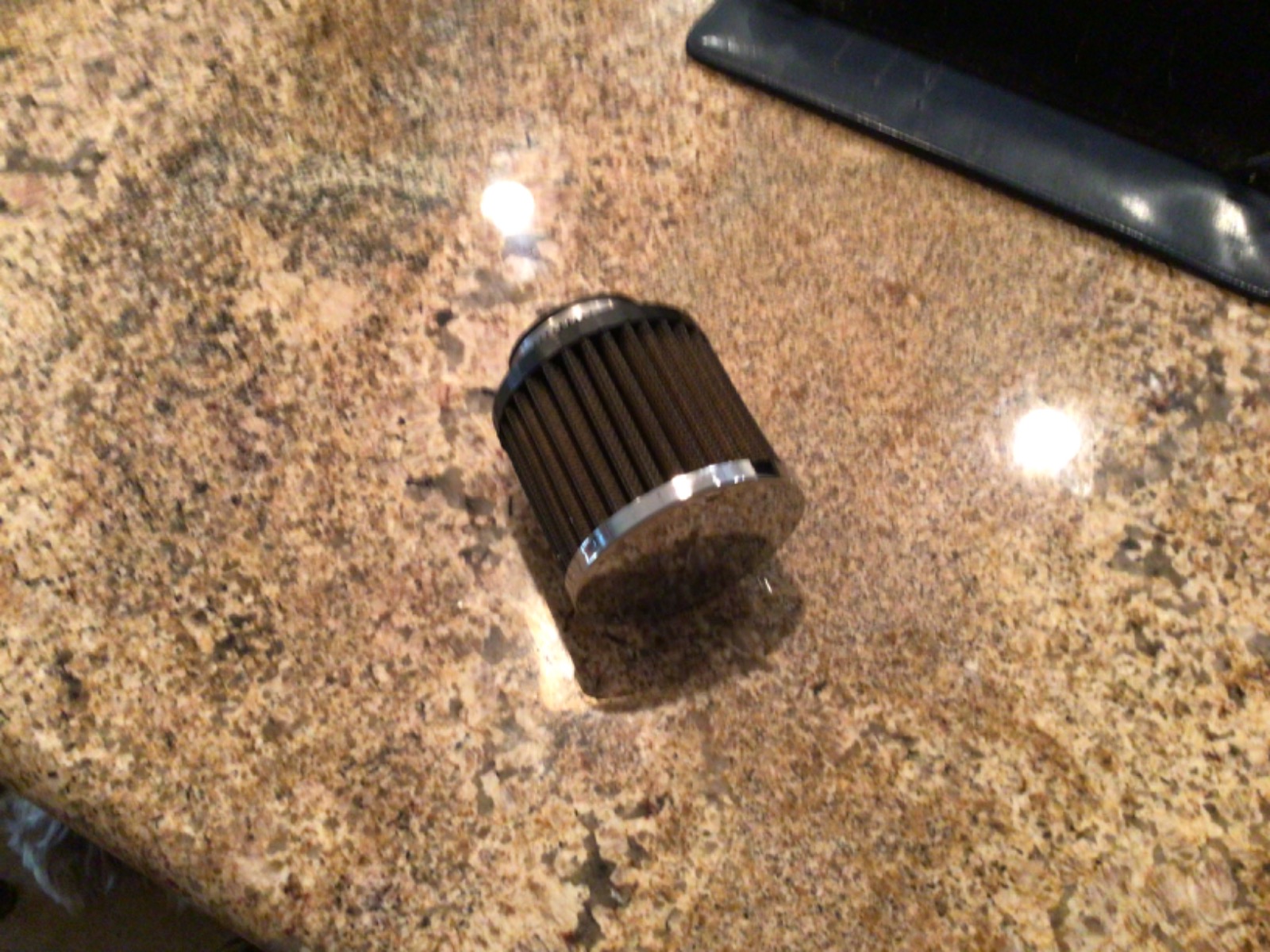

I have K&N air filters. I have Zeds air corrector jets. Clips in middle (3) position and 117.5 main jets. The stock jets are 115 and I could easily change back to those but……

19 Nov 2023 02:35 - 19 Nov 2023 02:44You MUST return to the STOCK pilot jets with the air correctors.I have K&N air filters. I have Zeds air corrector jets. Clips in middle (3) position and 117.5 main jets. The stock jets are 115 and I could easily change back to those but……
This is stated clearly in my instructions for fitting them.
ALL settings , pilot jet, needle position etc back to stock apart from the mains increase.
The larger pilots will be causing the off idle "fluffing" due to momentary OVER richness at that point.

Here are the standard parts. Something as Zed mentioned is causing a rich off idle stumble. The plugs show that also. Need to fix the voltage to the coils, could be weak spark at low rpm then once battery voltage rises you start to get a fatter spark.

19 Nov 2023 09:29Ignore my last post.My pilot jets are stock and all the tiny holes are clear and clean
I misread it as you having larger pilots.
The 117.5 mains should be correct and they wouldn't affect the bottom end anyway.
Leaking choke plungers are a likely suspect for low end fluffing so hopefully the new seals may cure it.
