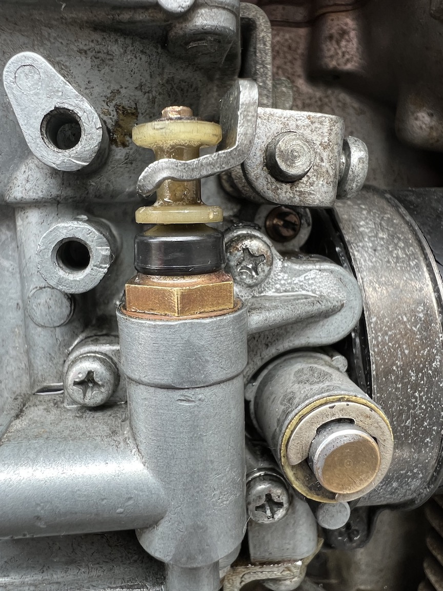

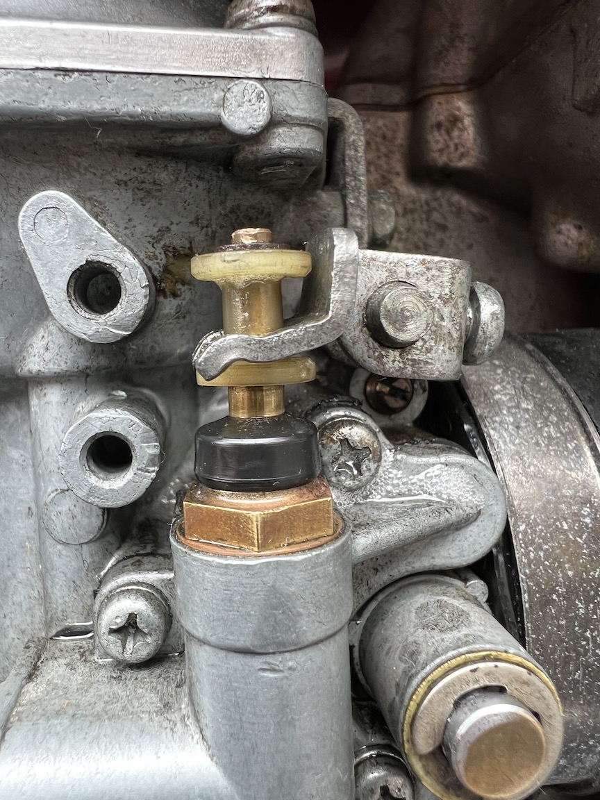

Looking for suggestions.
My 77 carb body might be damaged beyond repair.
Found out why my choke starter plunger is bent.
It wasnt me when I tapped the carbs. My 6 year old son was in the garage trying to "fix my bike" the other day with my lead hammer., imitating me tapping the carb bowls with a screwdriver.
I checked the garage video feed and saw him do it two days ago. He likes to "help" and banged on the carb body and I think bent the starter plunger mechanism or or rod. Now it wont close unless I push it HARD with my hand.
if anyone has a set for sale. Or replacement suggestions, let me know.
Normal, choke off
Choke Opened
Wont close unless forced:

If it were mine, I would find out what is bent and the straighten the bent bits.
Upon closer inspection, it looks like the casting that the plunger screws into has a non-factory flat spot on it. If the plunger does not unscrew without excessive force, there may be a bigger project involved. Still, I would find out exactly what is messed up and then decide the path forward.

I told him "I saw you were trying to fix the bike on the video. thanks little man, but next time let daddy show you. you did a good job! Now Im going to take the carbs off so they can get polished!" lol
I really hope the plunger can be straightened.

11 Aug 2022 06:40 - 11 Aug 2022 06:59...If it were mine, I would find out what is bent and the straighten the bent bits.

Thanks for pointing this out. I realized this when I was researching this morning. Im going to have mine rebuilt, and the starter plunger straightened out.
Re: What other year CARBURETORS fit a 1977 KZ750 TWIN B1? My 6 year old broke em
11 Aug 2022 10:07
Beyond an obvious bend in the choke plunger Id be looking at the “non factory” flat spot the Tex noticed. The plunger is a snug fit to the bore. Your little helper might have made your round bore into a “D” shape. I’m sure it could be drilled to correct.
