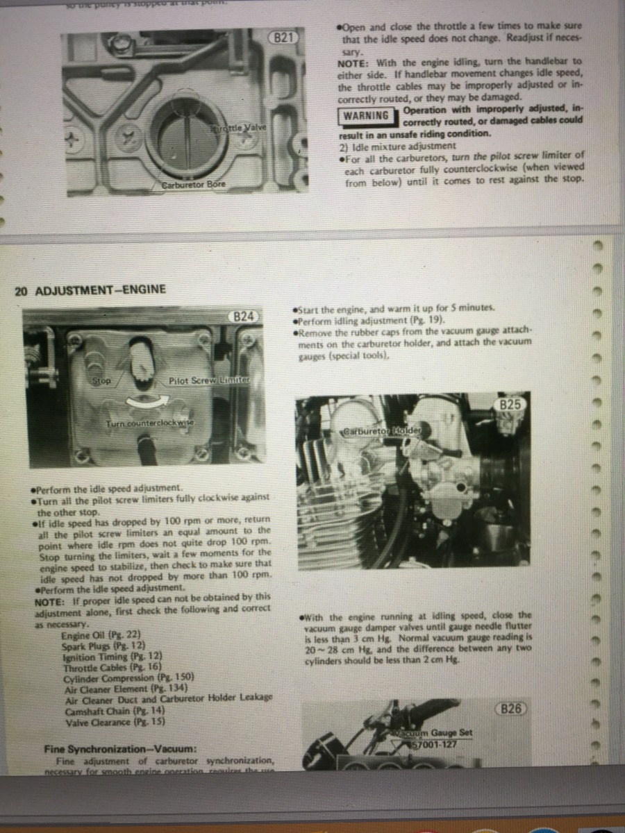

The attached photo shows the correct procedure to set your pilot screws.
If you are going to check your clearances again you should also check your timing. This could be the cause of your idle problems.
