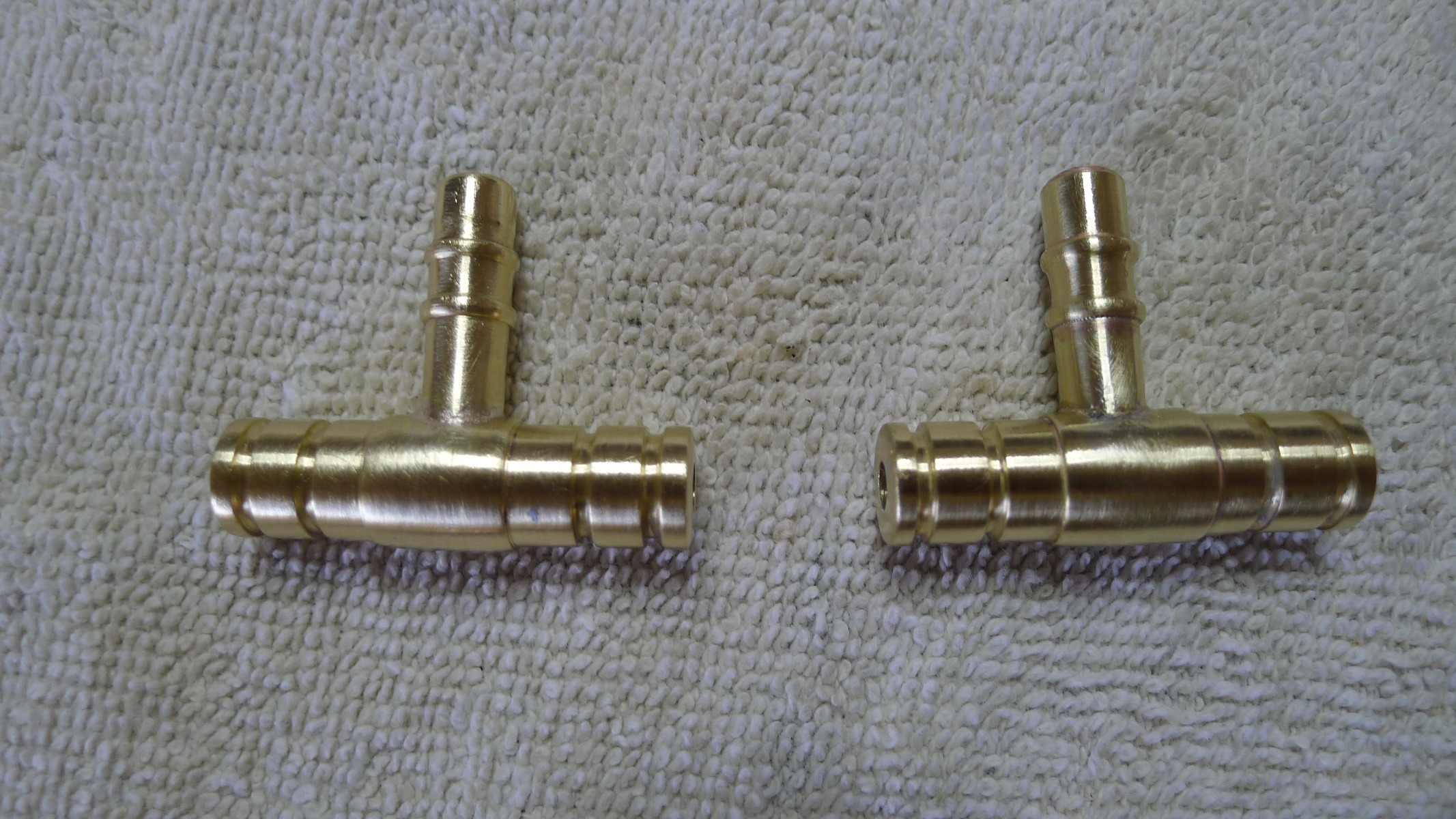

No eBay APP ID and/or Cert ID defined in Kunena configurationBought some of these Tee's only to find they don't fit VM26's from the KZ1000.
Didn't feel like waiting for some other parts so sat down at the lathe and made a couple. I've made Tees before so at this point I'm getting pretty good at it. Can't say it's a money saver after all the time spent though.

Ebay ones have O-ring OD of 10.2mm and the port in the carbs is 11.0mm. I requested a return via ebay and this is what the guy said...

The rubber is deeply cracked. I don't trust the long term durability of fixes I can't guarantee. We are talking about gasoline just under the crotch!

Here is another option. I have been doing this for Years and it works everytime. Because I like to keep things original and rarely buy suspicious aftermarket stuff. KEEP your original VM Mikuni tees, nothing wrong with them. Just "roll" a sharp utility blade along the inner bump and remove the secondary bump and rubber in between. You will encounter two styles, one smooth and one with a casting rib. Sand off/steel wool if casting is ribbed, the corrosion. Pop on a #78 o-ring, there is room for two! Cost is only whatever you pay for the O-rings.

Some guys use a similar method only they cut off the sealing bumps and drop real O-rings in the slots. I'd consider this method as long as there are no cracks in the rubber/plastic coating. One of my original Tee's qualify but the other is full of deep cracks at the base of the fuel feed portion of the Tee. These carbs are for resale and I won't take risks with gasoline. Not worth it.
