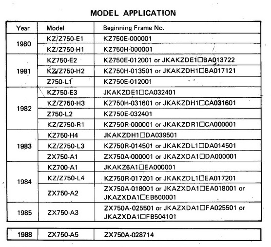

To help identify your bike there is some info on frame numbers on page 6 of the Haynes. Also see the table below.

Thanks for the frame number diagram, i now know my bike is the 1983 H4 model, checked the needle its a N01A which is correct & it doesn't have the adjustable clip settings it seems, just a screw out head.

For identifying the bike,you could try Z Power.They helped me with my CSR. Also,just a thought but Ive heard of some bike restricted with a rev limiter,could this be worth checking? Good luck,hope you get it sorted.
