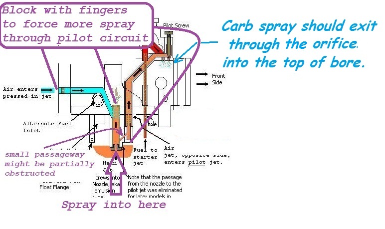

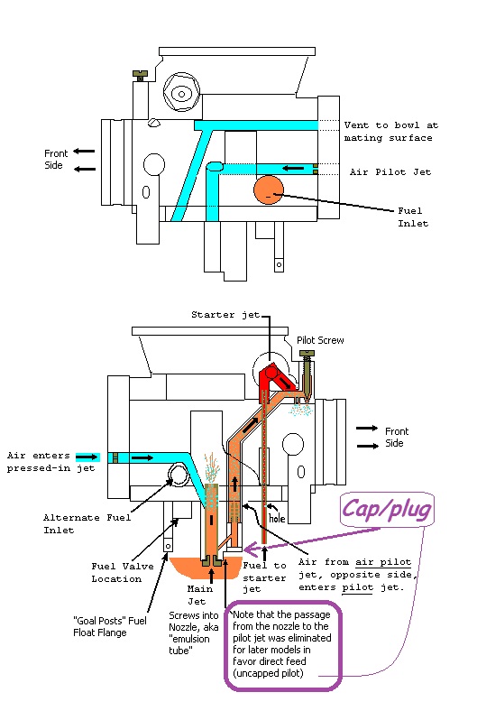

Given good intake suction, but dry plugs, yet runs with starter fluid -- indicates absence of fuel mixture entering carb bore through choke orifice or pilot circuit orifice, for whatever reason.
Could be blockage in the pilot circuit, or too low fuel level, or maybe something else

Patton,

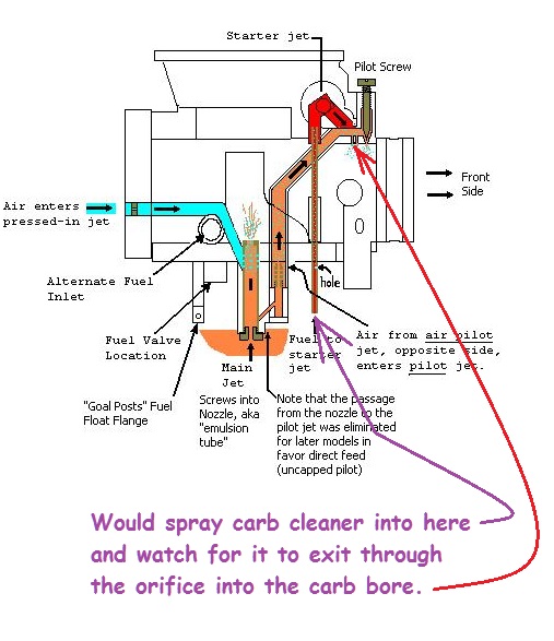

Excellent Diagram. I'll give it shot on monday my day off! The bike ran before I rebuilt the carbs. This is why I'm worried that Soaking them in Berrymans may have some how effected them. When I sprayed down from the enrichmnet chamber I noticed if I didn't get the straw directly in the hole of the enrichment circuit to the enrichmnet tube, fluid would come out around the enrichment tube and not through it.This also makes me wonder if Berrymans somehow dissolved sealant where the brass post is pressed fit into the carb base from manufacture. Possible? When I pull off the carbs I think I will try to plug off both end of each Carb and look to see if the butterfly shafts are leaking. I have cleaned the Enrichment circuit countless times, and spray always comes out where it is supposed too. I know the enrichment circuit helps to start the bike, does the pilot only kick in once started. I took the top off of number 1 carb and turned over the engine and I could see the pilot spraying.(I believe this is only because the diaphragm and needle were removed) So if the enrichment circuit does not start the bike, then there is not enough vacuum to raise the needle just enough for the pilot to kick in) . By removing the needle I allowed the pilot jet fuel and the engine suction did the rest. Am I on the right Track?

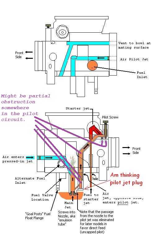

The pilot circuit is supposed to function at fully closed throttle position, which is the situation with a warm engine at idle rpm.
Adding "choke" introduces additional mixture, especially when the throttle is closed (but also when the throttle is partially open). In other words, adding choke adds additional fuel mixture to the fuel mixture already being supplied by the pilot circuit.
So the problem at hand might be largely attributable to failure of the choke circuit (would assure clear fuel pipe to starter jet -- see image posted), but would seem that spark plugs would not be completely dry where pilot circuit is supplying at least minimal fuel, regardless of a failed choke circuit.
That's why thinking there's blockage in both choke and pilot circuits thereby preventing any fuel mixture at all from entering the combustion chamber.

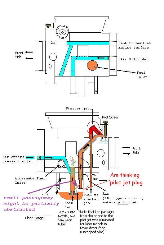

Would again assure that the tiny short passage into the pilot circuit is clear.
And that the plugs are properly installed at bottoms of pilot jets.
The plugs are essential, as the pilot jets must not be "open" to the float bowls (which would inhibit mixture flow through the pilot circuit).

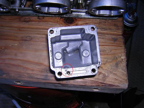

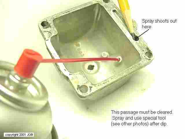

Follow Patton's cleaning diagrams for sure. I found blocked passages even after a major cleaning with method the he is suggested to you. But I would also point out that you don't forget the passage for the coke circuit located in each float bowl. These jets have a high probability of clogging when fuel sits and gunk's up the bowls. Carburetor cleaner and compressed air weren't enough to clear mine. Had to use an appropriate size wire before they opened up an then was able to confirm the are open by spraying more cleaner. Like Patton said, its sounds like its both the pilot and the choke circuit. But just thinking it may be worth checking the choke bowl jets to help the coke along. Good luck.

06 Jan 2012 04:22 - 06 Jan 2012 04:29KZJOE900 wrote: ...don't forget the passage for the coke circuit located in each float bowl...Carburetor cleaner and compressed air weren't enough to clear mine. Had to use an appropriate size wire before they opened up an then was able to confirm the are open by spraying more cleaner...worth checking the choke bowl jets to help the coke along...
Excellent suggestion!
Here's a link to the tutorial among the "Not model-specific" files in KZr's FILEBASE:
Click here > www.mtsac.edu/~cliff/storage/gs/Mikuni_B...Rebuild_Tutorial.pdf
And here's a link to another helpful tutorial:
Click here > www.thegsresources.com/gs_carbrebuild.htm
Both tutorials include helpful pics.
