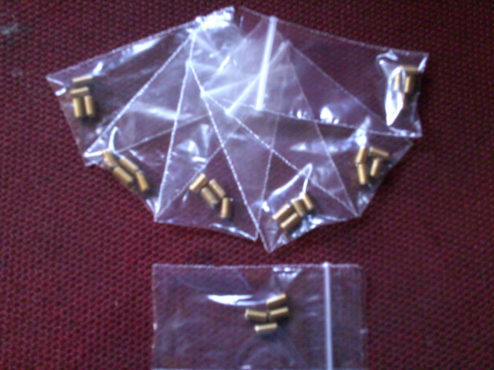

Had some renewed US interest in these so thought i'd put this out there again.
Air Corrector jets for Z650,Z1,Z900,Z1000 and also Suzuki GS 750,850,1000..
These are machined to order by me in the UK for Z1 club and forum members.
They are for VM 24, 26 and 28mm round slide Mikunis and are essential when ditching the airbox and running pods, velocity stacks or open carbs to cure the off idle flat spot and improve overall performance.
A brief explanation of their function and use for those who don't know.
These are for use with pods, open carbs and velocity stacks … NOT to be used with airbox ( unless it has been cut open and offers virtually no restriction ).
They simply screw in the air bleed to needle jet tube in the mouth of the carb ( You tap this m5 at 8mm deep . No drilling required )..
( They do NOT go in the pilot air bleed )..
Fit and forget then make adjustments as normal to the main to suit engine size/tune..
Keep the jet needle in original position..
If the jet needle has been lifted as usual in an attempt to mask the issue it MUST be returned to the stock position.
They compensate for the extra air flow and higher venturi pressure at low speeds that results when removing the airbox which then weakens the off idle mix and causes the flat spot and bogging at around 2k rpms..
Helps improve running throughout the rev range and gives an average increase of 2 to 6 HP overall …
Beware of using cheap pods as these can be restrictive. Use only good quality K&N etc.
They are £32 a set posted within the UK + £28 per additional set on same order and substantial discount for bulk orders of 10 sets or more.
Overseas shipping at cost which is currently £7.35 to US but will round that down to £37 a set posted with additional sets as above at £28.
Items will be sent tracked and signed for..
PM me or reply on this thread to order.
Thanks..

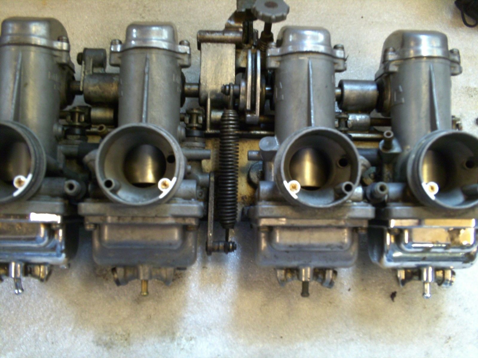

At the request of some members .
Here's a pic to clarify the correct location of the air jets.
On the left pair they go in the 4 o'clock position and the right pair at 8 o'clock as highlighted in white in the pic.
This is the air bleed to the needle jet (emulsion ) tube..( NOT the pilot jet bleed )
Beware of some carb banks with the FUEL mix screw underneath which were made up of all right hand or all left hand carb bodies and do not have an air mix screw on the side but just a blank.
In this case the jet bleed will be either all 4 o'clock or all 8 o'clock..
Whatever the case this bleed is always opposite the pilot air bleed whether it is blank or not.

Zed1015, the air corrector jets arrived today. Thank you. You mentioned to tap the air bleed to needle jet port M5 to a depth of 8MM. Is the 8MM critical. Is that what causes the correction jet to tighten as it bottoms out on the last thread? Do you recommend and thread locker on the jet before install.
- zed1015
- Posts: 3316
- Thanks: 2014
Re: Air corrector jets for Mikuni VM 24, 26 and 28mm round slide Mikunis.
27 Dec 2019 16:06
It's 8mm just because that's the length of the jet and it doesn't need to be any deeper.
Just enough to put the jet flush or just below the surface of the carb mouth.
Jet needs no thread lock, just lightly nip it up as it bottoms out..
