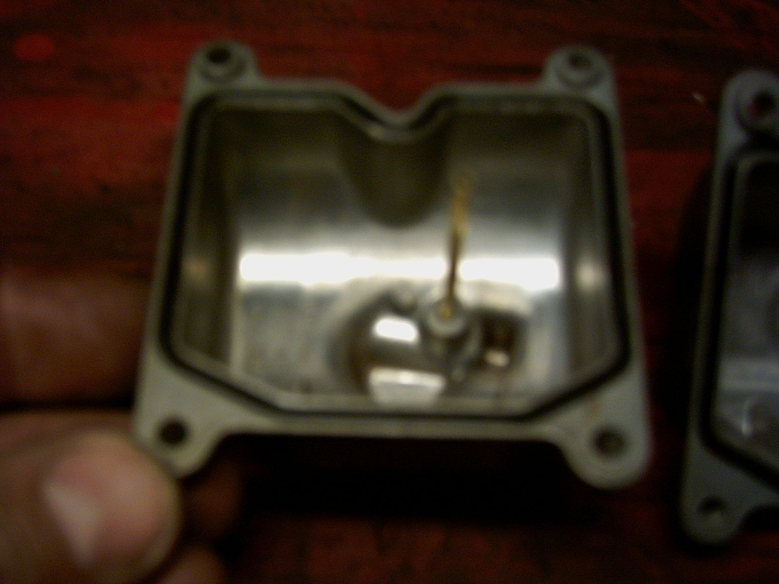

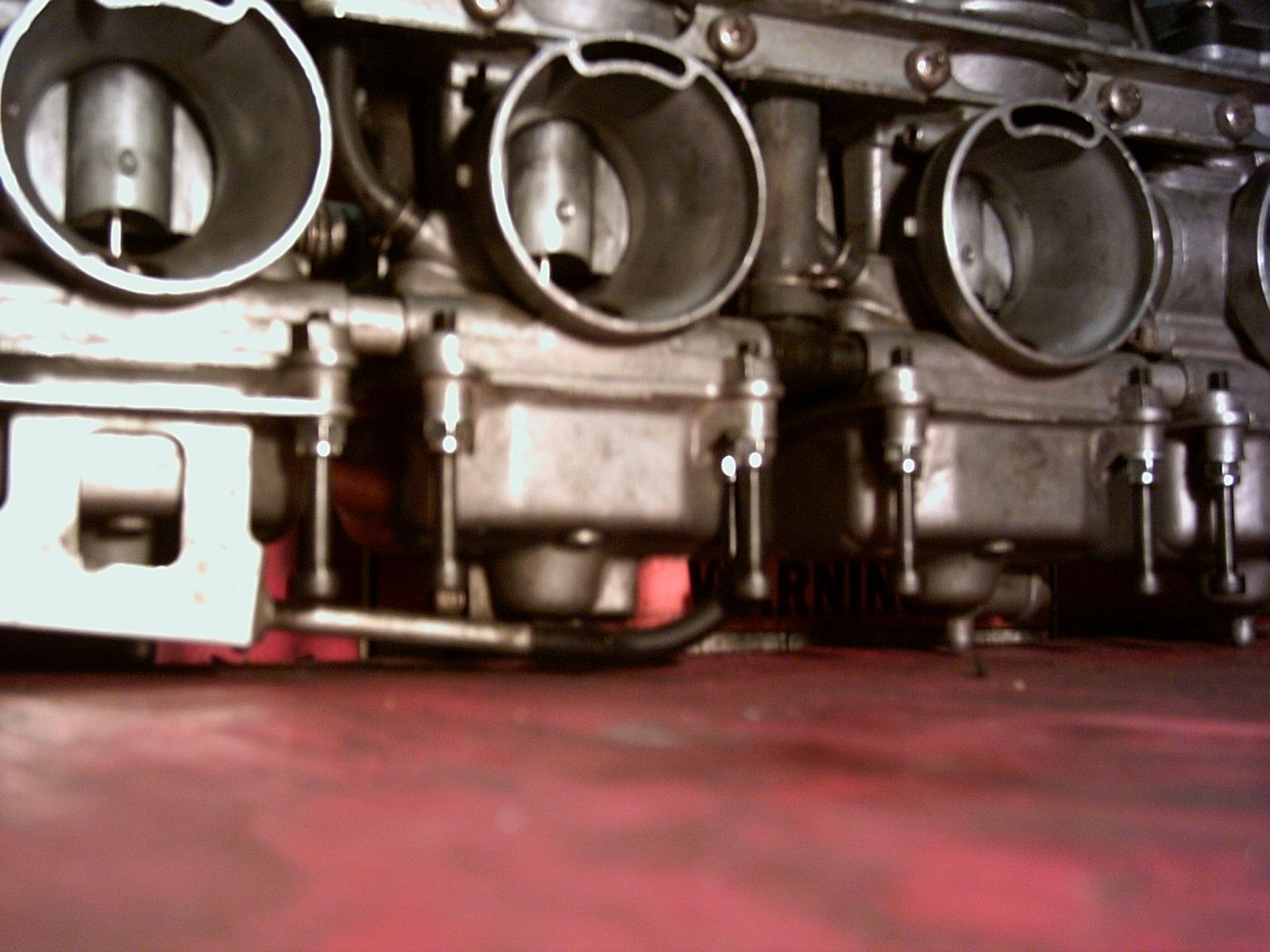

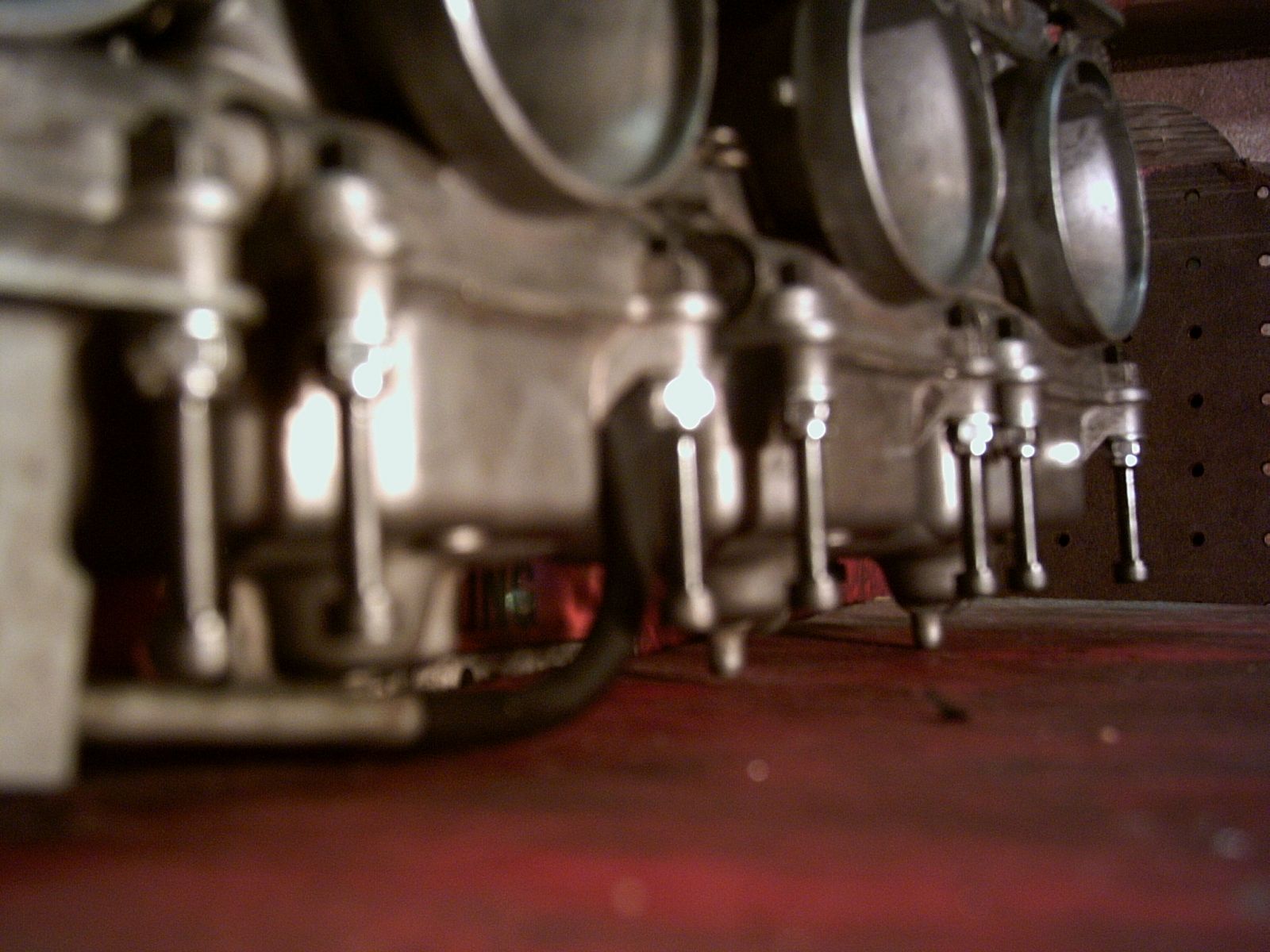

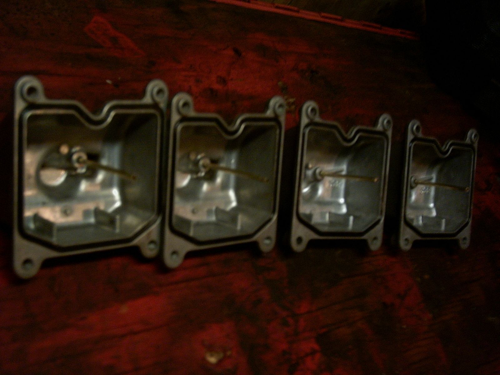

So these Keihin CVK32 carbs don't come with an over flow tube in the float bowl. So if the petcock is left on Prime, there is the good potential of the fuel flowing into the cylinder. Then when hitting the Start button, the motor may/ will Hydro-lock. It can and does bend Connecting Rods in these motors. That's Bad, you don't want the Rod bent.
So the Fix its to add Float Bowl overflow tubes. There is a boss already there where you can drill into the bowl drain circuit, then add a brass tube. Not really very difficult to do, all you need is some Hobby Shop Brass tube, I used 3/32" Brass Tube. It was 4- 12" tubes for $4 at Hobby lobby.
First you have to determine the correct drill to use to access the Drain Circuit, smaller than the tube Dia. Then once that's done, another Just smaller drill to make it ready for the Press/ Interference fit, so the Tube is tight and won't leak. i have a Full Set Of Numbered Drills, so I used #44 first to get the hole through to the drain circuit, then #43 for the final size. The #43 is about.002" smaller than the 3/32" tubing. De Burr and slightly Bevel the end of the Brass Tube, Then its just a easy light Tap Tap to seat it. I went to a length for the tube of 1.75mm, which gives quite a bit of fuel height before it will actually work as a drain., so Slosh won't drip/ leak. It makes the tube extend about 45mm above the set fuel height. That will create a drain, before it reaches a height which would flood the motor from the next lowest point, the Needle Jet/ Main Jet Well.
I'm sure the reason for the Lack of Drain tubes is the EPA. This 90 Concours is a California model, although they all have No Overflow Tubes, this also has a Charcoal Canister/ Vapor Recovery System for the fuel tank and carbs, all sealed. No fumes escaping into the atmosphere.
I also replaced the 4mm x.7 Bowl Screws with a much longer Allen Cap Screw and a washer/ lock-nut set up. This enables a much easier removal of the bowls, to change Mains, or Pilots, adjust fuel level, etc.

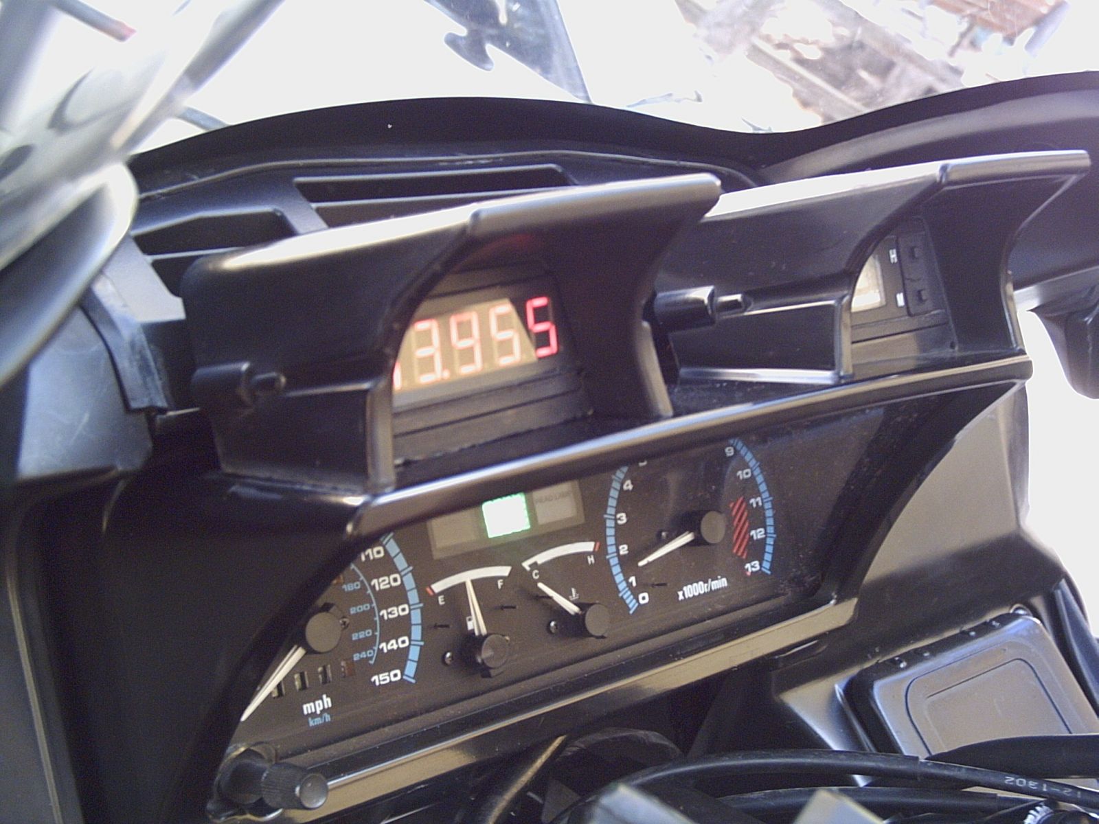

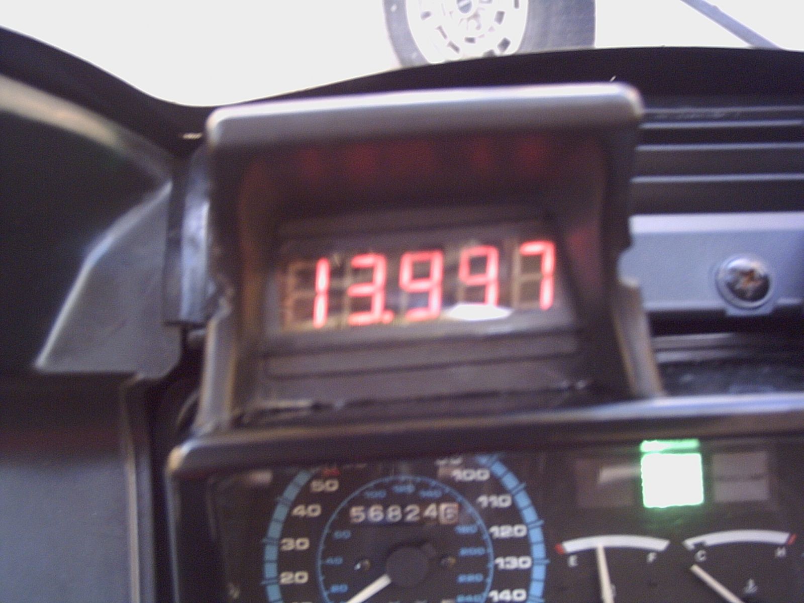

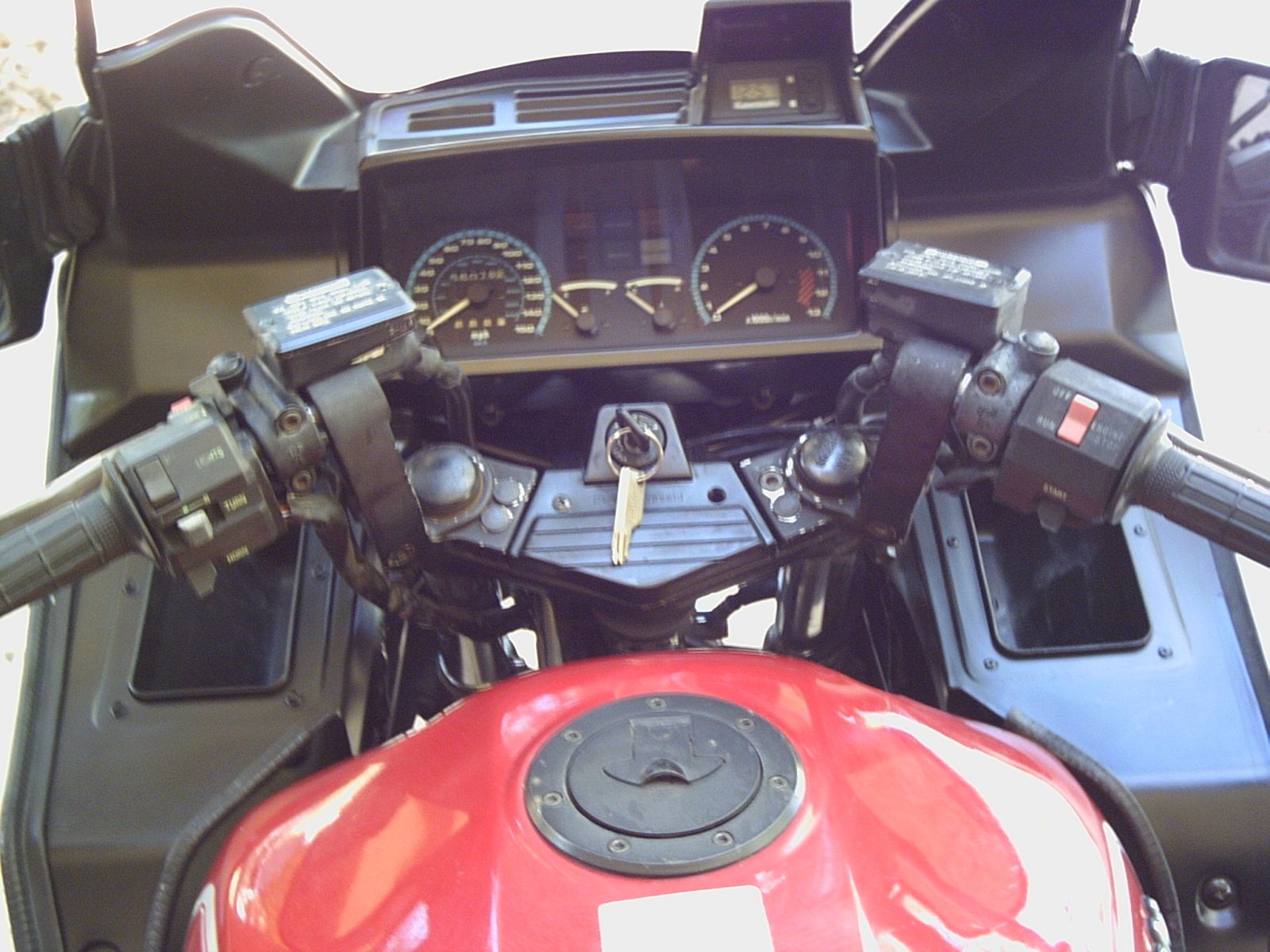

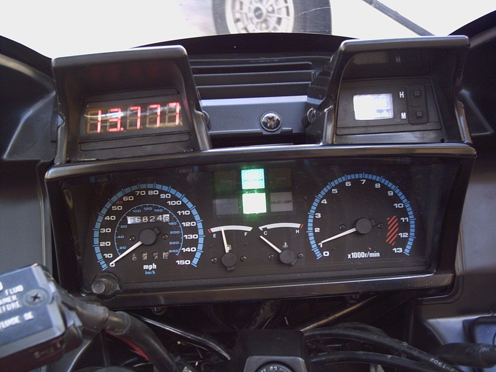

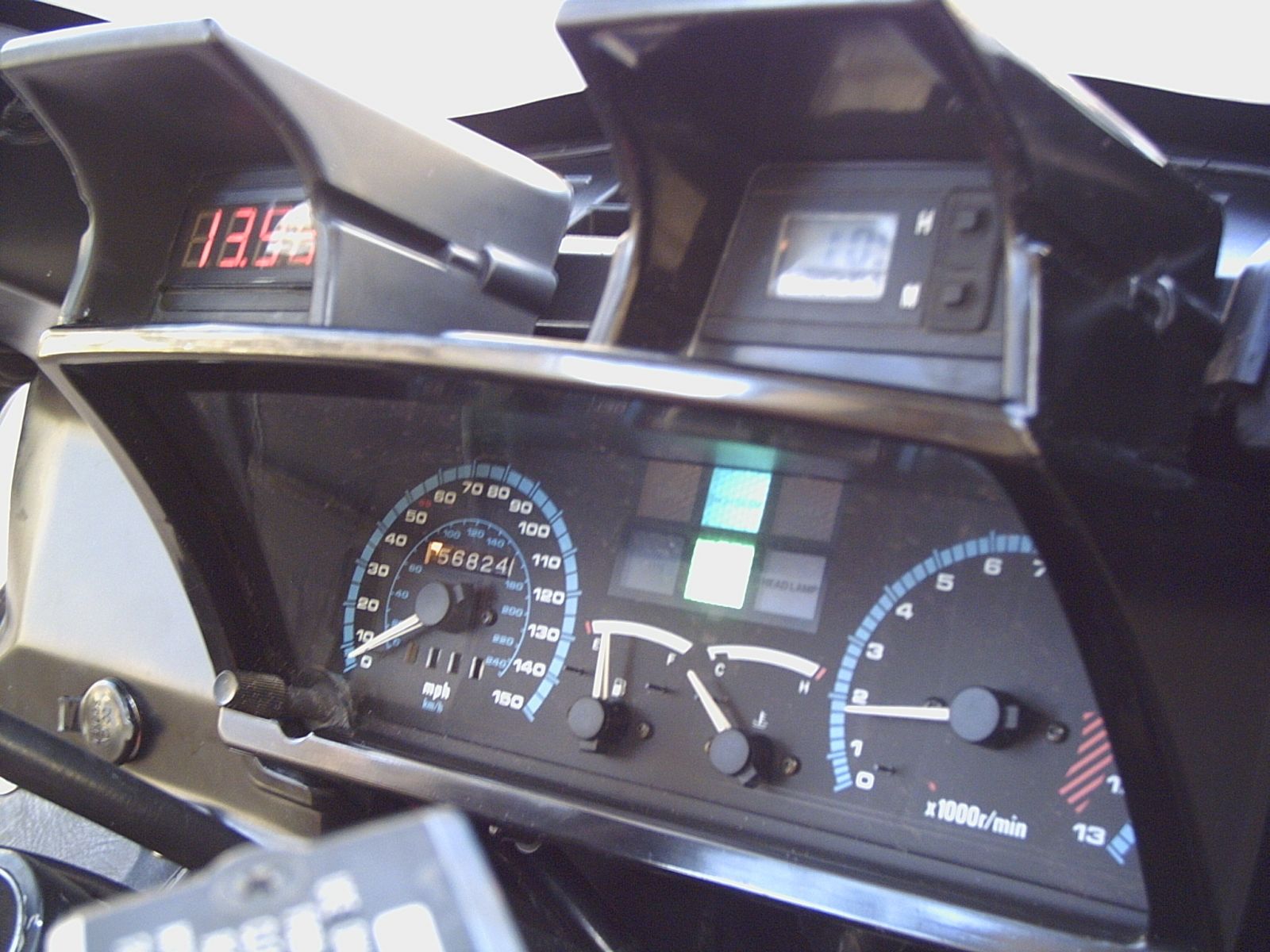

Well the Volt Meter I ordered showed up the other day, and I got around to fitting it. Since I had replace my gauge cluster, because of broken plastic when I got the bike. I had a Spare Clock/ housing. This area I cut from the broken Gauge surround, then fitting it to the shape of the Top of trim panel, I glued it on to it. Cutting and filing on the Clock Insert area, I was able to fit the Digital Panel Volt Meter in the same area. So here is a few shots of the Dash, without the additional Gauge, the Dash was Off on 1 side. Only the Clock, on the Right. looks a bit strange like it needed something on the Left. Oh and I get a 13.8- 14V while riding.

looking good there

That worked out very well! Does it dim at night or not?

Well no, there is no dimming at present. But that would be easy enough to add, to all of the dash lights if wanted. I've got a nice POT already from a RX7 that would give adjust-ability. But so far I was out to dusk yesterday, helped a fellow rider who had a flat tire, LED was not a problem.
