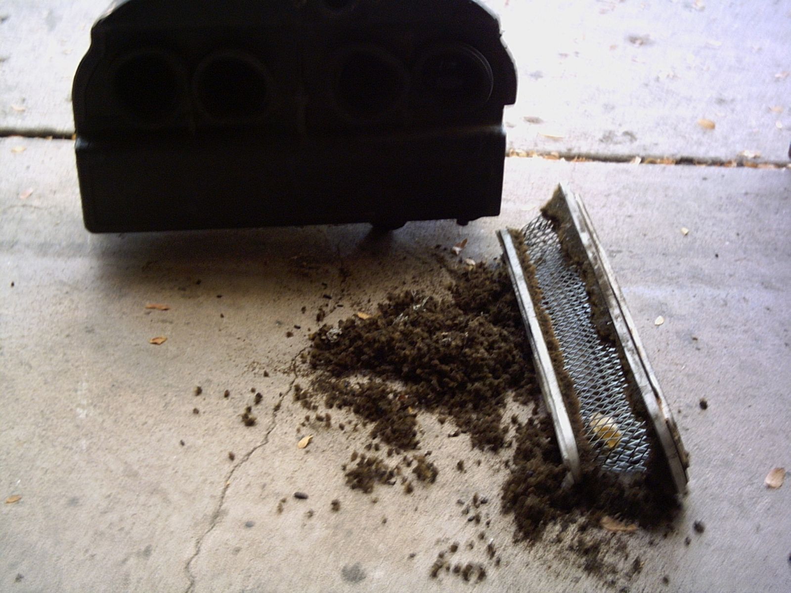

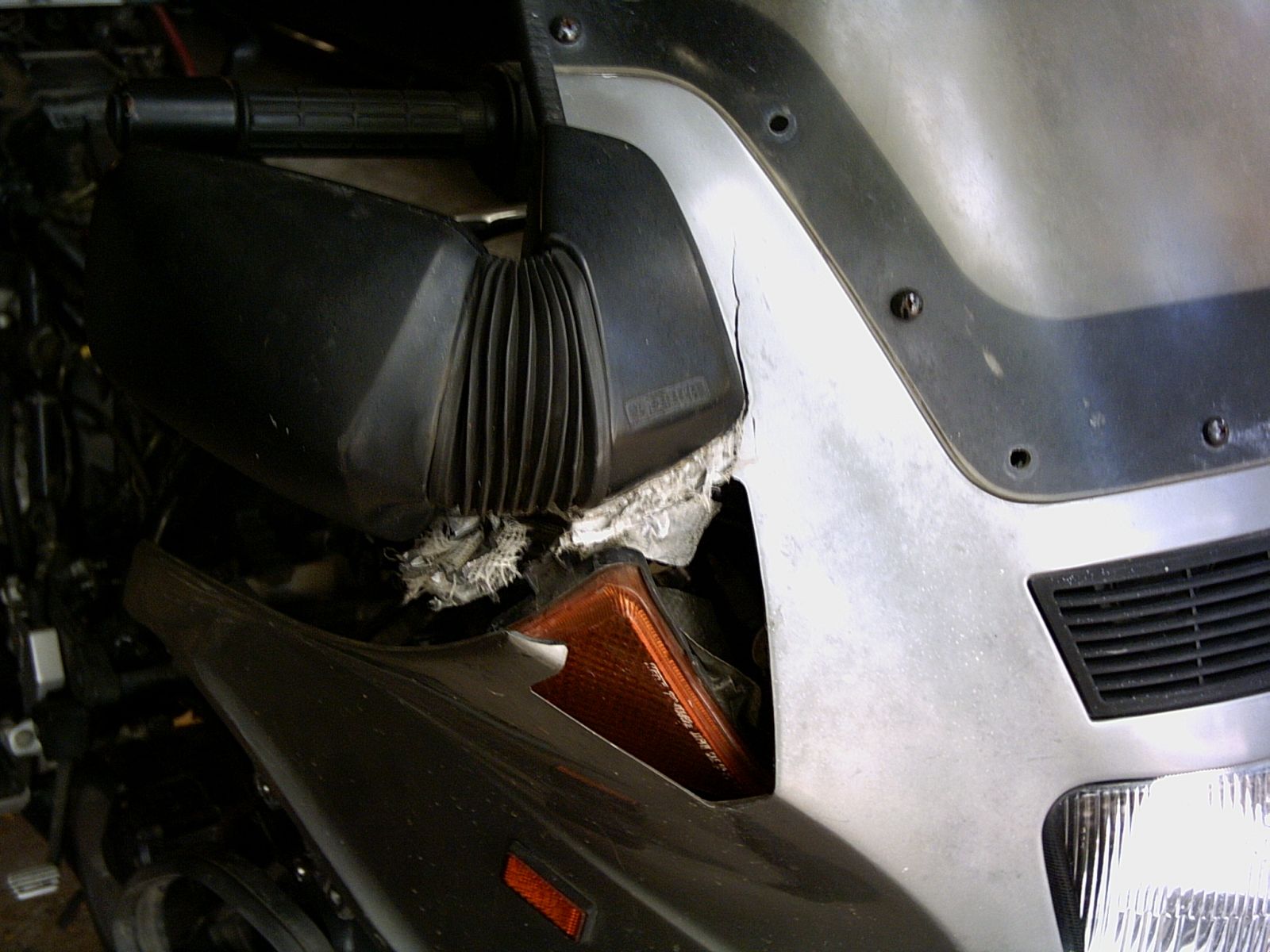

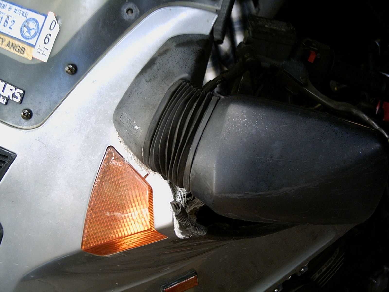

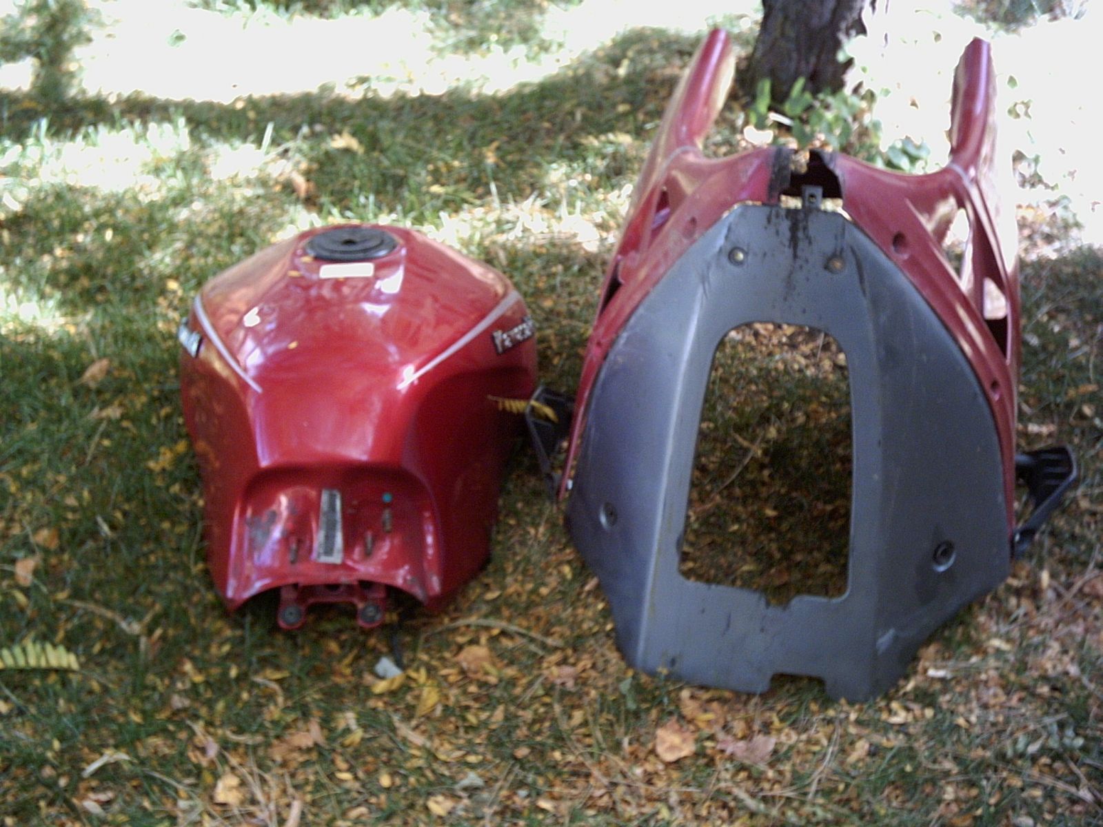

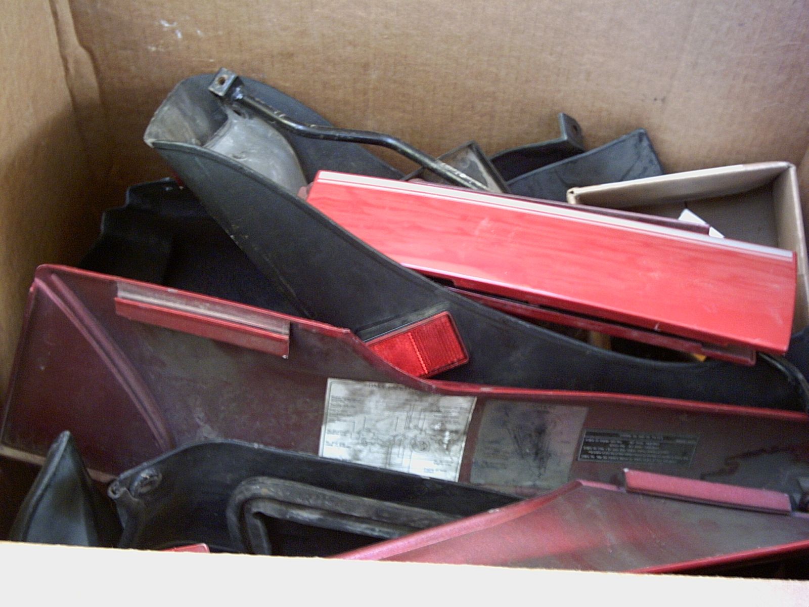

Well time for the first parts order so I can get it going anyway. Shouldn't be to bad until I get into the cosmetics. Probably drop $500 there alone, almost worth having a parts bike with good plastic & Tank. Some one dented up this one a bit, and would need fixing/ painting. Cost of paint these days, I might see about a used one.
$200 for the first order, Air boots and filter, Carb bowl O-Rings, Fork Seals & Fluid, RF turn signal assy. Stupid Keihen Carbs, but they don't look to bad, pretty clean from sitting. Someone must have drained the bowls. Tank was another story, Yuk. :sick:

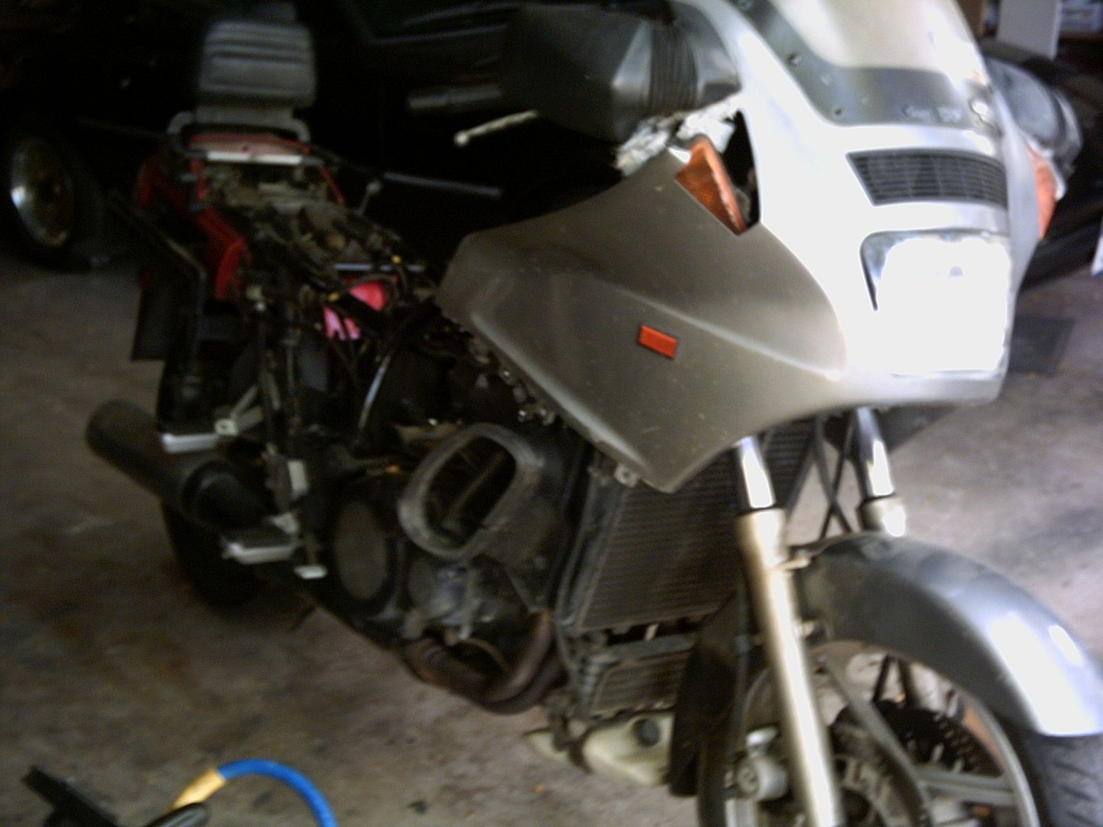

So here is some first Pic's before any cleaning or washing, with a box of plastic parts.

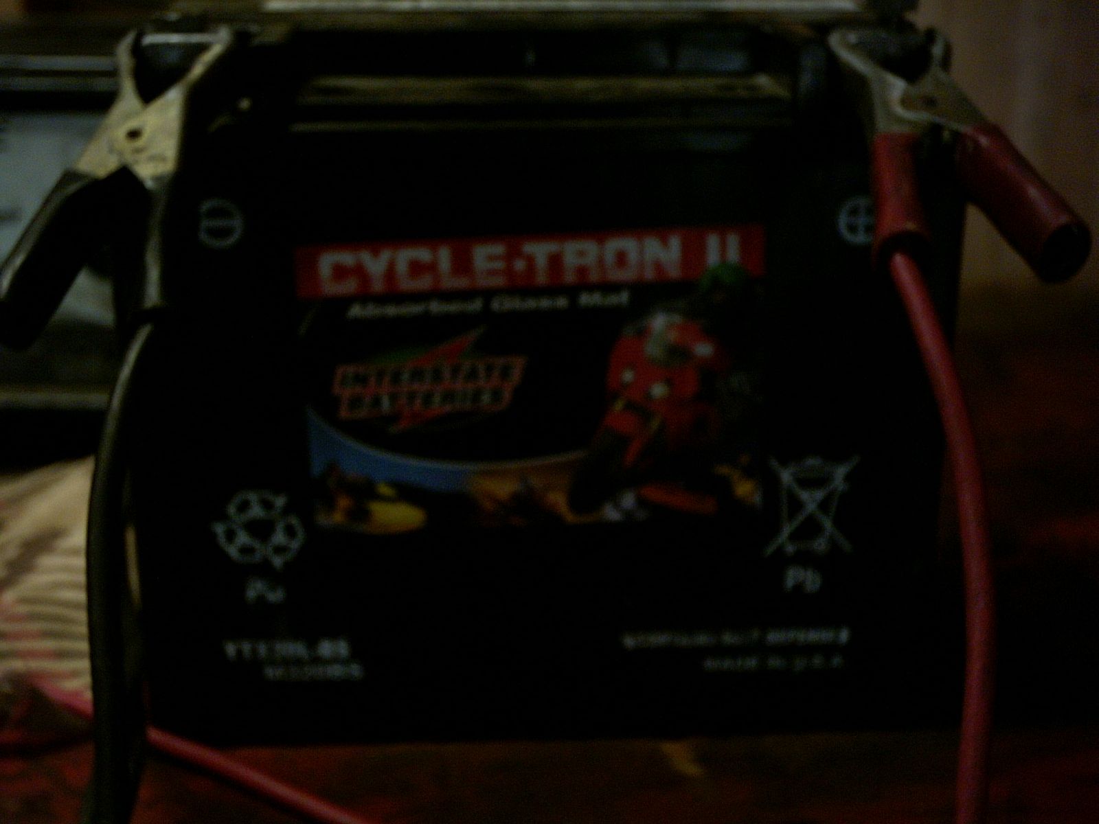

To Bad it is no good, Interstate sells this AGM for $130!!!!!

Well so far I have found it easy to work on, valve adjustment was a piece of cake, no shims just screws and lock nuts. All the service points are accessible, Air filter comes right out, carbs were pretty easy to remove even with the stiff boots. Although I read there should be no Drains for the Forks, they are there. So that should be easy, seals and fluid. The worst part of the deal so far has been all this crap plastic, broken cracked etc. Then the fuel tank needs a redo, dented and paint issues. I'll get it going and then do cosmetics. Oh and I hate the stupid Keihen carbs, they should have either stayed with Mikuni, or gone with Injection. Injection would have been very nice.

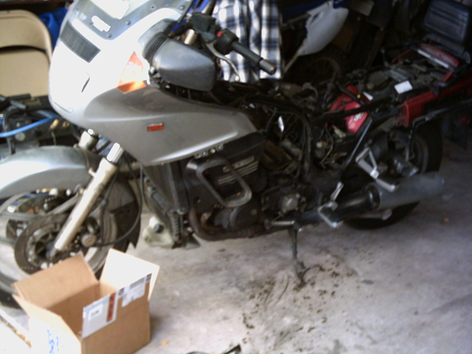

So a bit of progress as I wait for parts. Went to HF ie China Tools and got a compression tester kit, as it has the small plug adapter. Then checking I got solid but low readings, so I tried my gauge, and up it came. 130-140 on all 4 without it being run, for a couple years. Remember I'm at 6200' which will lower readings.
That China Tool gauge was 20lbs lower. Don't trust it. It will be returned for refund. www.harborfreight.com/compression-test-kit-66216.html
Working on the seat cover, $10 for Good Marine Vinyl.
There's a guy on CL who is parting one out, going on the weekend to look and see whats better than mine, etc. The AGM battery has taken charge but seems weak, I'll keep the trickle on it and check some more. Other than the plastic, most of the bike looks like it will be OK. Can't wait to fire it. Boots and Air filter early next week.

Snowed here today. So I got the seat recovered, that looks pretty good for the contour. With no seams all one piece of fabric, I never got to use my 62 Singer Industrial machine, and it is hard to get the material tight with the steep up slope at the front. Then the base is plastic, so Staples and glue hood it in place on the underside. Bought the best hand Arrow gun at home-depot, and it sinks about 1/2 of them. You have to pull some back out and try again. A pneumatic one would be better for this. Took off the saddlebags and mocked up the side body panels, and replaced the broken rear fender, again plastic. Glued up some cracks in the front fender, and the front fairing. Then tried out the cheap HF plastic welder/ soldering Iron. Between the glue, and the plastic weld, those cracks are pretty strong. Then once the bike is going well, I can think about doing all the prep for painting. Looks like Kawasaki 603 Candy Persimmon Red is an expensive redo, back to oem. So I'll cheat and do a cheaper paint when the time comes. The Tank is the worst of it as it has several large dents in it. No pictures today, with the cold the garage door is down, not much light in there for pictures.
Still waiting on parts, looks like Wednesday, then maybe I can get it running.

That AGM battery is better, and starts it right up, but there is little reserve in it. Kill the Ignition and do several cranks and dead. Looks like a new one is in order.
