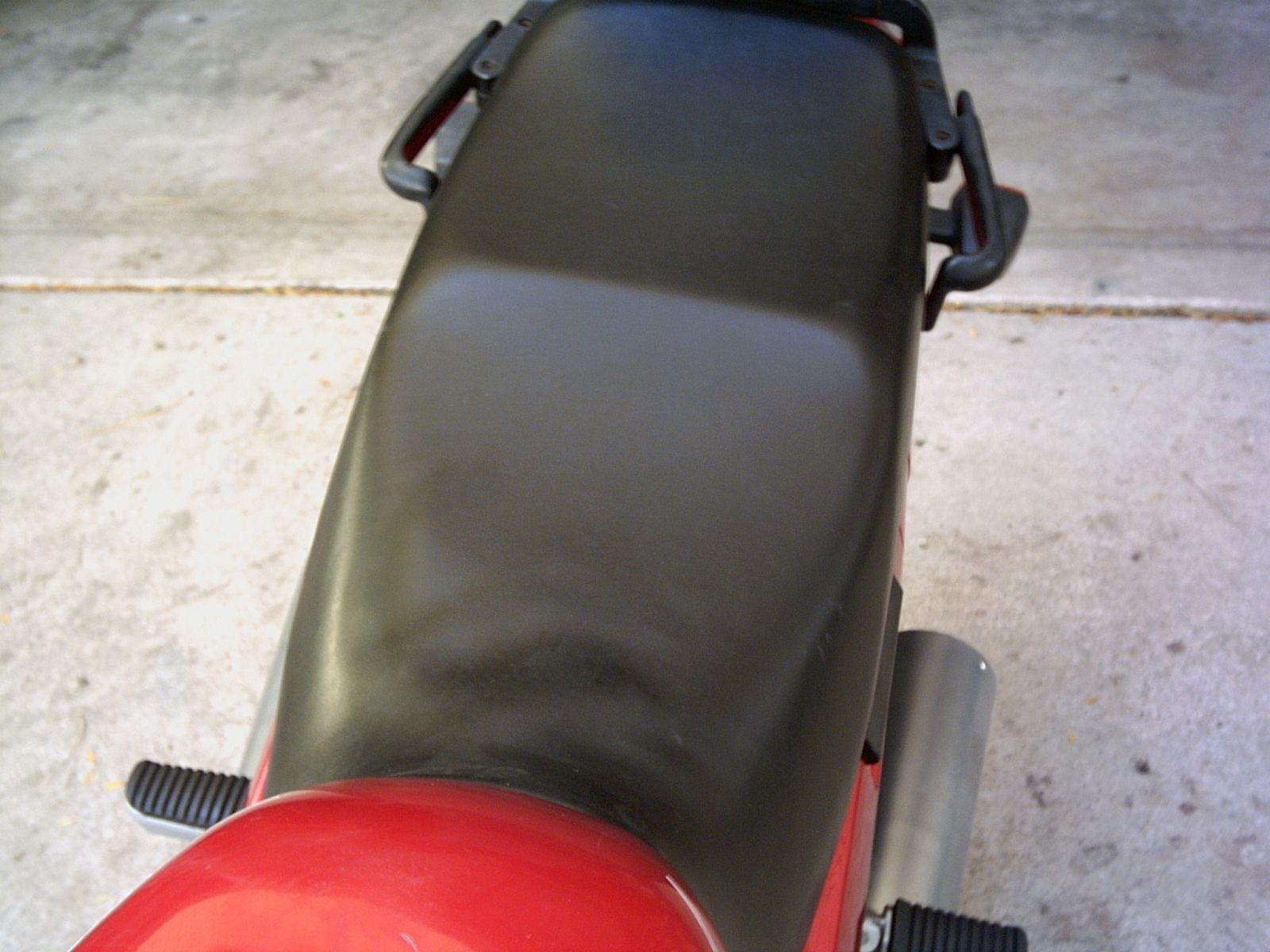

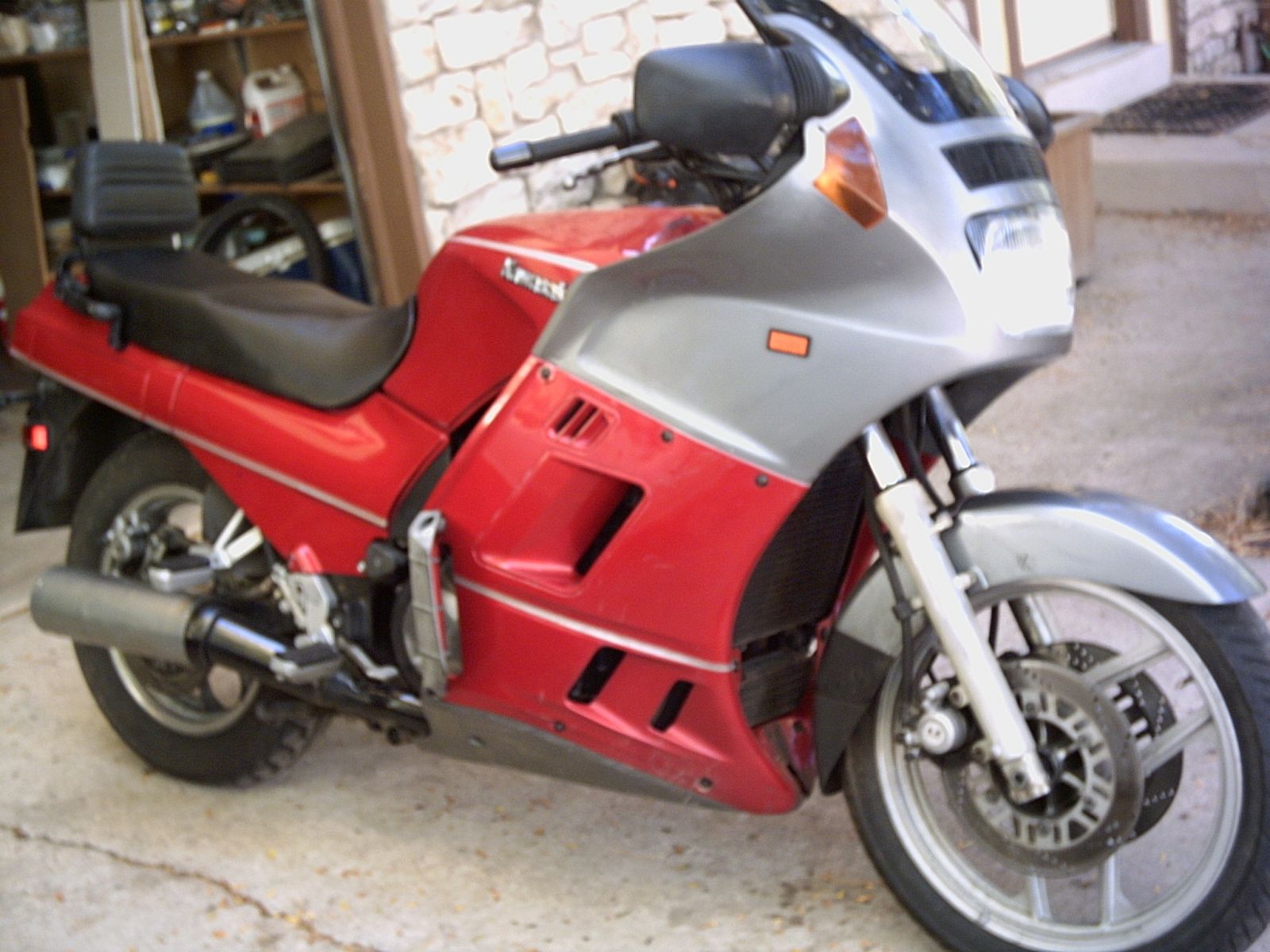

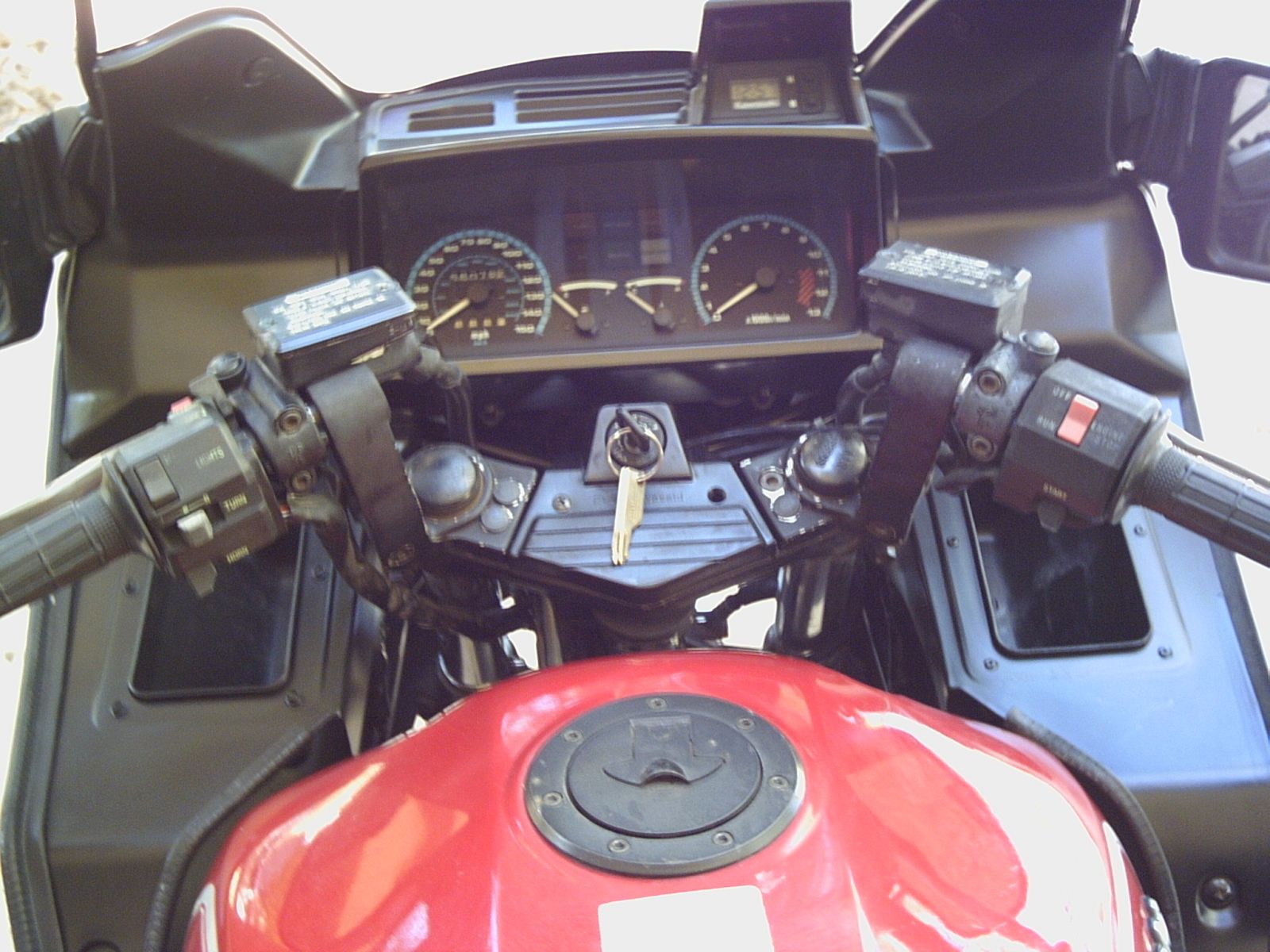

Had to get into the wiring today, as I had Ignition and turn signals but no other lights or horn. These are known for issues with the Junction Block, so I started there. But I had no power coming into the Junction on the "Famous" brown Wire out of the Ignition switch. So the relay in the Junction Block would not latch. Pulled the switch and tested, no contact from White to Brown at Key On. Dissembled and found very dirty contact on the Brown terminal. White comes from the Main Fuse to Feed the switch. Cleaned it all up, reassembled and then tested again. All good, slap it back in and all working.
Then my Gauge Cluster from the Feebay Seller turned up. All ok except for the Speckles of dried on white paint everywhere. That took a while to get cleaned up so it looks decent.
Going over the bike, missing bolts, a couple broken, several loose, cables miss- routed, wiring miss- routed, did I leave anything out???? :laugh:
Got the wrong front turn signal from Cheapcycleparts, so out came the plastic welder to put the mounting ears/ tabs back on the old one. Otherwise it is in good shape.

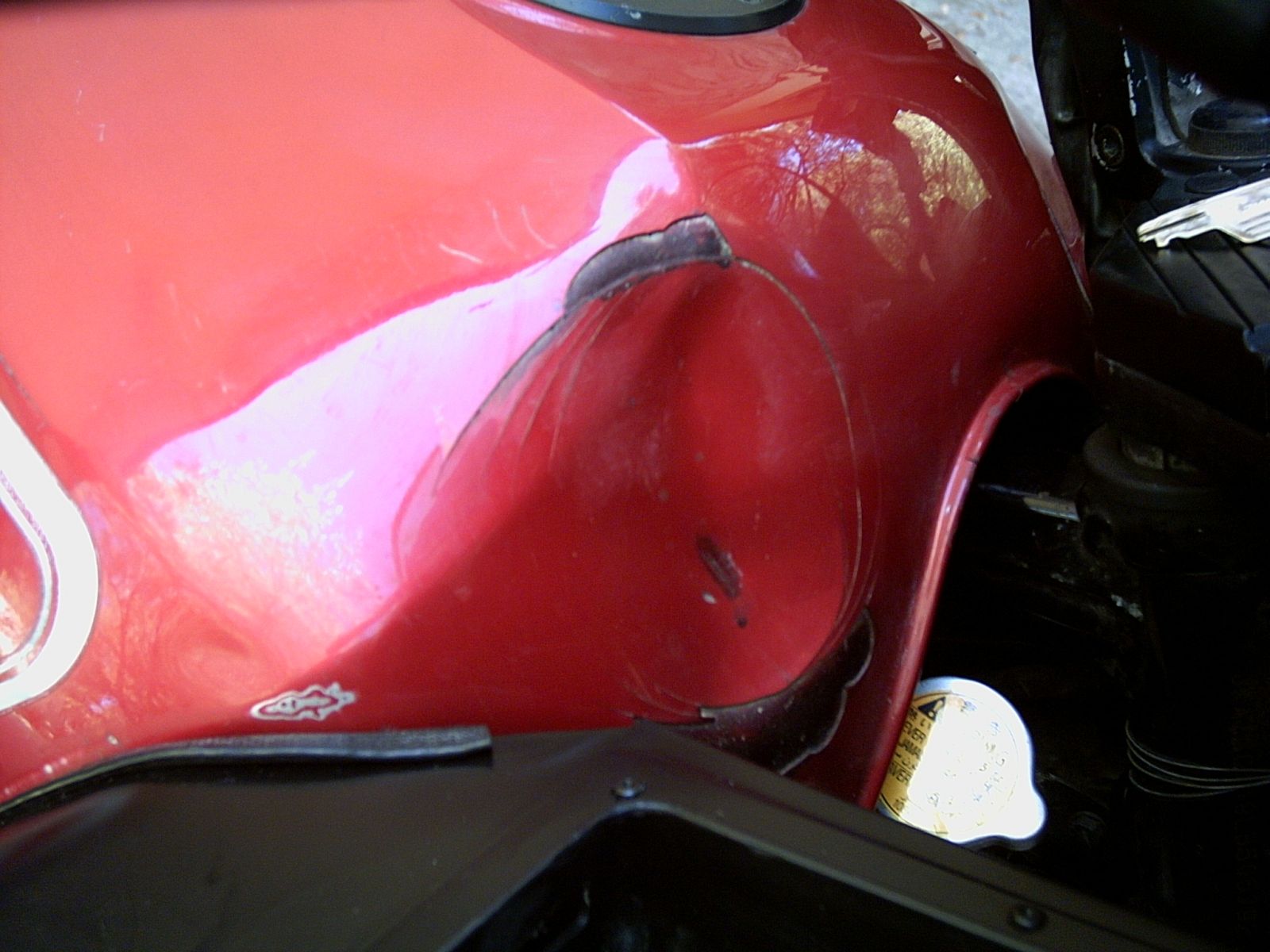

Good find!Can't believe it was that cheap!
I had an '06 until I totaled it in '08, well it was the damn plastic that did that, not structural damage to the frame or engine. Would have repaired it but the insurance paid me all but $300 I had in it and included my helmet, basically a free ride for 2 years!
I might have some accessories from it like the backrest/luggage rack, FSM, tank bra, handlebar risers and peg lowers.. maybe some other stuff, have to go up on the mezz in the shop and look. Let me know if you are interested.
That coolant bottle and you will never see each other except for the scheduled fluid changes once you get any neglected connection issues solved. How did you like getting that valve cover out? Fun huh?! One way in and one way out.

Yeah I had a pattern template for doing that mod to the covers, have to look for it too.
Easy? Maybe they made a change from '90 to '06 but it didn't come out easy on mine and getting it nad the gasket back in there was no pic-nick either.

The right bag is the one I destroyed in the high side and my tank had a softball sized dent in it too.

A soft ball size dent, maybe a lot better than mine. Its kinda whacked.

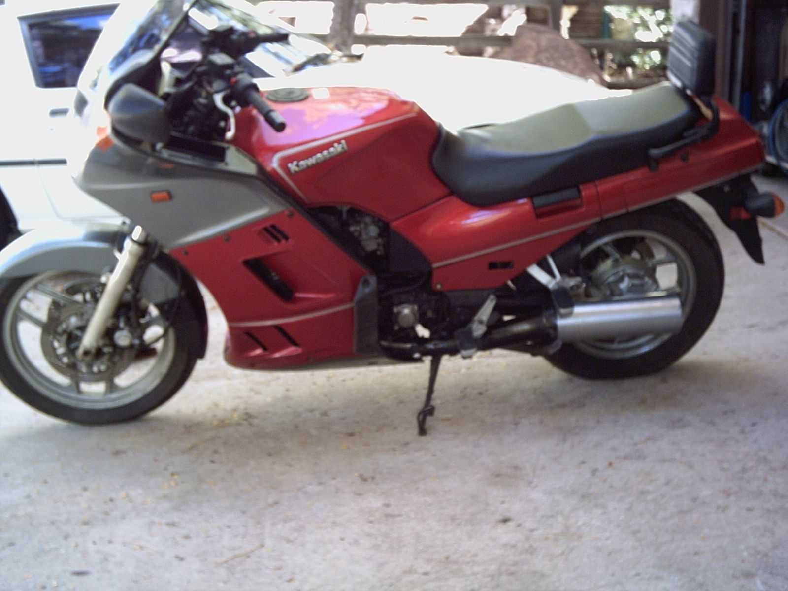

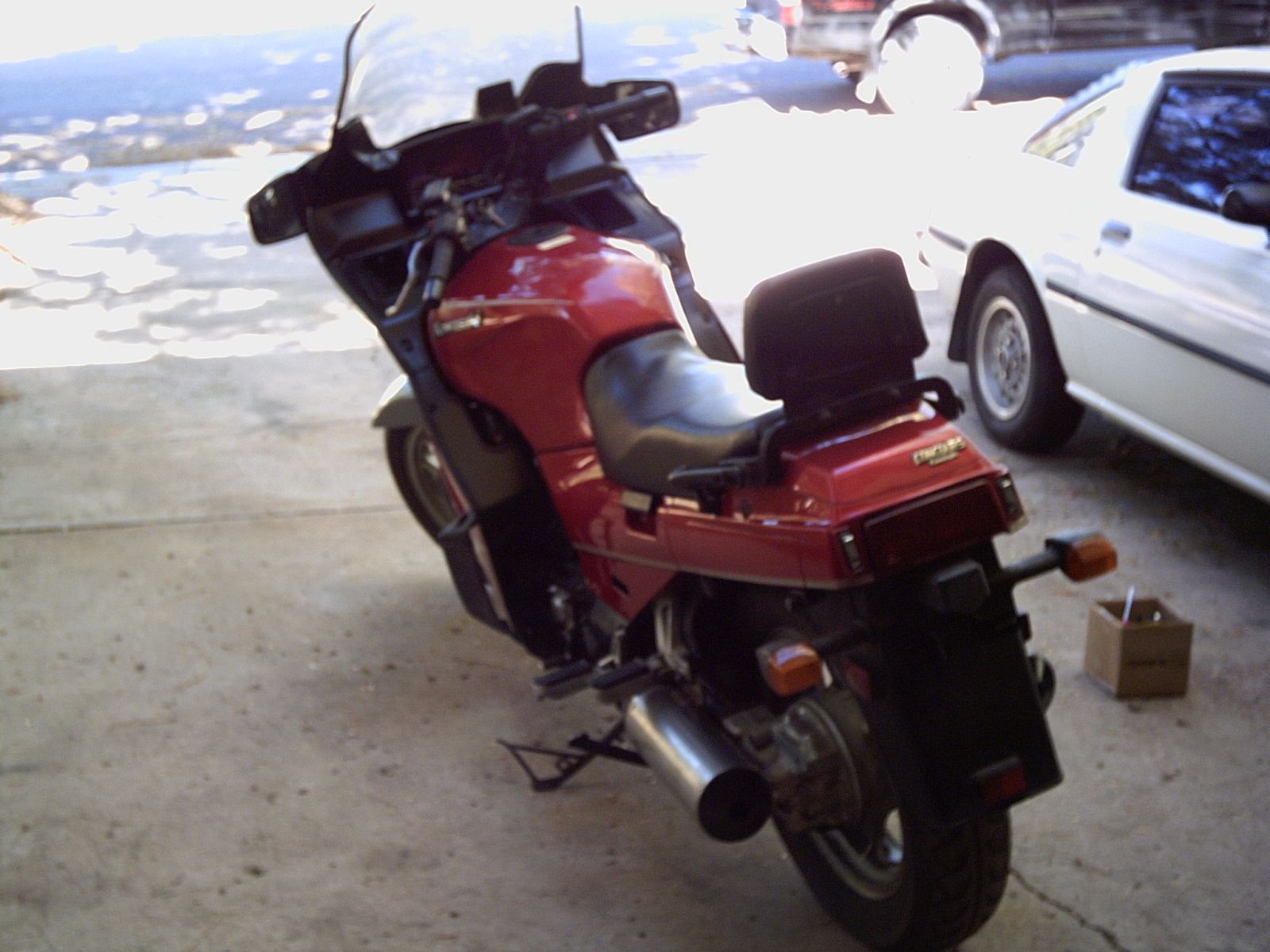

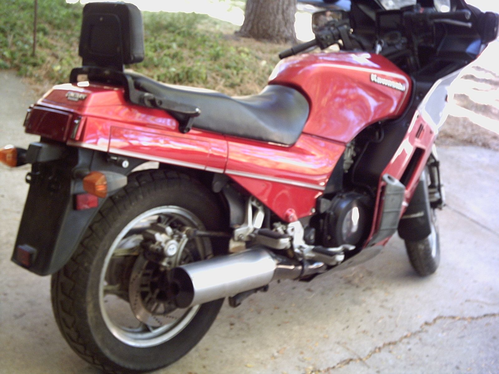

Here is some more photos of the bike, definitely coming along, but needs the rest of the cosmetics and suspension work. Sitting here waiting on the Mail and my Coolant Tank to relocate.

Not really my back has been absolutely killing me.
But I did the Proper thing and went to DMV all legit for a spin. Mail did not deliver my Bottle, so Tomorrow? I'll have to let the overflow out into the air for a quick spin.
Lots to do yet, but the weather has come good and I want to see what else it might need. Also what it rides like. I'll do a 100mi or so Tomorrow to get the feel of it.
Still got to get a tank or re-do this one, then I could re-paint to match or re-paint all the bike. Also i need a right Saddle Bag, the Inner Case is broken pretty bad. Someone glued it once and did a very poor job, metal plate and self taping screws.
But hey not bad for about $600 including the DMV fees.
