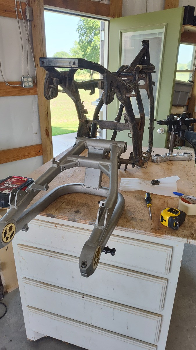

Both the ZRX1200 and 1100 swingarms need to be narrowed to fit the frame. The good news is that the swingarm bearings sit quite a long way inside the pivot area, which means the bearing location/seats can remain unchanged. The ZRX pivot bolt is thicker (20mm I think) compared to the 16mm of the Z1000/Z650. I use top hat spacers to make up the difference.

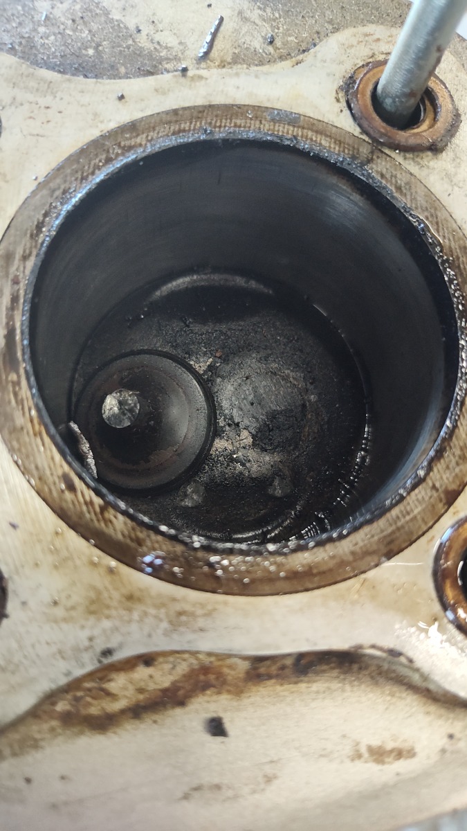

Well I figured that I need to cut 3/16" off the ZRX swinger. I will have my brother do that and make the bushings for the KZ through bolt. Ordered my bearing kit from Allballs for the ZRX front end so making a little progress . I then took the head off the 81 J model engine and discovered it had a broken exhaust valve but doesn't look like it did too much damage. I will be sending that out for headwork.

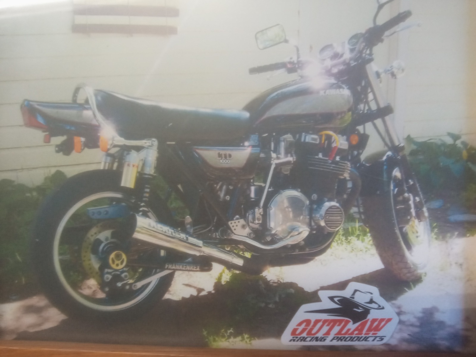

Years ago I purchased a Z1900 roller only ZRX front and rear swap from Jeff Saunders from the original Z1 Enterprises (they were right in my back yard). Jeff spent some serious time/dollars on the roling chasis but just did not have the time to finish. I built a KZ1200 engine and completed the bike.  One thing I did was get rid of the wider front ZRX fender and installed a smaller more contured one. I will have to find the pictures.
