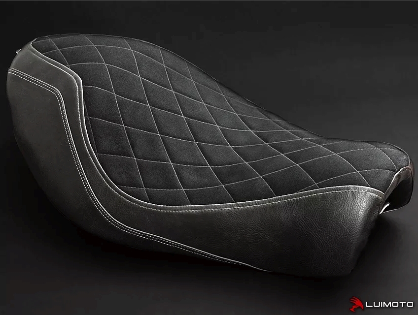

I would love to see a gray coloured seat cover complimented with your bike color contrast diamont stitching.like this one..

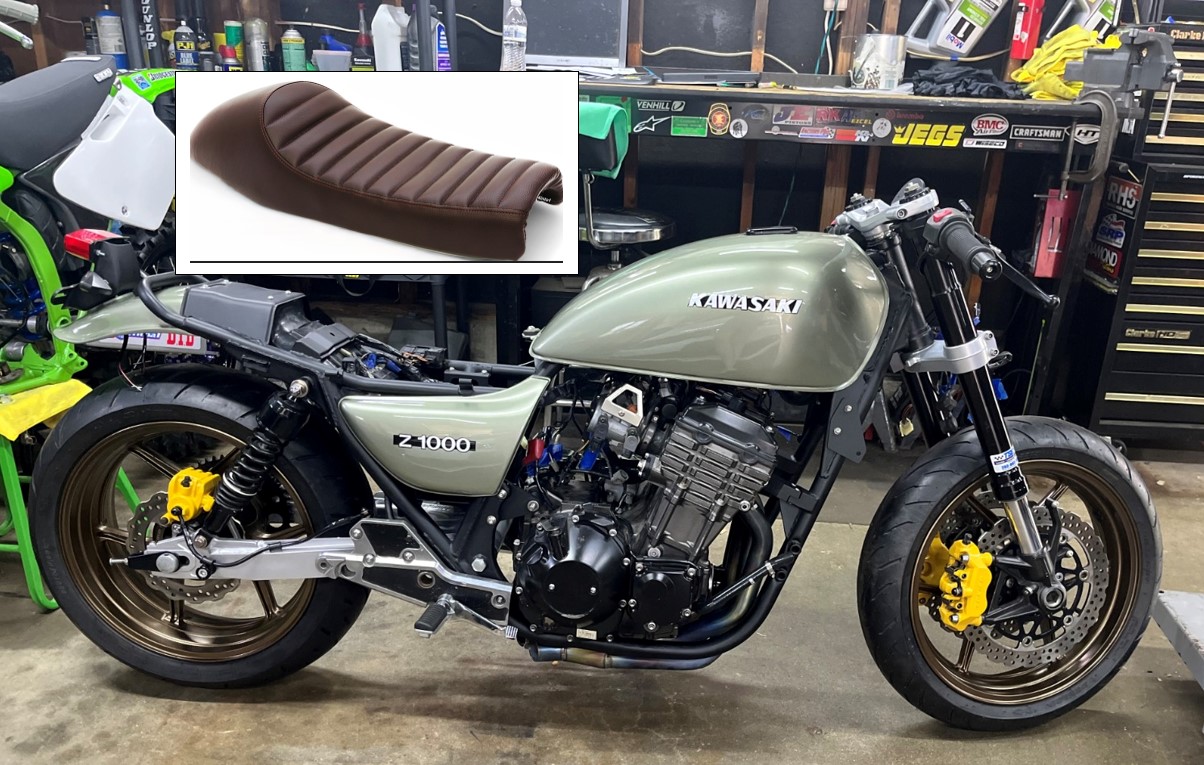

haha, didnt realize seat color was so polarizing!
i'm sold on brown though, but i have the stock seat with black cover i can throw on for a photo op.
heres the seat i was thinking of....

Brown seats draw almost as many opposing views as a good "oil" debate
I think that is dark enough to work with the colour scheme(I went with black on my build as I still haven't decided what the end paint scheme will be

haha it would seem that way....
i've had really good experience with a shop in Vietnam that makes reproduction seats, complete for around $250 shipped.

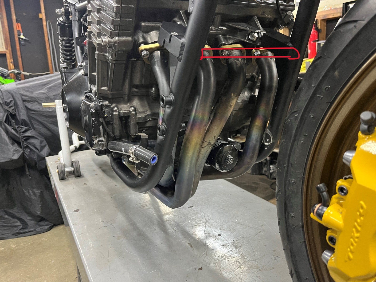

Have you come up with a resolution to the cross tube you removed from the frame ? (if not the resultant flex may break the engine mounts off of the motor)
- jowek70
- Posts: 181
- Thanks: 46
Re: 82 kz1000 ground up build
20 Jun 2024 07:23
once i have the exhaust in place i'm going to see what i can do about putting the same tube back in or a smaller diameter solid shaft and weld it in place.
- Posts: 6874
- Thanks: 4326
20 Jun 2024 09:30Could you put it back a little higher just above the headers ?once i have the exhaust in place i'm going to see what i can do about putting the same tube back in or a smaller diameter solid shaft and weld it in place.
