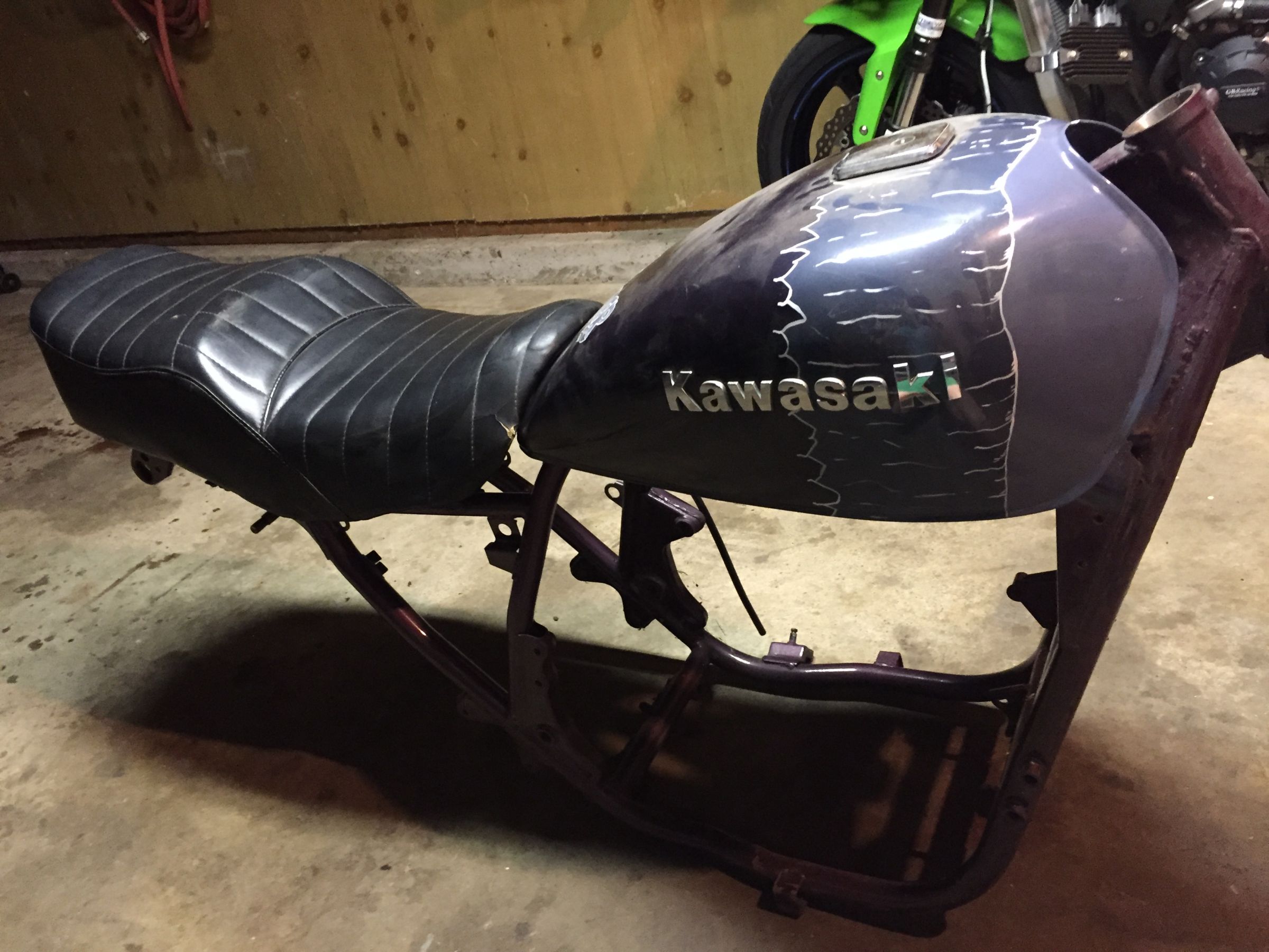

Picked up a frame for 82 kz1000
Looking to do a 04/05 zx10 front end and wheels with gs1100 swingarm
All hard parts powder coated satin black
Looking into using 03/04 z1000 engine and wiring
Hoping to have it done by spring
So far I have stem bearings and picked up a new seat cover
Bike will use stock tank and body work with aftermarket headlight and taillight

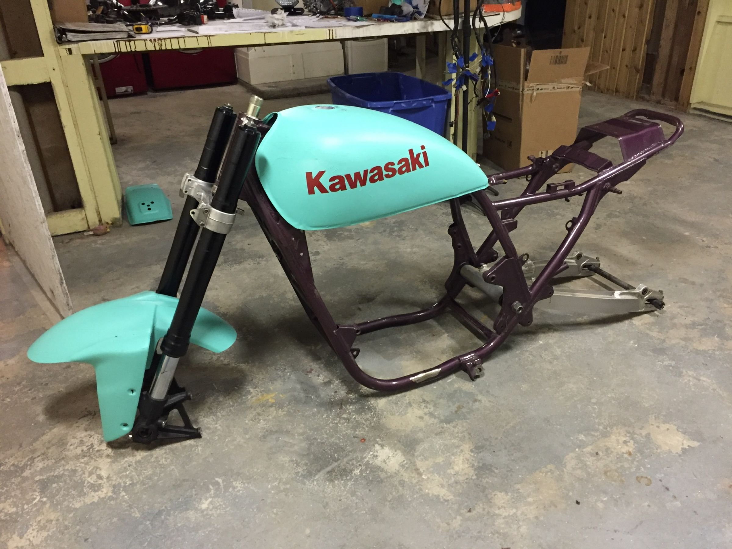

Matte Tiffany blue vinyl wrap with gloss red graphics

Parts will be here for my rear end next week and then I need to find an engine
Sorting out wiring from z1000 main harness to zx6 handle bar switches
Going pretty well, Kawasaki used same color wire for same functions so I'll just have to get proper connectors from cycleterminal.com
Should have a rolling chassis by end of this year
I'll get pics up when I have more to show
Going with the 05-06 zx6 gunmetal color wheels
Should look sharp against the bike colors
