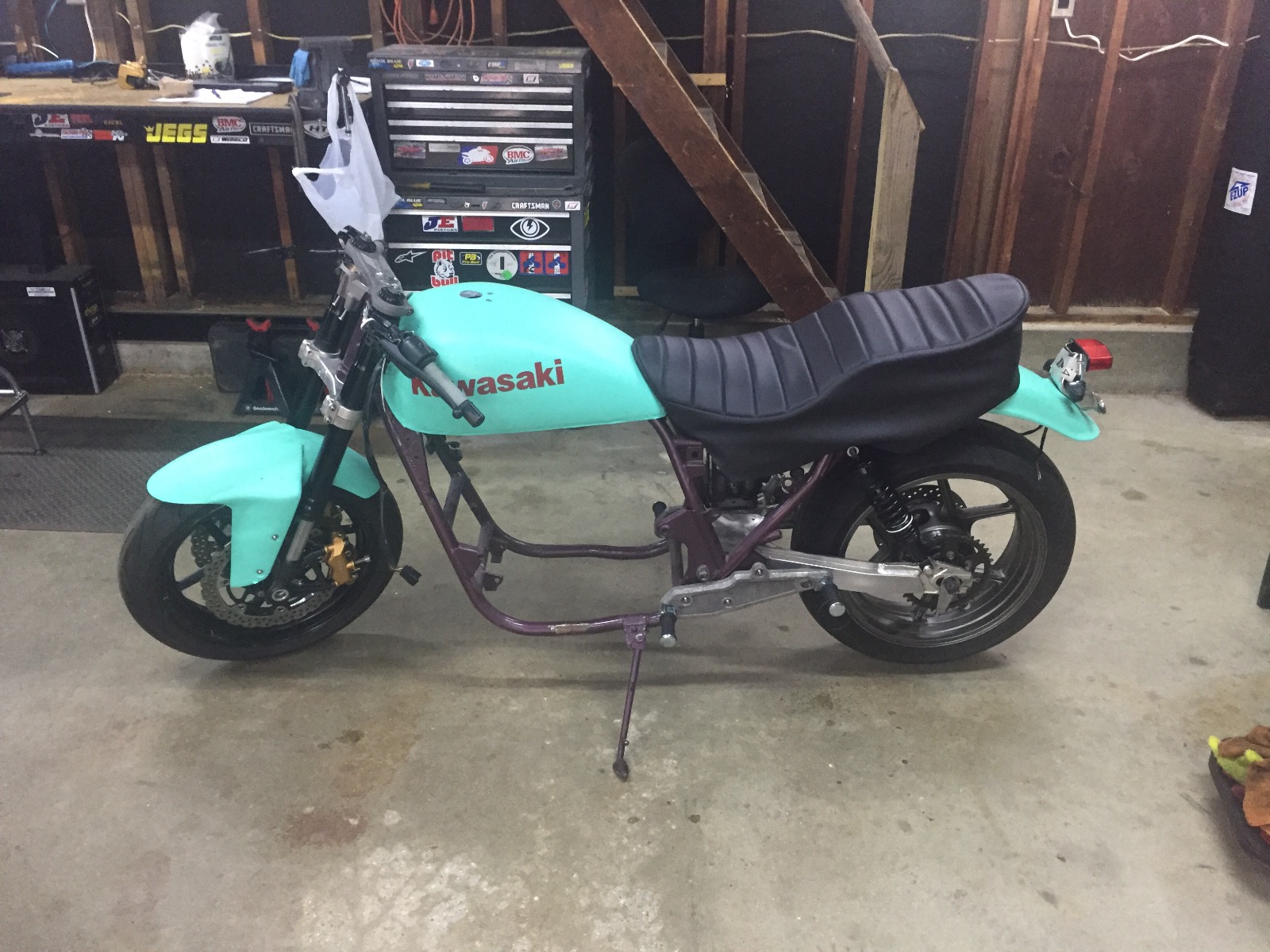

Re: 82 kz1000 ground up build
28 Sep 2018 19:56
Been a bit but got some things sorted out
Waiting for rear wheel spacers from shop
Got front end sorted out and nearing rear ended completion
Still on the lookout for a donor z1000 engine but have started sorting out most of the electrical
Builds coming along well and it’s fun to roll around on the chassis
Pretty good riding position and decent ergonomics for a Frankenstein build
