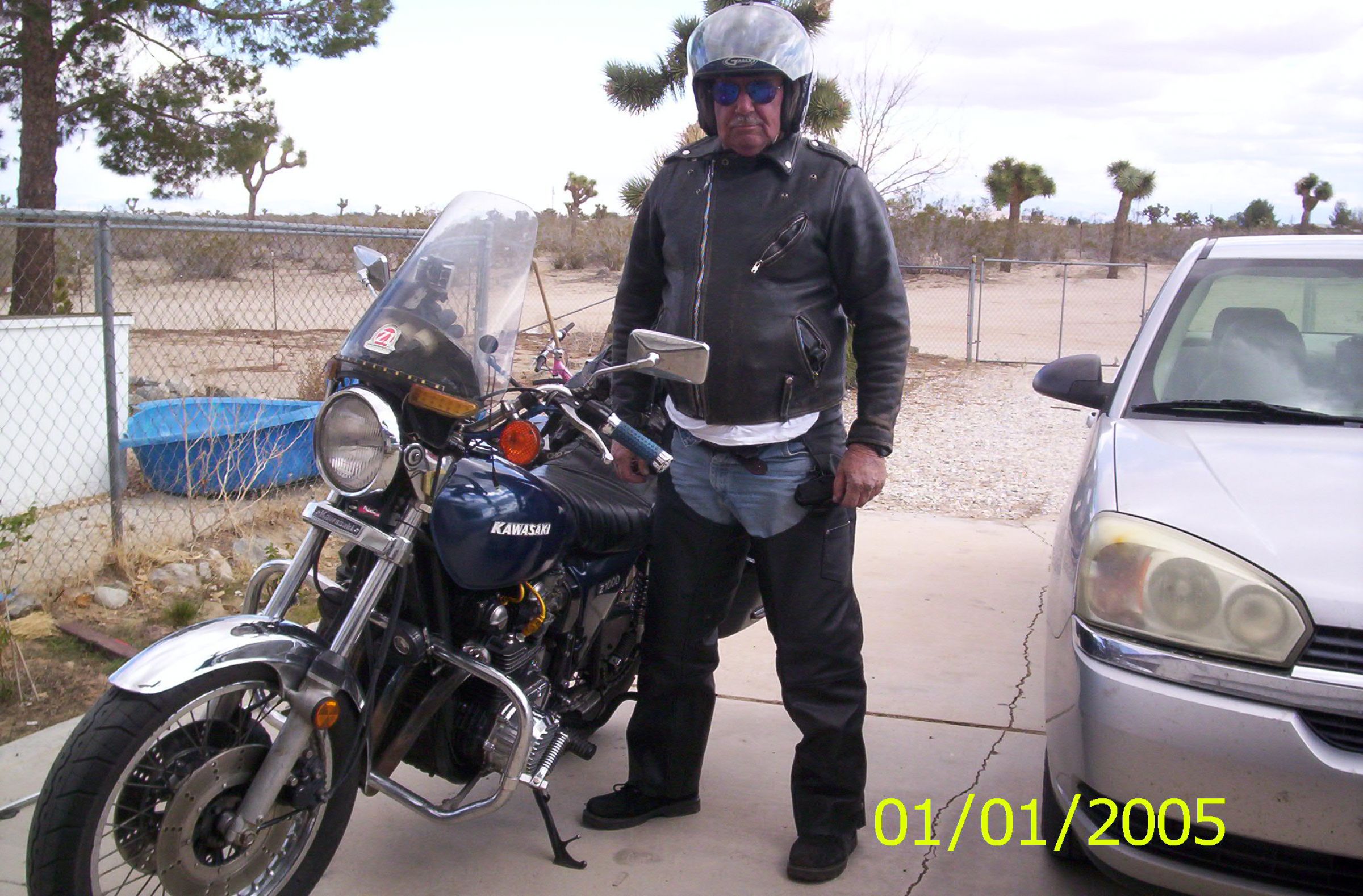

Was able to dig up a few pics, not a ton but at least some to make this thread more visually interesting haha. Currently the bike lives in Pops' garage which is about 30 min away, heading there later this week when my grips and bar ends arrive to install them and will take pics of the carbs all sparkly and clean and how the bike is sitting now along with the new tank and old tank. Until then hope y'all can get by with these.... a few extra shots of the bike and my first rid eon it, as well as some of the new moto sexy gear that I snagged over the past couple months, Icon leather jacket with full D3O armor compliment, HJC helmet ($35 new on Craigslist woot! just missing the silver mirror face shield), Sidi Vertigo boots ($30 on craigslist again love it!) and new Ogio backpack to use specifically on the bike when traveling.
EDIT: Apparently I can't upload directly from my computer, putting them in Photobucket then trying a different way
How the GPz sat last fall before she was put away for winter in CO...
