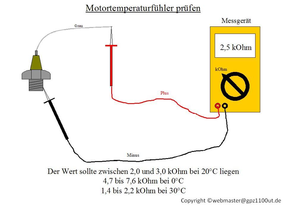

DFI/TPS wiring
Leerlaufwiderstand = 2,1 - 4,2 kOhm @ idle
Vollgasstellung = 1,0 - 2,0 kOhm @ full throttle
Pin 1 + 3 = 3,3 - 6,6 kOhm @ every position between idle and full throttle
Air temp sensor
Engine temp sensor
DFI wiring diagram
kzrider.com/forum/4-electrical/608343-dy...1984?start=20#783110

What values you got at the TPS/Air/Engine temp sensors?
A broken wire in the TPS resistor potentiometer is PITA.

the polarity of the tps wires are correct, and the tps resistance values are ok at idle and close at max. engine temp resistance is a bit low and the air is open..... dead. if i had a 5k resistor, i would try it, but i don't. i ordered a kit with a bunch of reverse polarity thermistors. maybe one will work. we will see.

turns out, i was reading the air sensor resistance on the wrong connector. the sensor is ok. so all the sensors are within limits.
setting the wires on the tps to match the above diagram makes it run super rich. blue / white and blue / red need to be reversed for it to run. the only symptom i get is the tach jumps around and it runs rough when it is about 2k rpm.
