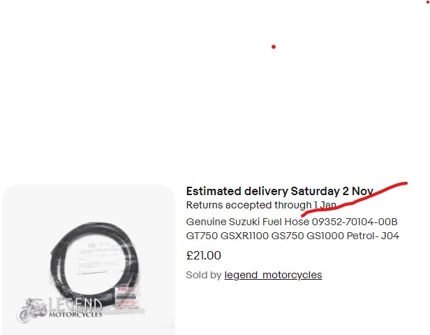

30 Oct 2024 15:50Suzuki PN 09352-70104-00B. 2000mm = 78" worth of fuel line. Great stuff. It's thin and stretchy. No need for a clamp.Size 7 X 10.2 mm. Best quality I have found, and a good price to boot.
japan.webike.net/products/24408119.html
The following user(s) said Thank You: H1Vindicator, asphalt900, sf4t7, Scirocco, Wookie58

Ditto Ed's recommendation on the Suzuki fuel hose! One thing to remember when using it though. Because of the thin-wall construction, make you're routing sweeps as smooth as possible. No tight angles or the hose will collapse on itself shutting off petrol flow. Texas, have been considering purchasing some stuff, decal set, from WEBIKE. Have You gotten stuff from them before??

31 Oct 2024 09:10 - 31 Oct 2024 09:12It states its a water drain hose, not fuel??? Its also $14 shipping to the us......for hose. Yikes.Size 7 X 10.2 mm. Best quality I have found, and a good price to boot.

31 Oct 2024 10:01You can order that PN from any Suzuki dealership.It states its a water drain hose, not fuel??? Its also $14 shipping to the us......for hose. Yikes.Size 7 X 10.2 mm. Best quality I have found, and a good price to boot.

31 Oct 2024 15:39Yes, it is fuel line in spite of what it says there. Shipping from Japan can be pricey, but most of the time I have found that the total is still less than getting stuff domestically. Definitely check your local dealer and places like Partzilla and Denis Kirk.It states it's a water drain hose, not fuel??? It's also $14 shipping to the us......for hose. Yikes.Size 7 X 10.2 mm. Best quality I have found, and a good price to boot.
