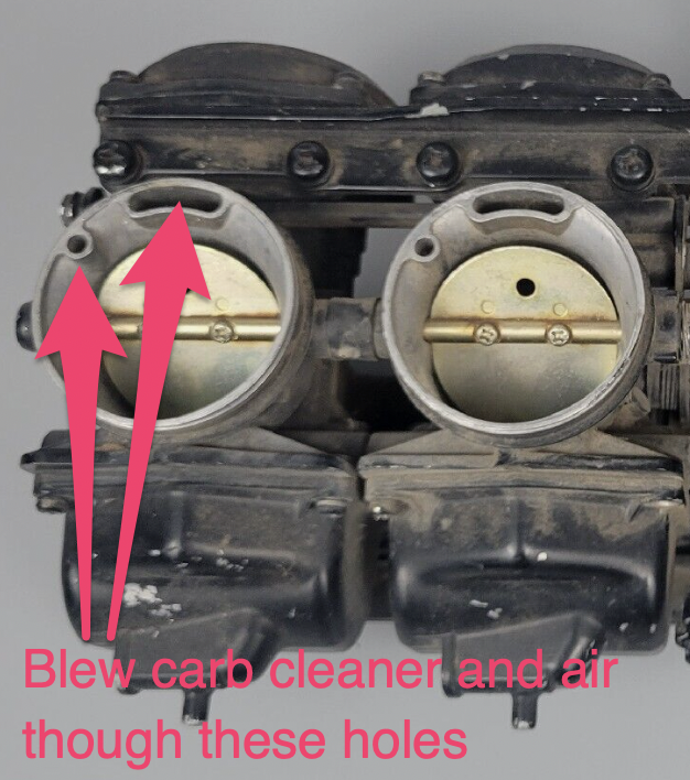

I pulled the carbs this w/end and just slightly oped up the pilot jets with some mini drill bits (maybe 001 or 002") and also blew carb cleaner and air through the rear holes (see image below). I was mostly just spitballing as I'm at a bit of a loss at this point. I reinstalled the carbs and a couple of rotations of the starter yielded nothing but starter wining. Again, just spit-balling I placed my hand over a couple of the carb rear openings (pods removed) and with a couple of rotations of the started I got a couple of pops. I tried this again, and it rumbled to life. Not sure that that tells me much other than a lean condition, but I think we already know that so :shrug

Randomly spraying chemicals and high pressure air into places without knowing where it goes can cause more damage. I hope you have not destroyed the slide diaphragms. They are fragile, and may not be replaceable.

Just wanted to button this thread up. I ended up drilling out the slow jets from .014" (35 jet) to 0.024" (#74 drill bit) and the bit starts pretty easily now.
