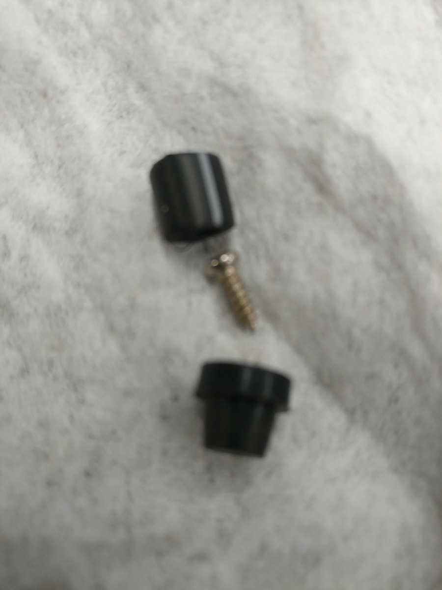

Three years ago, I had the same problem. I modified another plug with a small screw half way screwed into the plug and a peice of fuel hose slid over the screw head. I didn't measure, just kept trimming the hose untill light pressure was needed to push the float bowl shut. I had the bowls off the carbs this March, and the plug mods were still intact.
