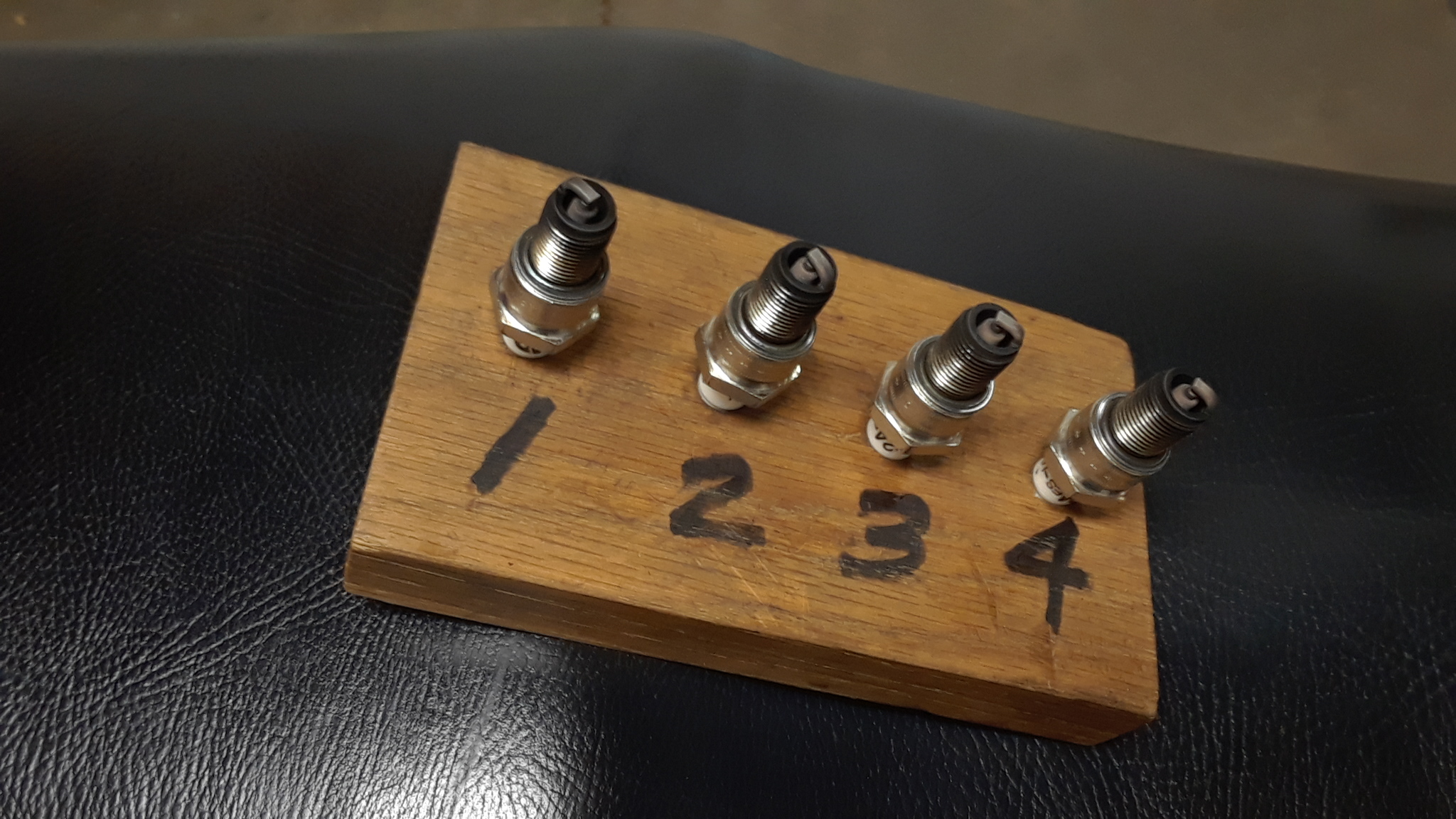

Tach will hold 1000 rpms rock-steady at full operating temperature.
Denso 24ES-U plugs pulled this evening. #1 looks a touch rich...will change that air jet from 1.0 to 1.1
photos.app.goo.gl/AQq3V6Bzv6m4CK9EA
