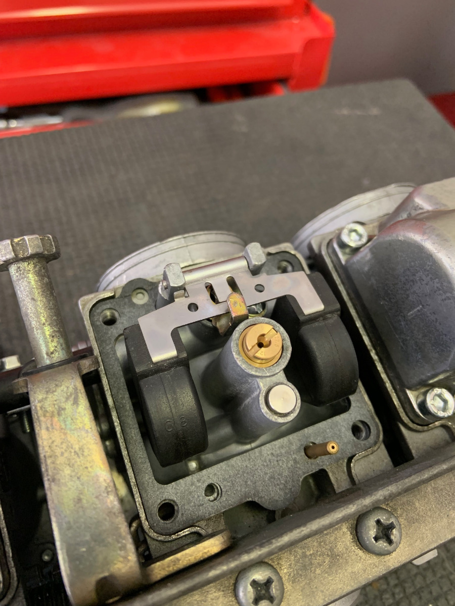

On the carbs I have been into, there is a small wire hook on each float valve that hooks over the adjunct tab on the float. I do not see it in the picture.

21 May 2023 11:37I checked a couple of pictures online and there is also one in the clymer, and these KZ BS34 seems to look like this, nothing is missing what I can tell. But thanks for the heads up!On the carbs I have been into, there is a small wire hook on each float valve that hooks over the adjunct tab on the float. I do not see it in the picture.
