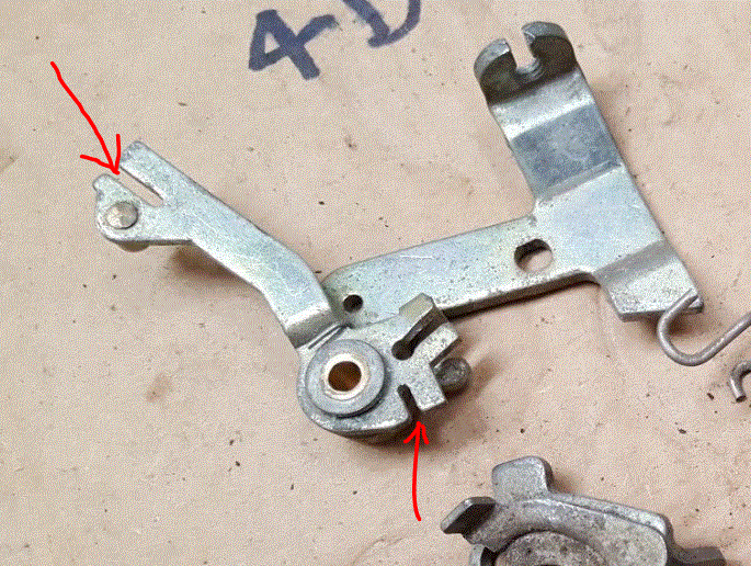

For what it's worth, the Keihin CV34's have a feature which allows adjustment of "on choke" idle speed. I hesitate to even mention this because this feature is not responsible for the problems this bike is having, plus, performing this adjustment shouldn't be necessary. Anyway, by opening or closing the slots shown, the choke function and choke idle speed feature is affected.
The following user(s) said Thank You: kz750spectre

I see where you are coming from, however the bike only idles high when the choke is fully engaged. When the choke is opened even a hair (just to get it off the fast idle link) it idles normally. By the way yes I know the owner so I've had a little time to screw with it. I can hear slight primary chain rattle at idle but I've been told this is normal. I have been through the carbs already and they looked almost brand new inside, however I cleaned each passage and made sure everything was proper. My question to you guys is what you believe it could be, I know there's a lot of variables going on here so it can't be as simple as that. I'm just trying to make sure its a good motor and bike before buying so I'm just trying to get it going as well as I can. So far I'm thinking either vacuum leak from the intake hoses or that tiny plastic knub over the pilot jets aren't sealing properly.

02 May 2023 11:57For what it's worth, the Keihin CV34's have a feature which allows adjustment of "on choke" idle speed. I hesitate to even mention this because this feature is not responsible for the problems this bike is having, plus, performing this adjustment shouldn't be necessary. Anyway, by opening or closing the slots shown, the choke function and choke idle speed feature is affected.
When I got my KZ750 it would not fast idle at all even at full choke. I did that adjustment and now it works pretty well. Full choke to start and start lowering the lever as low as the bike will idle smoothly. When the engine is hot the idle will be pretty high if full choke is applied.
