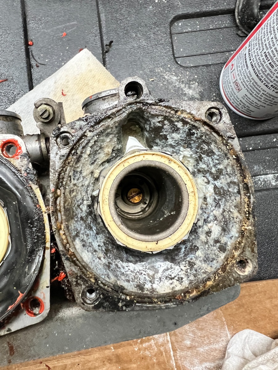

31 Jul 2022 14:45 - 31 Jul 2022 14:46How would you do that? Here is a picture of the slide, it's completely corroded in place, not moving at all. I sprayed it with carb cleaner, WD40 and pb blaster penetrating oil, but nothing helps.Stuck slides can usually be freed with some patience

31 Jul 2022 16:36 - 31 Jul 2022 16:38Don´t limit your search filter. You can use CV34 carbs from earlier/later 650/750 bikes.
The ZN700 carbs are different from the earlier version of the CV34's so the individual carb bodies won't interchange, but if you can find a complete set, they will interchange.
I've rebuilt at least half a dozen sets of CV34's, and they are a little tricky to work with, but not overly difficult. That slide on your carb is junk at this point.
BTW, to remove stuck slides, you need to heat the carb body with a heat gun to soften the varnish. Oh, and you are wasting your time trying to rebuild a set of carbs that are still ganged together. They must come apart fully to get at all the various parts.

You only have one picture so I can't say for sure, but if the other three carbs are anywhere close to that condition, I think it would be far easier and cheaper to buy another set and start from there. These carbs may be scrap.
You won't really know until you've stripped them down completely, you might get two replacement carbs and then snap a pilot jet or find another part completely siezed. Don't make any plans until you've taken them all apart as far as you want.
It certainly won't hurt to strip them down and soak them to see what you can get out of them. But I'd expect to be looking for a better set to restore. Buying two more carb bodies + parts for them will likely cost more than a 2nd hand set in decent condition.
