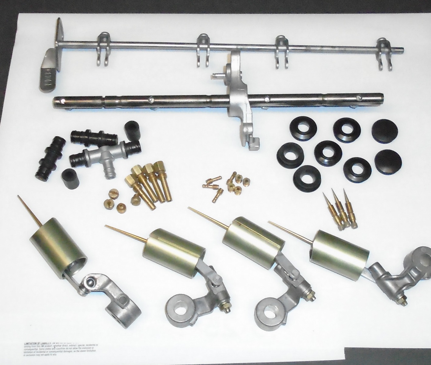

I'd stick with stock, plentiful on ebay! I had this nice pile of parts on ebay no one bought?

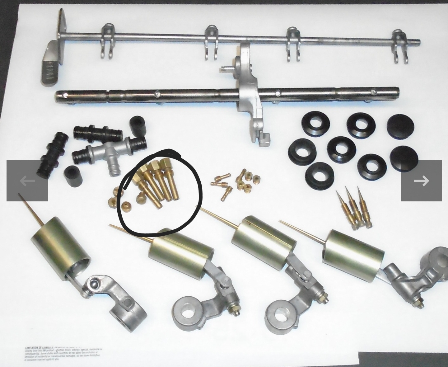

Yeah, the common consensus I've seen seems to be that they will work you just have to mod the boot a little bit by elongating it a little bit One direction. The spacing seems to be exactly the same it's only that the boot itself is slightly larger so the holes are off center.
And it also seems to be the consensus that unless I bore out the engine I will not get any performance upgrades out of it which is fine, I may plan on doing some performance upgrades in the future but for just getting it running I think
I see you have the main jet bleeder tubes, would you be willing to part with one? And if so how much? I only need one
One more question for you, the parts just to the right of that that I circled, what are those called? There is one of them in my rebuild kit for the the vm24, but I did not pull one out of my VM 26 carb. Am I just missing it? Or is it not in the vm26
You know, I may also need another one of those solid caps, I will have to look but I don't recall they're being two in my parts basket. It is possible it was either already gone, or if you had another thing my son ran off with. If you are willing to part with those two things, if you could let me know a price and then I could DM you.

30 Jan 2022 06:33They VM22/24's ARE the same spacing as the 26/28's and you use the matching 900/1000 manifolds with the mounting holes slightly elogated inward to fit the narrower spacing of the 650 heads bolt holes.I never worked on or owned a 650. But I would think the spacing is not the same? For carbs. The 26 carbs are wider? Can you stretch the manifolds? To fit the bigger carbs? As I never hear of guys putting bigger carbs on their 650's for a performance mod? Just like putting 29mm smoothbores on their 900/1000's
It's common to use the larger carbs on the 650's and 750's for performance applications and 810 big bores etc and also the 29mm smoothbores on them too and not just the 900/1000's.

30 Jan 2022 06:39The parts to the right of the emulsion tubes are the pilot jets.One more question for you, the parts just to the right of that that I circled, what are those called? There is one of them in my rebuild kit for the the vm24, but I did not pull one out of my VM 26 carb. Am I just missing it? Or is it not in the vm26
The long ones are similar to those in the larger 26/28mm carbs.
The other short ones are secondary pilot jets ( usually marked "50" ) and are not found on the larger carbs.

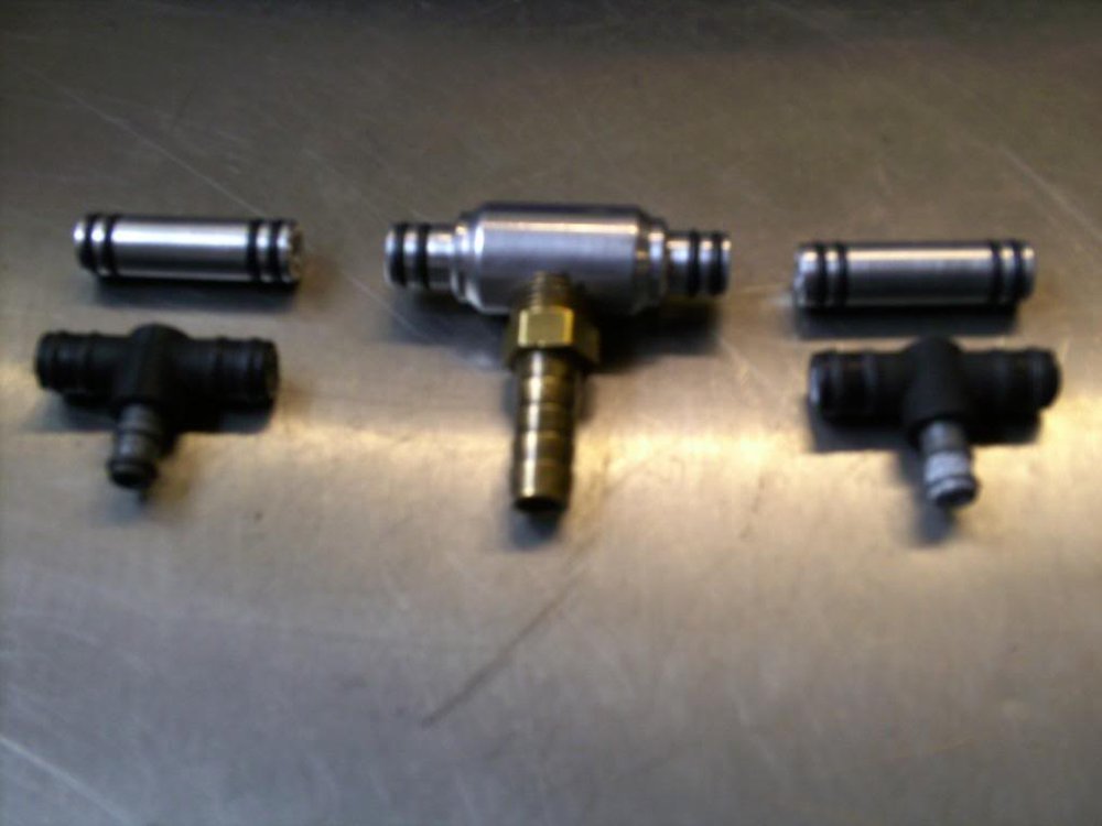

You've been so much help, I really appreciate it. One more quick question and then I think I'm done bothering you guys for a while at least on the carbs LOL I see on eBay there are both plastic and aluminum fuel tees. I believe the carbs came with plastic ones but can I replace them with the aluminum ones? The plastic ones are cracked and I'd like to never have to replace them again.

The aluminium ones with replaceable 'O' rings ( use Viton ) will fit and work great..
Make sure you order the correct one/ones as there are both single and dual feed carbs.
The dual feed uses two short tees and the single uses one slightly longer one.
You can also buy new rubber sleeves to repair the split ones on original cast tees.

Okay, that's what I figured. I wasn't sure if they had single or double only. I think I will get the aluminum ones then.
Is the bore specific? For example if I just machined myself a set would it be okay if it had a bigger bore than the previous one?

30 Jan 2022 12:19Okay, that's what I figured. I wasn't sure if they had single or double only. I think I will get the aluminum ones then.
Yes, you can machine your own Tee's pretty easily. I've made some. Not sure what you mean by "bigger bore." Are you talking about the hole size though the Tee? If so, I'd say the hole size isn't particularly important. Don't go too big though or there won't be enough meat between the bore and the bottom of the O-ring groove.

I make my own and you can make the bore as big as you like within the limits of the bottom of the 'O' ring grooves.
These were for some bored out 26's to 30mm and converted to a large single feed from dual .
