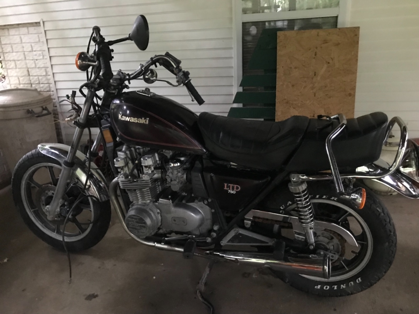

Good morning all, first post here. I picked up a new to me 1981 KZ750H LTD for $650. Needs a lot of work but nothing I can’t handle. Upon taking it apart to clean the air box out I noticed that 2 of the air box to carburetor boots had holes in them and the filter top cover was broken. Upon some investigation into some more expensive parts, I came across the pod filters. If I install these do I need to change the jetting in the carb?

Any pod filters worth using will be at least the cost of fixing your airbox situation; they'll also have some drawbacks. Jetting would need altering (maybe new jets, maybe just adjusting pilot screws), your idle will be rougher, you may lose lower-end power, you'll have issues on rainy days, and crosswinds may lean out your mixture.
They do have some upsides, such as ease of installation over the airbox boots and a possibly a bit more top-end power, but my personal recommendation is new airbox boots and fix/replace the top cover.
I think I have an airbox top, but it'll be a few days until I can check/retrieve it...if you don't mind waiting it's yours.
Replacement boots here. They're not OEM but they'll be a bit more recently manufactured.

+1 Ghostdive
Keep everything stock standard ... least hassle, most ride-able, most reliable.
I'm in the process of putting the air-box back on my '81 GPZ550 D1
I'm done trying to get perfect mixture through the full rev range. It's good at low rpm, good above 6500... but splutters between 5500 and 6500, where it should be sweet! (highway speed 120 km/h)
I've had the carbs off at least 25 times.
I've even drilled jets ½ size up, shimmed needles with 0.25mm thick washers to get in-between needle clip postions... even tried partially restricting flow by taping closed sections of the pods with duct tabe!
I think Kawasaki engineers arrived at the best overall ballance of drive-ability / fuel economy.

Thank you all for the replies. I decided to take your suggestions and fix the stock air box. I would love to get that air box cover from you. Just PM me and I’ll send you my address. Thank you for the compliments on the bike as well. Many many parts coming in soon. Not soon enough though. I do have some wiring issues I hope you all can help me with.
