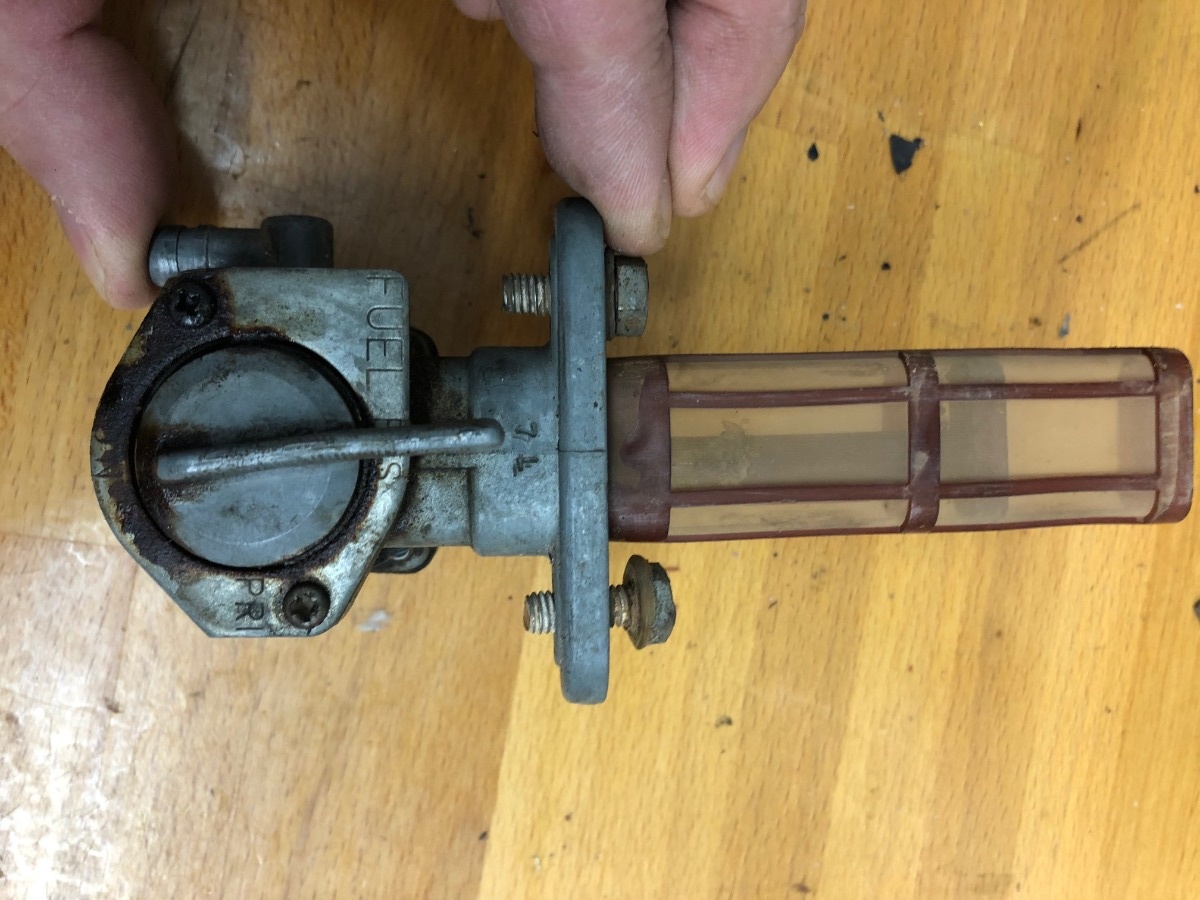

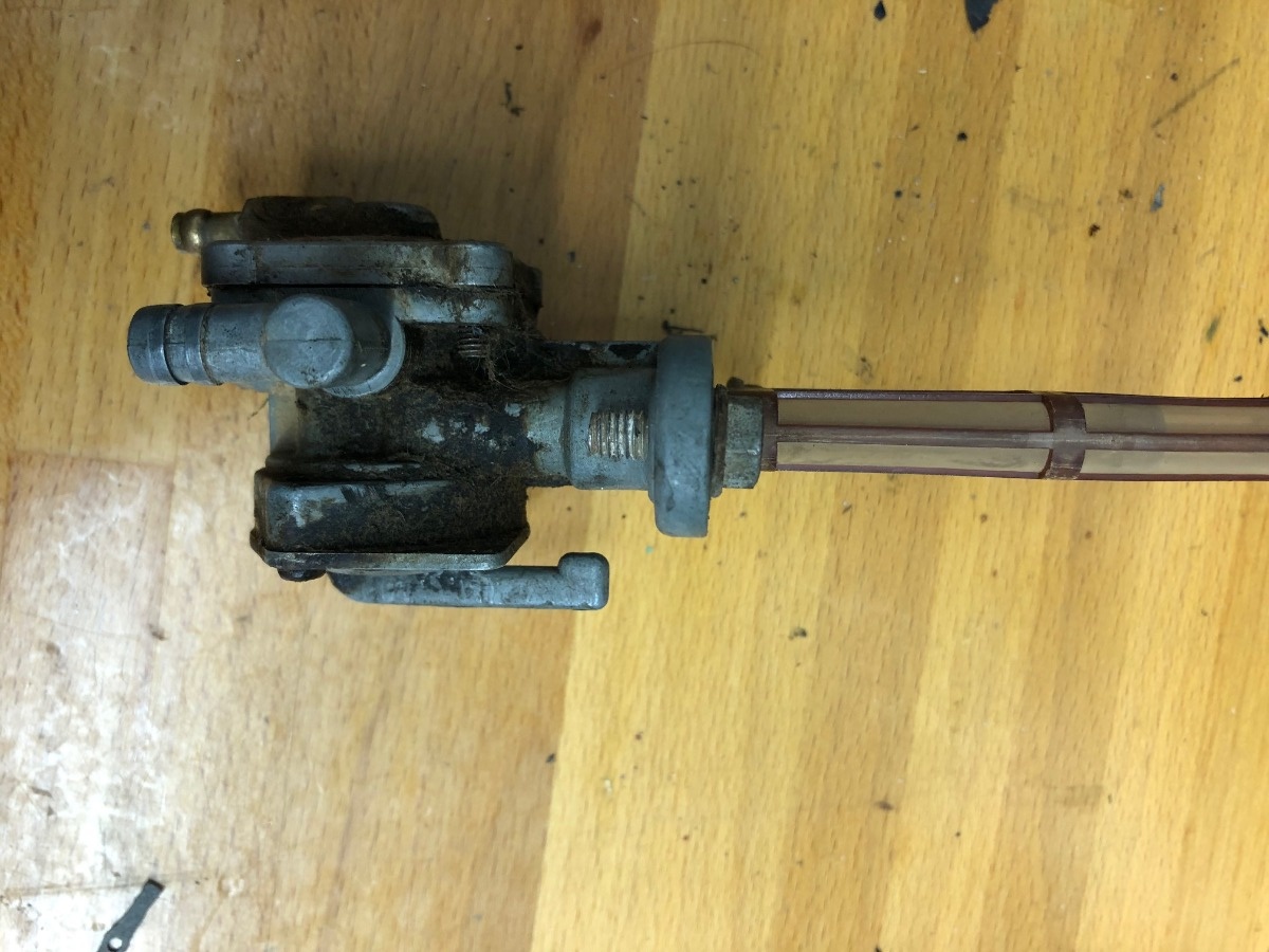

Got bike like this. Lever seem to be bent a little and locked.
Side L tube comes out by hand
I wonder if this can be rebuilt and what is needed?
- Posts: 8218
- Thanks: 3583
Re: Is there hope for this petcock?
08 Dec 2020 04:52
You might want to check the OEM Kawasaki parts fishe to see what if any parts are still available. Assuming you can get what you need in regards to soft parts like O-rings and a new diaphragm then you have a decent chance to rebuild it. You will have to take it apart and look for metal erosion on the sealing surfaces too. If all checks out then I'd go for it. I successfully rebuilt the petcock for my 750E and it works perfectly. One thing I caution against is purchasing aftermarket petcock parts like K&L. They have a very poor success rate. You might get lucky mind you and get a kit that actually fits, but it's no guarantee.

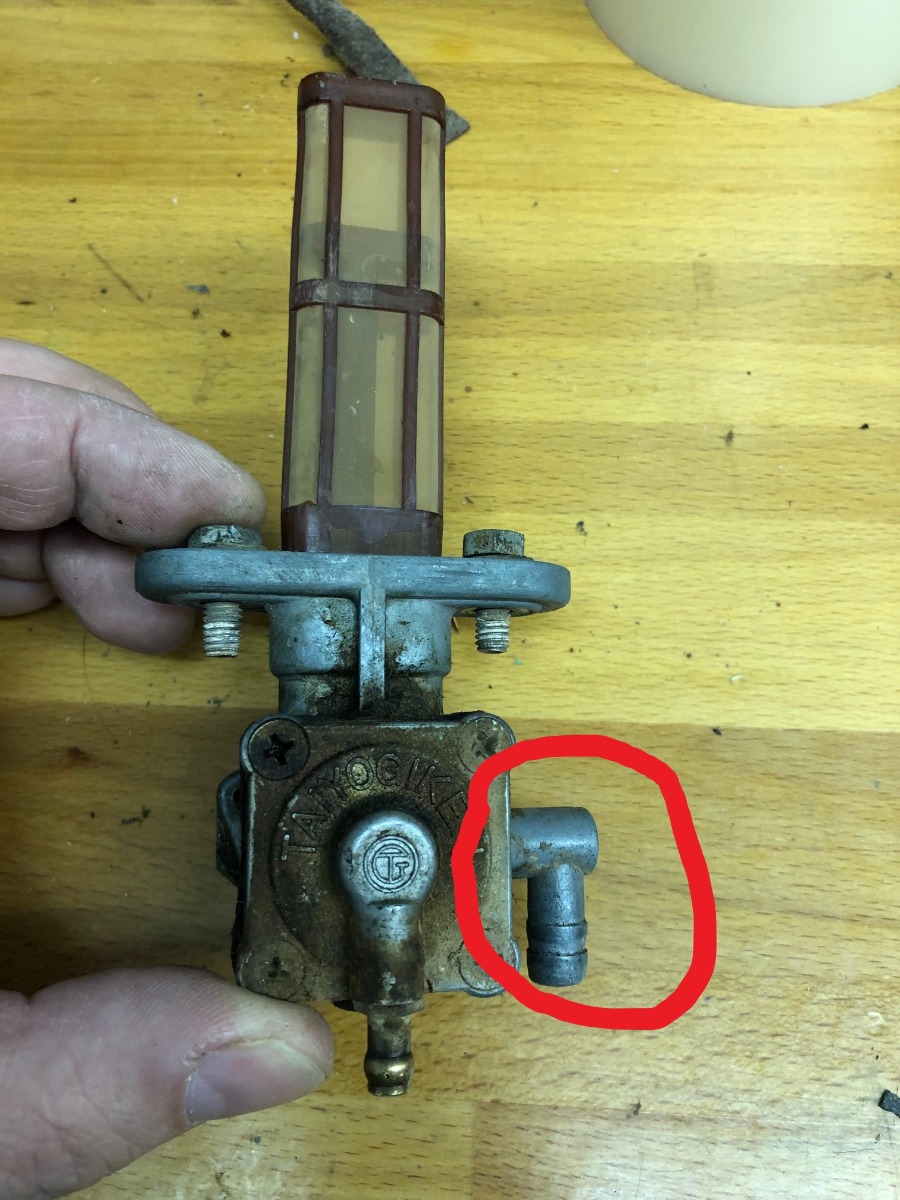

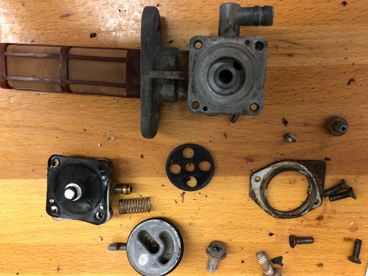

OK! Found rebuild kit. Overall looks salvageable. ONE issue. Or maybe not issue.
Fuel supply L-shaped thingy is loose. It looks like it was press fit? I don't see any o-rings on it. And fuel leaking there.
Is that fixable?
Other than that - rebuild kit available:
www.z1enterprises.com/petcock-kit-vacuum-200-2014.html
Is that fixable?
08 Dec 2020 10:57 - 08 Dec 2020 11:01
To clarify, L-shaped fuel outlet can be removed easily by hand. Tight fit but I can take it out. On all part diagrams body is one piece with this outlet, makes me think it was press-fit.
Need to be glued I would think. Any specific glue you might recommend? Or plan old JB weld should work?
Or, let me ask another question. Rebuild kit is $23. Anything out there even if it's up to $50 which will work the same, be quality and without guess work?
I would just install another petcock and not worry about it if there is a chance it won't work correctly.
Last edit: 08 Dec 2020 11:01 by katit.
08 Dec 2020 12:21To clarify, L-shaped fuel outlet can be removed easily by hand. Tight fit but I can take it out. On all part diagrams body is one piece with this outlet, makes me think it was press-fit.
Loctite 648
