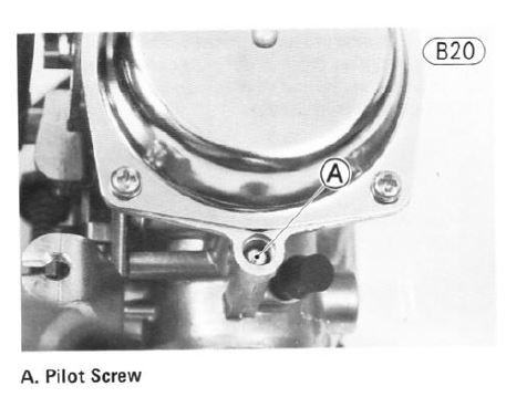

So I'm having a slight problem with my carbs. My pilot screws are capped off and I was wondering how do I get the plug out to access the pilot screw?

This tutorial is not specific to those carbs but there is some specific information on how to remove the cap over the pilot screw.
zeus.mtsac.edu/~cliff/storage/gs/Mikuni_...Rebuild_Tutorial.pdf

I just measured one of those caps from a Keihin CV34 at 2.35mm thick.

Finally read the PDF and I had a feeling I’d have to drill out the plug. Guess that’s gonna be a weekend/late night project. Thanks

It's been a few months and I hadn't touched the carbs. Finally had the opportunity to pull the carbs and replace the pilot screws, springs, o-rings, and washers. Backed them out 2.5 turns and fired her up. She was idling a little smoother but still backfired/popping and was still smelling fuel. So I tried 1.5 turns and she ran a little rougher and popped more.
Today I tired to adjust the pilot screws again. Tried 3 different adjustments, all having the same result. 2.5 turns, 1.5 turns, 2 turns, and finally 2.75 turns= revving to 5k, no popping/backfiring at idle; test ride resulted in bogging down (almost shutting down) at WOT, slowly rolling throttle only gets me to ~4k rpms.
So, do I need to back the screws out 3 or more turns? Do I need to rejet the carbs now?

The pilot screws are for setting the idle mixture. A good tuning method is to tweak them until the highest idle speed is achieved. These screws have an effective range of 1-4 turns out and the further out the richer the mixture.
