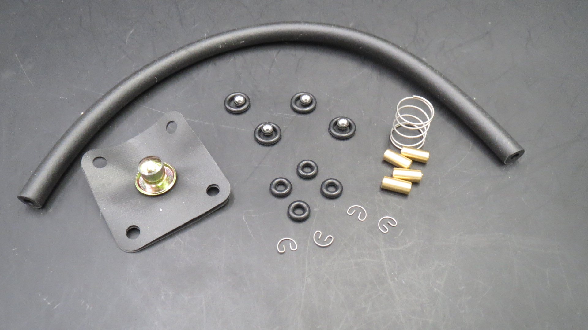

I would think the little parts would be necessary so that all four nozzles squirt the same. I think the ball & weight prevent the fuel from draining back down into the pump so that the nozzles are always primed w fuel. You could rig up a carb stand & temporary fuel supply, then vigorously actuate the throttle pulley to compare what happens. Fuel should squirt out each nozzle the same without hitting the carb bore walls.
edit: Z1Enterprises.com has a K&L kit. The kit from RedlineCycle & elsewhere is probably the same.

09 Jun 2020 12:11jekyllman wrote: I'd REALLY like to not spend $30 just to get such a tiny part that seems pretty inconsequential. Anyone think this could be ok just as is? (really hunting for justification here if you can't tell)
If not, I guess I'll just suck it up and buy a kit
If the parts were inconsequential they wouldn't be in there.
The ball etc are an essential part of the pump system and act as a one way valve.
You could get a big magnet and sweep the area where you lost the parts.
Otherwise you will have to buy the bits that are missing or the carbs won't work correctly.
The other option is to disable the pumper system entirely but then you may still have to spend out on additional jets to correct the fueling and spend more time and money changing them till you get it sorted and then maybe have to take it to a shop and pay them to sort it out after it still won't run right.
