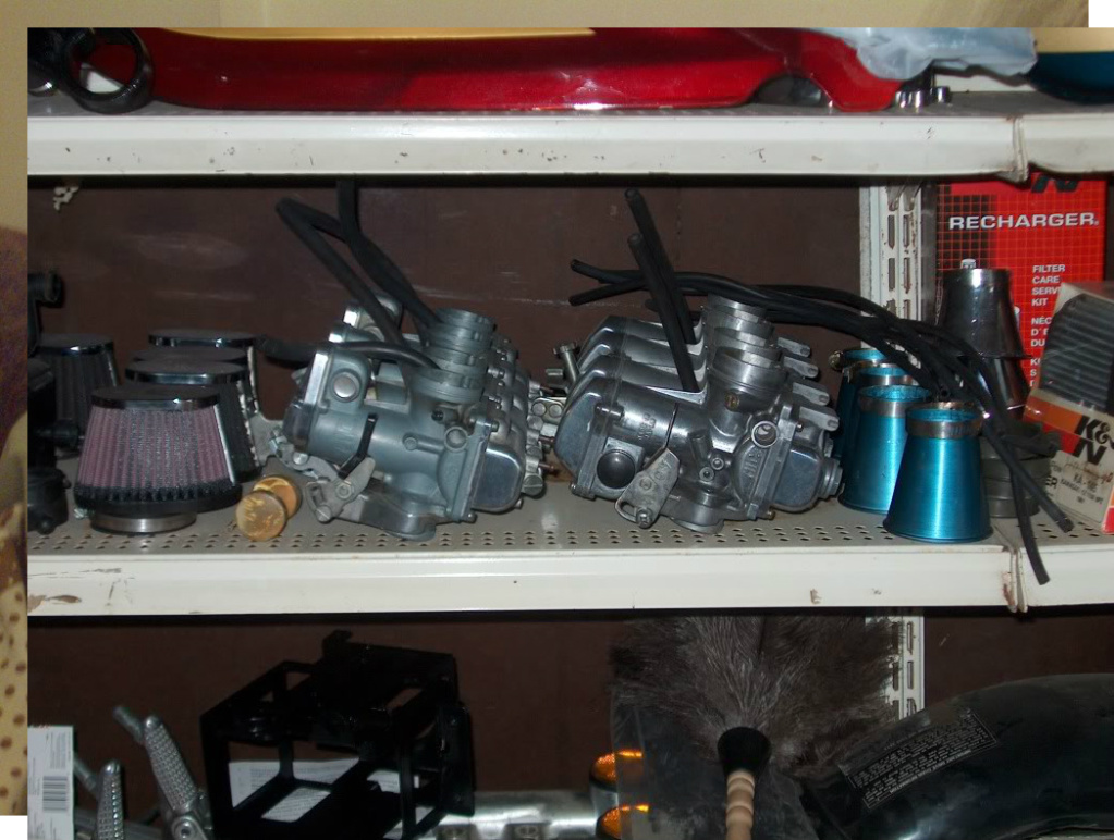

Yup, those are 28's from a Z1. Valuable carbs, but not 29's. Here's a couple of pics of my set of smoothbores:
They should have the little square cast into the body just above the float bowl. Also you should be able to look in the bore when the slides are up and see this guy. It's the jet block.
