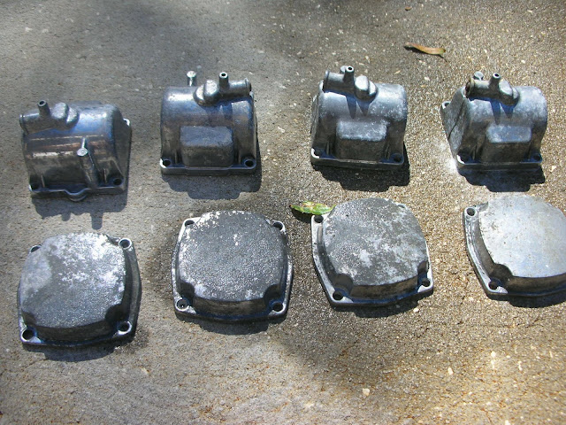

Ok, guys... 36hr soak, here are the results.
Only before pic I have of them...
The Soak..
A lot of funk coming of..
After..

Over all I would give the process a 6~7. Super easy, nothing harsh, but the results are not fantastic, but pretty good. Did a real good job on the surface rust and the internal smooth surfaces. Cleaned the outside nice, but still will require some brushing.
It might help the process to brush it and soak it for a bit longer. These carbs are pretty rough, so I was not expecting miracles, but it did a better job then I expected. Overall if you need just a general cleaning it should work just fine for you.
