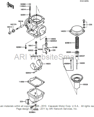

Here is the breakdown for your carb:

Thanks for the info motor head, I have the diagram in my manual for my carbies, but will definitely go through that tutorial. It was suggested that I take the bowls and the tops off and blow through them with carb cleaner. Just wanted to make sure I wasn't going to ruin anything by doing so.. I would like to try all options before pulling these things
