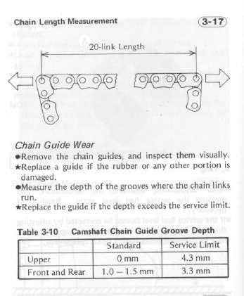

There is a spec for checking the Hi-Vo chain length, I've included the FSM check.
The Hi-Vo chain makes degreeing much harder, as the chain guide is in the cover.
Patton suggests the Advancer cleaning, I'm sure you've done all that, right?
If the timing is hanging it will cause the Idle to hold higher than normal.
Sorry this is the Length, Here.
So if the chain has stretched, or guides worn since the Timing was done, that would retard it some. But enough? Only a degreeing would be able to tell how far, if at all it is off from Web cams spec.
