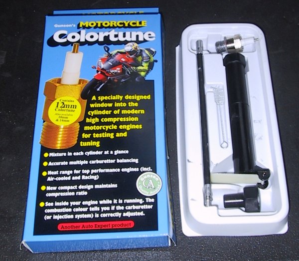

On these carbs, the pilot screw is a "mixture" screw, and therefore enrichens the mixture at idle when turn out (counter-clockwise), and thus leans it when turned in (clock-wise).
Incase you didnt already know :blush:
If the rpm continues to increase right to the max, or min (around 1/4 turn open), then that tells you what step to change the pilot. All the way out higher rpm - larger pilot, all the way in - smaller pilot.
PS. THIS:
Would solve all your problems in a jiffy - trust me!
