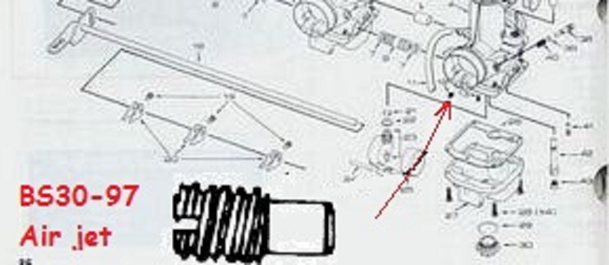

This applies to Mikuni 29mm smoothbores, but should also work with the RS carb.
Without a side located drain screw, may collect fuel from hole at bottom of bowl.
Some folks adapt a spare 17mm bolt plug by drilling and fitting a nipple to attach the clear tube.
I just use a cone shape rubber plug pressed into the drain, with a hole through the rubber plug, and the clear tube fitted snugly inside the rubber plug hole. Then hold the rubber plug in position during the measurement.
Others report using an inch of 3/8" fuel line (to fit snugly in the bowl drain threads), with a clear 1/4" hose inside the 3/8" hose.
Some minimal leakage won't affect the results, because fuel volume entering the bowl exceeds any leakage.
As shown in the link posted by mark1122, would assure that Part #90 Pilot Air Jet BS30/97 is in position, and is in good condition, and hasn't been reamed out by over zealous cleaning.
The below image is of 29mm smoothbore with the same air jet.
The following post shows closeup of RS carb's Part #90 Pilot Air Jet BS30/97
