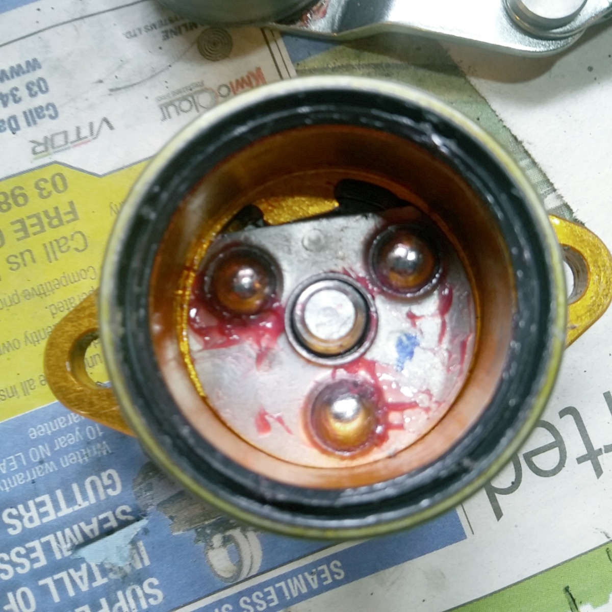

I dont know what happened today. But the b*st**d thing is working fine. I did squirt a fair bit of grease under the ball bearing holder and more on top before putting the actuator arm back in. I also pulled the pushrod half way out and made sure it was going into the hole in the actuator as I pushed the cover back on. I pulled that clutch lever in at least 30 times with no problem.. Once I have the front brake caliper back on. (Thats a whole other new problem). I'll go out for a ride and see how it goes.

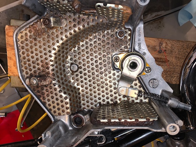

18 Dec 2021 09:13The clutch lever and its holder are all factory. Yes. No matter if I have 1/8" freeplay or an inch with minimum travel of the pushrod. It lets go. I did notice that the Bearing Holder doesnt sit square to flat bit in the gold main body and its only just being held in place. I wonder if thats got something to do with the problem?
Looks to me the push rod was off enter and not contacting the adjustment screw. How much slop is in the output shaft bearing cap?

MoveOver. I only put a light smear of greas under the bearing holder and on top, after putting it in. But this time I gave it 3-4 shots from the grease gun under and over.
SWest. The pushrod doesn't make contact with the adjustment screw at all. There is another bit that fits into the main holder that the pushrod fits into. The marks you can see are manufacturing spot welds.
I hope I've got it sorted now. I was one step from throwing it in. Just hope that next time I'm in there, I dont have problems with it. I guess I'll be carrying around the factory actuator and rod for a while.

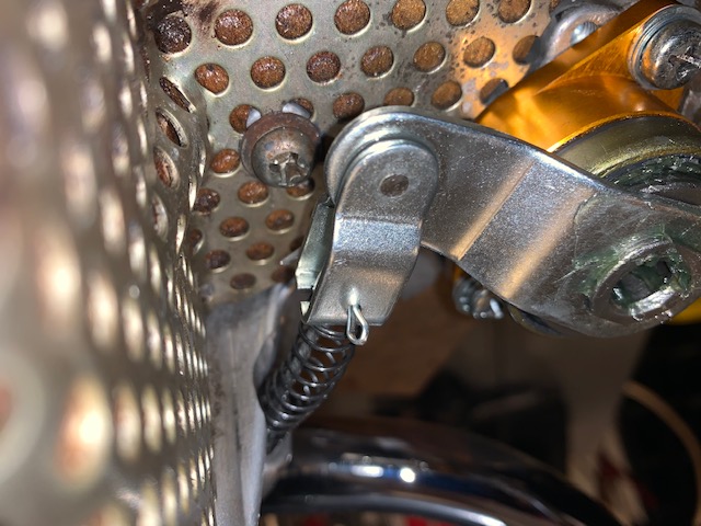

I have been away from this topic for a few weeks and it sounds like it has been solved. Almost 2 years ago there was a discussion about the E-Zee clutch when I installed mine in my '77 KZ-1000. Part of my initial problem was that the instructions were written in Japanese, so I tried to just use the supplied pictures as a guide which didn't work very well. I finally located an app that would translate the instructions into English but even that was lacking somewhat. Eventually through trial and error I managed to get the PMC kit installed and haven't had any problems with it in close to 2 years. In fact, it works great and I would agree that the clutch lever effort has been reduced by about 40% give or take. I took a couple of pics to show the relative relationship of the parts before installing the cover in case I need to go at this again. I also took a pic of the cover showing the boss that needed to be removed/ ground off for cable clearance. I didn't do this at first as I didn't want to change or damage the cover in any way, but I encountered problems until I clearanced the cable. It may be after the fact but the pictures are included.
