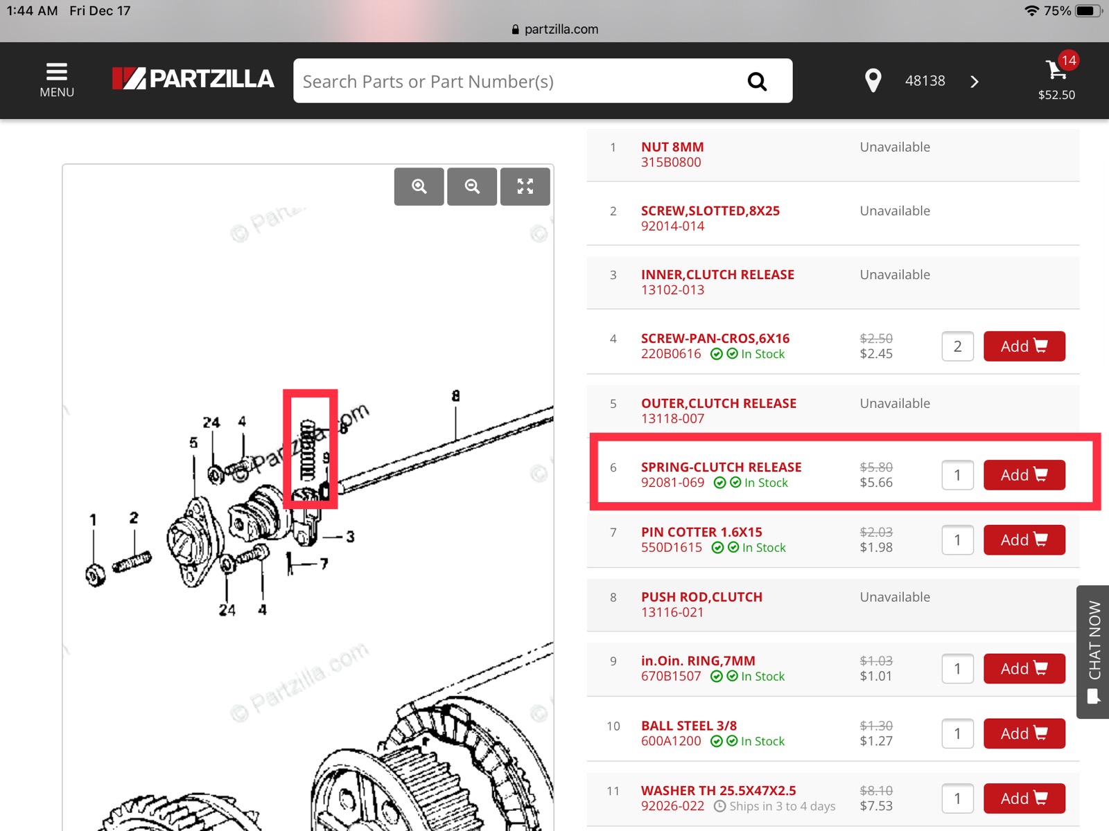

It was used on a lot of models, however, the part that the cable connects to evidently comes in two versions. One part number fits the 550s and 750 four cylinder engines, while the other number is listed for the 1000, 1100, and 750CSR twin. I wonder if one is a tad thicker than the other, thus requiring a different pushrod?
www.partzilla.com/product/kawasaki/13102...45e129b47a54be3be915
www.partzilla.com/product/kawasaki/13102...b98a997ab2f619aa19d9

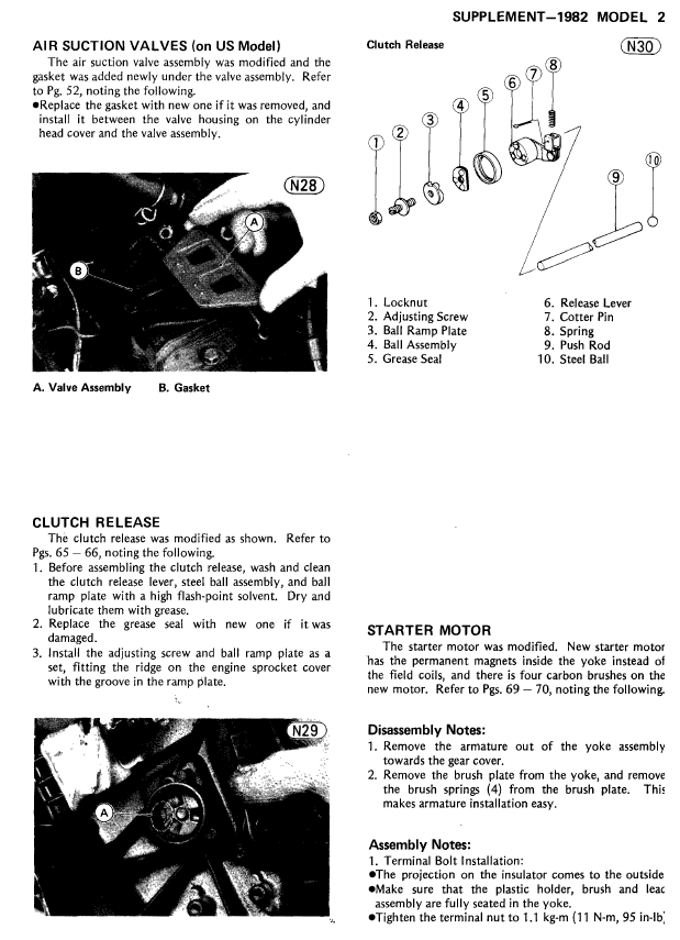

I feel it has something to do with the bearing or the bearing holder inside. The pushrod is now being engaged and disengaging the clutch. But something is going on in the Easy Clutch itself that is causing it to let go and end up with a limp clutch lever after 4-5 pulls of the lever..

Last edit: 16 Dec 2021 22:45 by Mikaw. Reason: Add photo

The system adjustment needs to be set so the PMC lever mechanism is sitting right at the bottom of the ramp when the hand lever is out, and the ramp arm needs to be positioned so the cable is pulling at about 90 degrees. With the arm resting at the base, adjust both the mechanism and the cable free play so you have a little free play at the lever. If the mechanism is sitting at the base of the ramp it won't jump over the top when you pull in the lever.

Last two guess. Are you installing the cotter pin that retains the cable end. Have you checked the pushrod for a bent. Something sounds like maybe, the release isn’t fully returning, the cable end might be coming out of its seat and catching the shoulder of the farrell. Next pull the release is advanced, but cable is tight again. Another pull and release over advances and the balls jump over the ramp. A bent push rod might not be allowing the release to fully return. Have you watched the action while have an assistant pull the clutch lever. Might give you an idea what’s happening. You might be able to see the release in motion if you remove the chain and sprocket and look into the sprocket cover. Try working the release with it mounted and the sprocket cover off. Does it return fully? Does it seam to function correctly? If components won’t work as an assembly break them down into individual parts and check each function independently.
