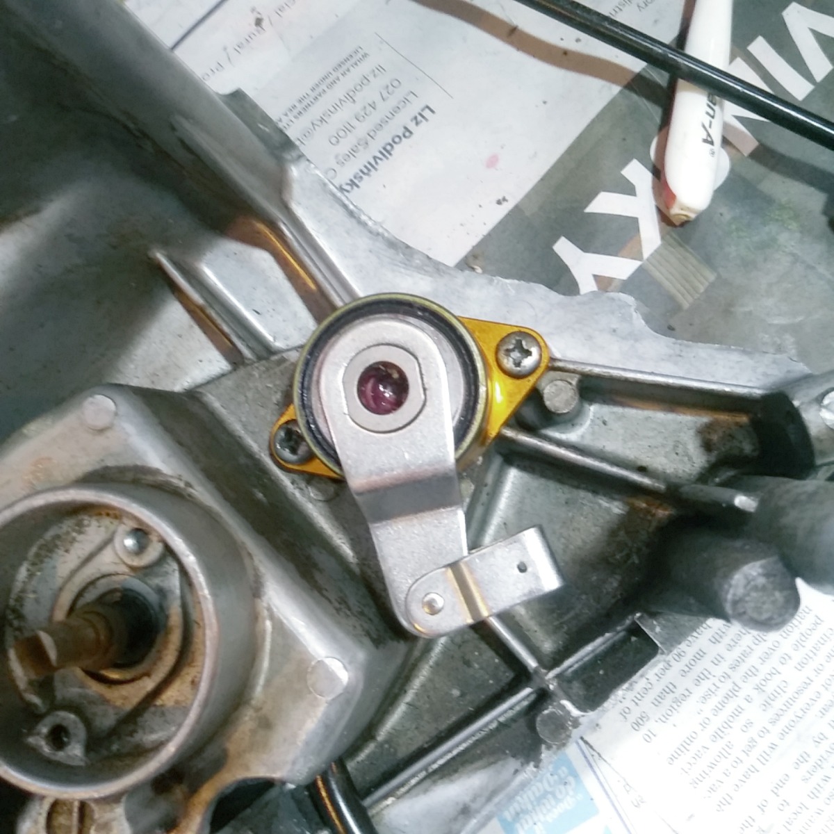

Had another look at the Easy Clutch again today. If I install the gold housing in 180 degrees from how the instruction say. The actuating arm hits the aluminium housing. So cant be installed. If I move the arm a third of a turn. Its too far forward. My next move is to check and make sure the ball bearing is installed behind the clutch.

You are close. The gold housing stays the same. You have to keep moving the actuating arm around until you get it. I looked at it so many different times and moved it around plenty as well. It will work, just keep moving it.

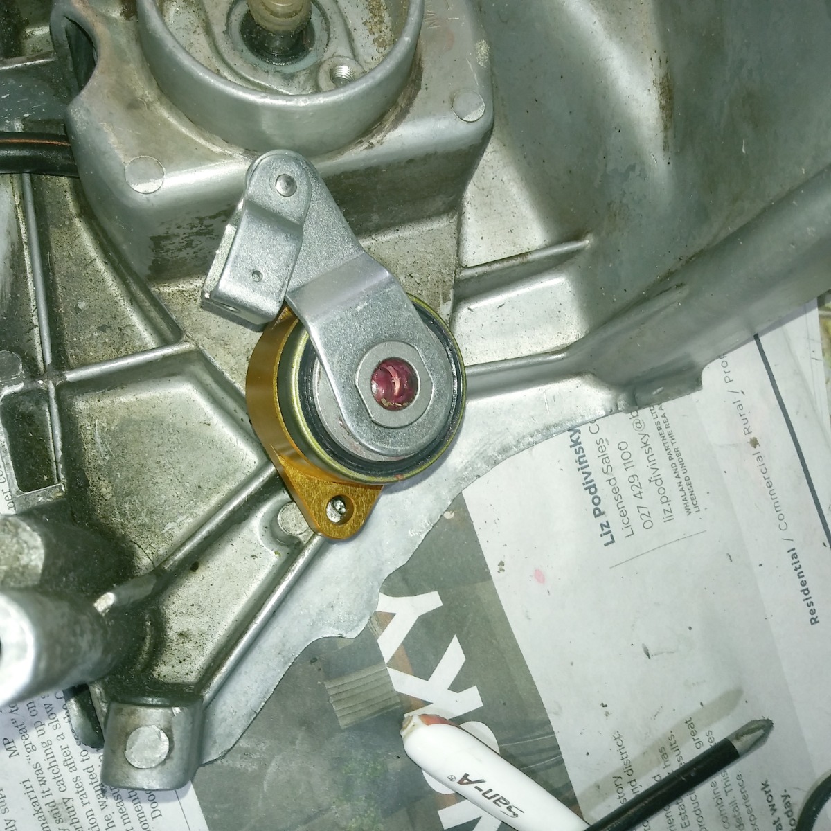

So what was it that you turned 180 degrees? Because the actuator sits on 3 balls in a triangle shape. There is only 3 positions it can sit. Each position is 120 degrees from the other.
This is where my actuator sits when I follow the instructions. But I run out of adjustment in the cable and the rod is still not being activated.

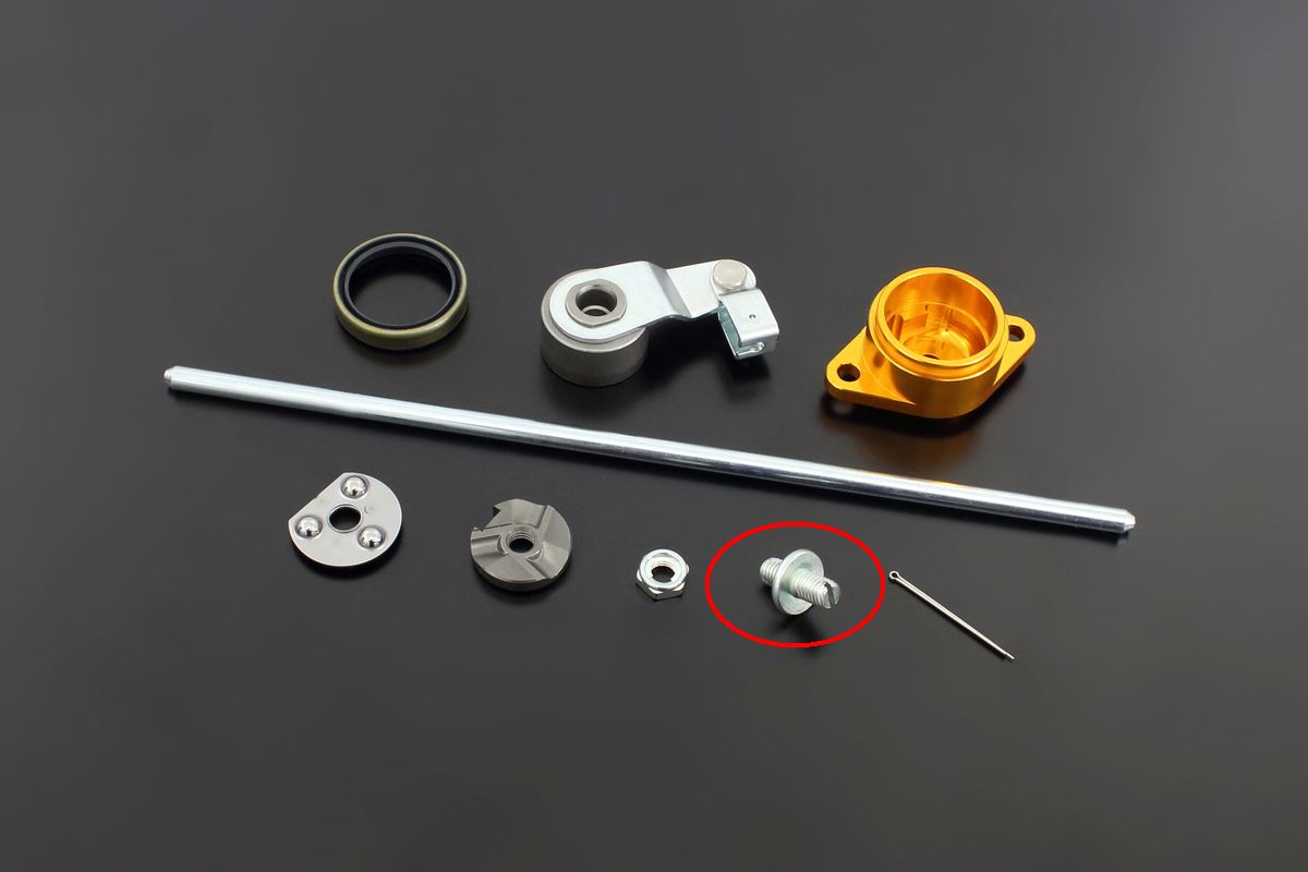

You have to adjust the acutator to rod play with this screw first, before you adjust the clutch cable play.

Thanks for that. It has been (somewhat) helpful. I was screwing the slotted screw all the way in. But its saying I have to unscrew it a certain amount to take up the slack between the actuater and pushrod. Which is ass about face to normal. Might make all the difference. I'll let you know. Cheers.
