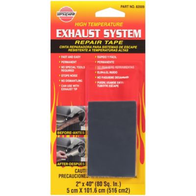

24 Aug 2021 08:58Wonder if this would work, just wrap it around the outside of the seam. I cant imagine it would be anything resembling permanent and even if it doesn't come completely off easily it wouldn't affect the fit of the OEM gasket when it comes.

I tried the tin snips that I have, and various other cutting tools, but ended up destroying the oversized gasket. They are kind of fragile and want to unwind once you break the outer layer. Nobody carries the old style fiberglass wrap (which is what may have been in there) so I just wrapped some fiberglass cloth around it. It may not be very effective but my OEM gasket will be here early next week and I may not have it running for a couple more days anyway.
