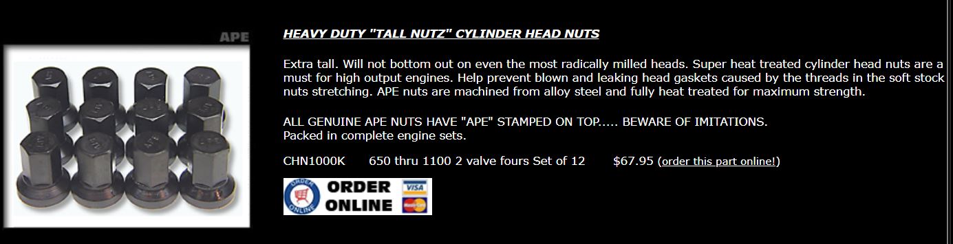

No eBay APP ID and/or Cert ID defined in Kunena configurationSomebody know if these will fit, seller inform about size and threads below?
OEM Kawasaki is also 10mm so they should fit, maybe they are some taller, but it should not be a problem ?
Looks like OEM is 17.5mm high and APE is 22mm, but that should not be a problem ?
APE CHN1000K
You are looking at a brand new in box complete "cylinder head nut" kit as shown in the picture (made in the USA) size10mm x 1.25 with 7/8 base diameter. These super heat treated cylinder head nuts are a must for high output engines. Help prevent blown and leaking head gaskets caused by the threads in the soft stock nuts stretching. APE nuts are machined from alloy steel and fully heat treated for maximum strength. All APE nuts come with "APE" stamped on the head, be ware of imitations..
APE CHN1000K

- gordone
- Posts: 1517
- Thanks: 90
Re: Replace Head Nuts
01 Dec 2018 00:34
Thank you, APE said the same on email.
Nuts on the way in mail

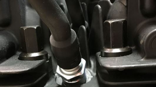

Thank you all, today have I replaced the head nuts:
kzrider.com/forum/11-projects/607213-650...gine?start=60#796009

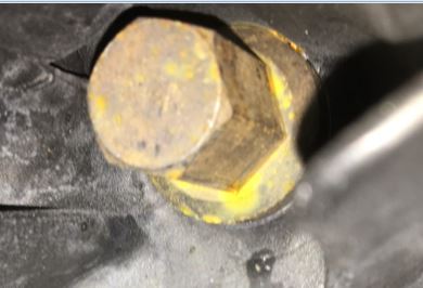

The APE bolts have started to rust?
I`m disappointed, they are rusting, shall they do that ?
Some moths ago:
Right now:
Some moths ago:
Right now:
