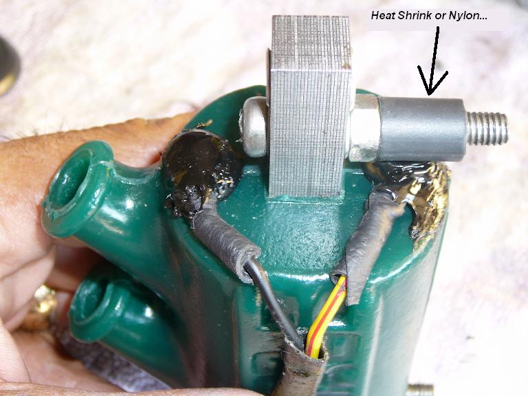

Would assure the coils are mounted whereby the plug wires exit upward and forward before looping down to the spark plugs. Assure that the heads of the screws attaching primary wires aren't shorting against a mounting spacer.
