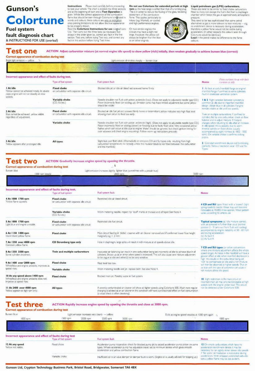

Some may not agree with this but anyways - Retard your timing a couple of degrees from stock, so that Full advance is around 36-38 degrees.
You'll be pleasantly surprised that it will actually be faster, and everything will run cooler.
Check that jetting and make sure your nott too lean in the cruise position - use the colortune:
Head has been milled, this retard timing normally but lacking proper tools (to check cam timing) and money
Damn store are closed today (canada's day)
For the colortune...my neighbors are going hardcore with the revving lately so I've only checked with colortune idle to 3000 rpm max! (relying on sparks plugs reading for WOT mixture...dark(dry not wet) around plugs and grayish on the electrode insulator...all of them are identical)
Also i cannot run on WOT on the highway while checking colortune that would be DEADLY crazy ! :woohoo:
No access to dyno too
thanks for the colortune chart but it's too small to read (picture) i will check on the net!

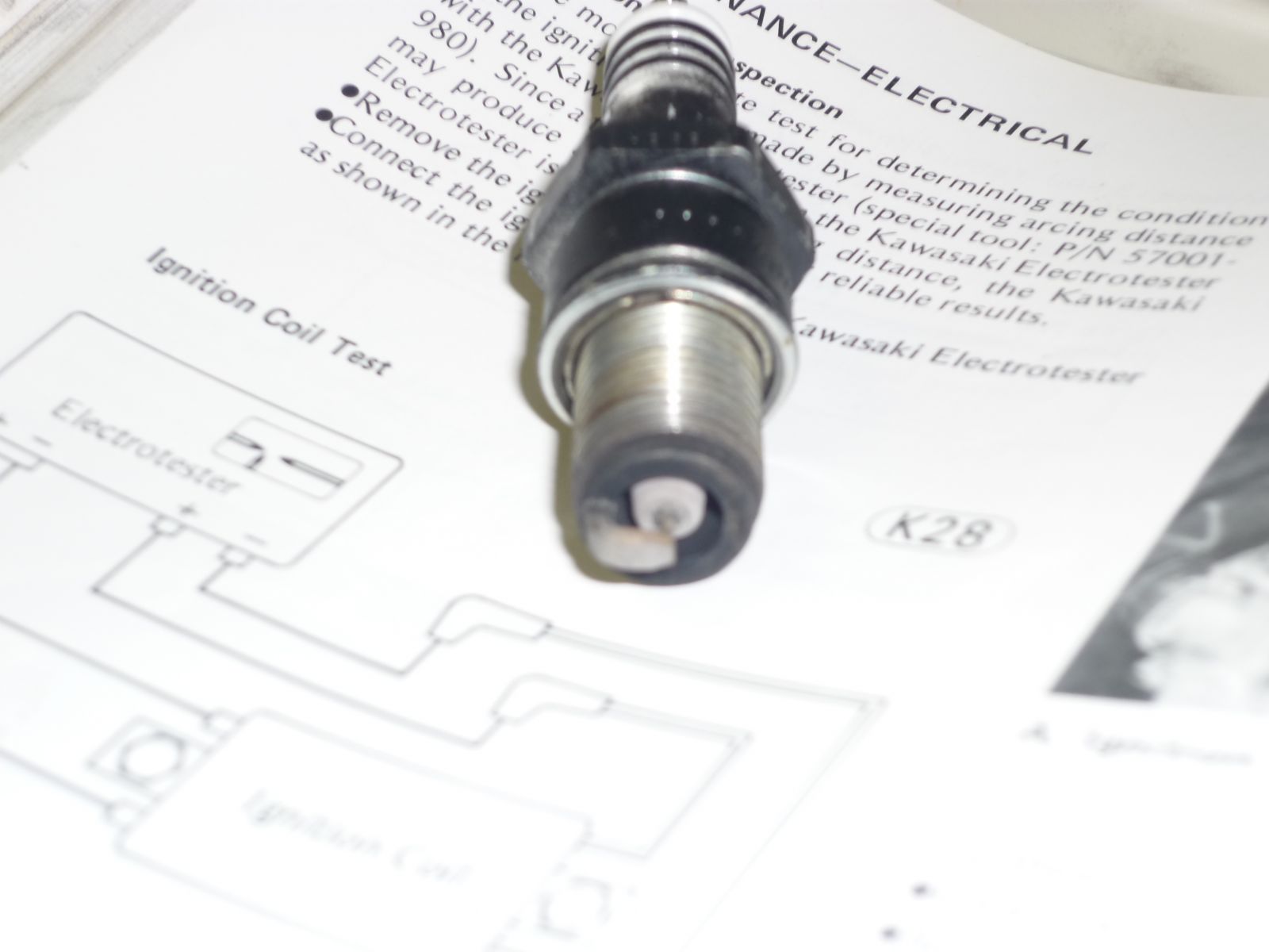

Here's more info ... spark plug pic (4 spark plugs identical)...
Light grey on insulator looks OK but cannot achieve light brown on insulator...
Fuel type 91 AKI (94 RON) a.k.a premium fuel
Checked coil (primary) resistance both around 2.6 ohms...

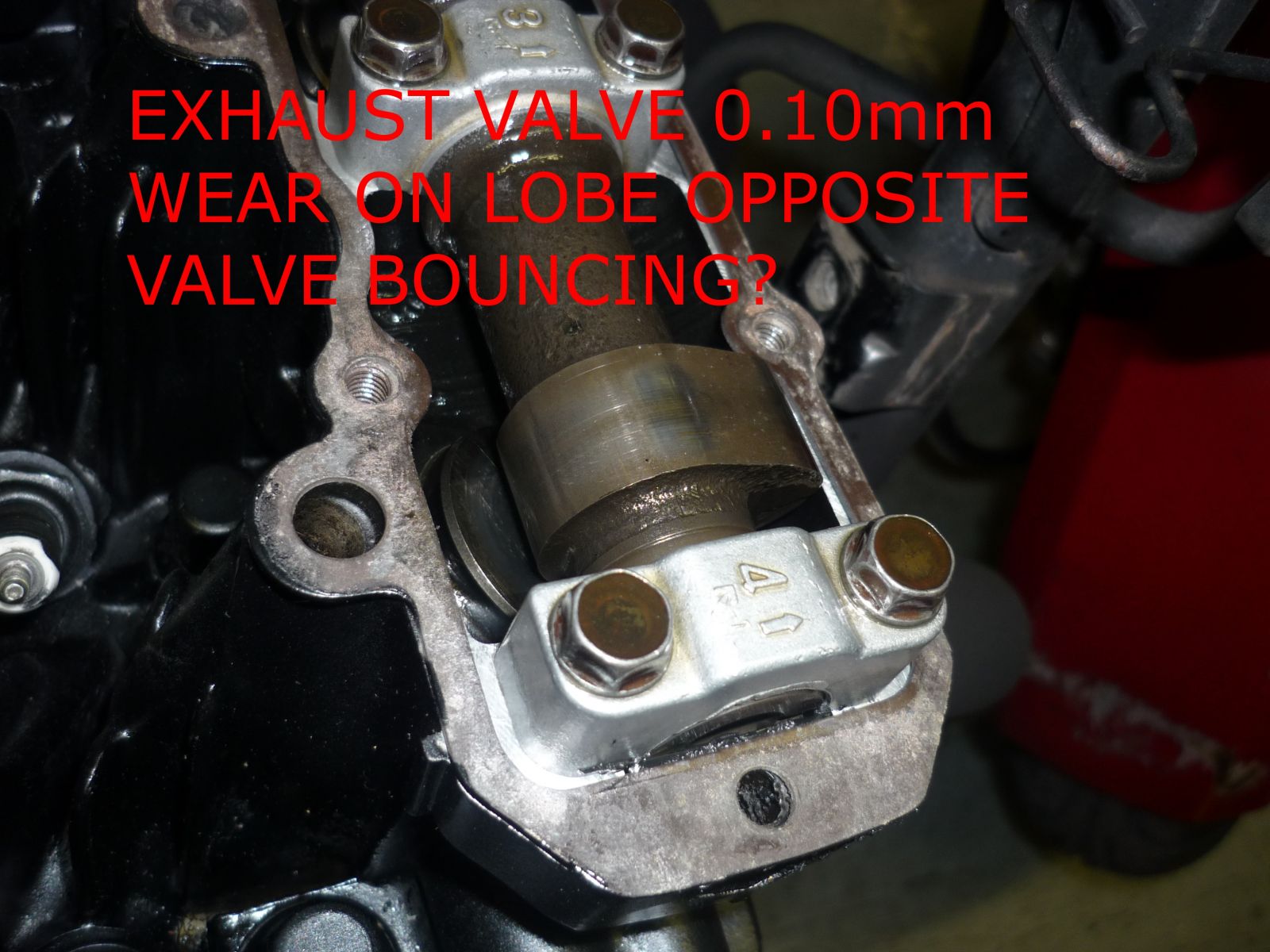

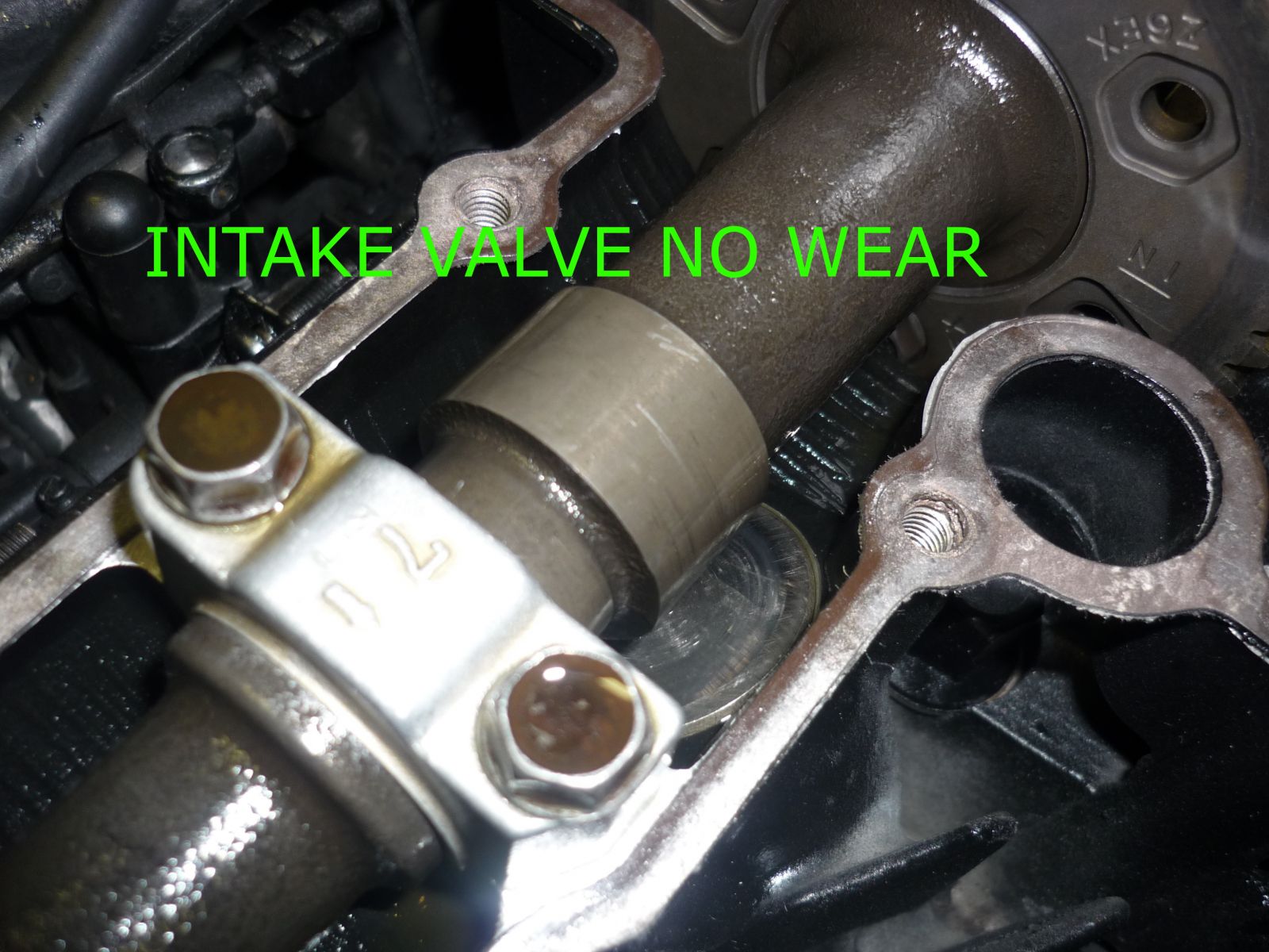

Look at this is that valve float damage or what? Camshaft lobe at the opposite must not touch the valve bucket right (should have clearance!!!!) check the wear !!! WTF ????
Valve clearance exhaust recheck... #1 (0.13mm) #2 (0.12mm) #3 (0.13mm) #4 (0.10mm)
Picture show the exhaust valve #4 with 0.10mm clearance other one is intake with 0.15mm clearance

5 minutes of continuous full throttle operation on a fresh motor isn't the best method of breaking it in. You might have started to seize the cylinders.
The clearance on #4 exhaust isn't the cause of it stalling. However, the valves should have been tipped when the valve job was done so you wouldn't be nearly out of shim adjustment range.
Web cams might have some shims down to 180 if you need them. The problem with shims that thin is they fracture sometimes when the bike get's the living crap beat out of it.
By timing, I meant spark timing. With a timing light/or static if you must, retard your ignition timing 2 degrees and try that.
Thats too bad about the IR Sensor...
The colortune chart is really helpful and you can download a good copy from Morgans Carbtune website: www.carbtune.co.uk/index.html

02 Jul 2011 10:16ELCouz wrote: Here's more info ... spark plug pic (4 spark plugs identical)...
I will recheck valve clearance and update this post...
Your plug looks good. Full ring of soot on the base thread. Proper heat range on the strap, and you check jetting down inside the plug where the porcelin meets the metal - should be a whisp of light soot around the base of porcelin.
You can be over rich with a really good ignition system, and teh plugs will still always be hot ewnough at the tip to clean themeselves white like that.
